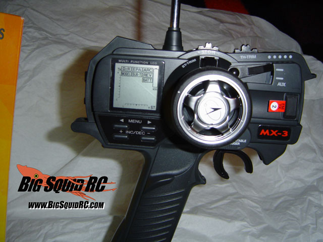

119503
there is a little slide out thing right where the arrow above is pointing the crystal will sit in, so just pull that straight out.
So, what your saying is I would need to pop open the transmitter and switch crystals when I want to switch vehicles?
Or you buy the same crystal for the second receiver, which is what I did. I don't recall having to "pop it open". Man, I can't remember. Though the crystal was exposed on the transmitter and you would just pull it out. Oh, it had a little cover over it:
That red tab above the trigger, pull the cap off and pull the crystal out.
Like I said though, back then, I only had a 2 or 3 vehicles, so I'd just buy the same crystal for both receivers.

Ah, that's where the crystal is! that's not too bad. I don't have that red tab though sticking out, the tag is inside with the crystal. Just assumed it was fixed inside somewhere when you mentioned.
But, I think it's probably easier to just use the same frequency in another receiver.

While your here... and you had one, what does the "inp-adj" thing do just forward of the trigger?
I see it's something to do with the throttle, but no idea what.
Doesn't ring a bell... but there was a screw. Can't remember if it adjusted trigger tension or trigger position. Probably position. You could adjust it to be 50/50 (forward/brake movement) or 70/30 (forward/brake) which allowed you to get more servo travel for applying throttle, but shortened the throw for brake. Some vehicles t/b geometry kind of needed more movement for throttle.
looking at the manual think that is exactly what that is, (top of page 1).
my old traxxas tq2/tq3 controllers (27mhz) had that, could only use it on a few escs i had because it would not allow far enough to trigger the esc to go to reverse. nitros though it was pretty nice, one of mine i seem to remember having to have a slight drag brake for there to be enough movement to get the brakes to engage enough.
