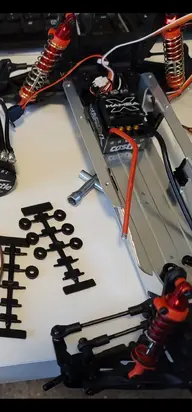

ESC won't fit where it's supposed to in the Ultima... can I put the battery on the radio plate and try to squeeze the ESC where the battery should go? It would be touching the radio plate

I can't see in that pic why it is not fitting. Can you take a couple more pics?
I'll have to take better pics after work. Here you might be able to see that it's too long to put like this because it doesn't clear the battery slot. If I put it lengthwise the chassis isn't wide enough. I can take off the ESC fan and put the esc under the radio plate but I'd still have to put it lengthwise and I'd still have the issue of it not fitting with the battery.
