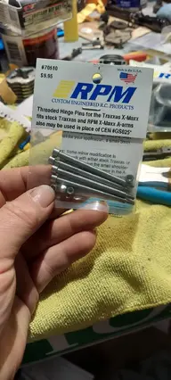

theres just certain thing like check diff fluid some come very low..and can rip gears apart along with auto flip... so should add more...Harden steel gears.. if doing speed runs or bombing across feilds.. RPM threaded hing pins. If jumping the sticks come out time to time from landings... if you have a ?? There is always answers in here.. hope you enjoy the X ma. 👍👍👍👍

3. Hinge pins, which ones?

Have you ever checked the diff fluid. When you got the truck? If not then check them.. sometimes the diffs come with low fluid. And which the diff gears will be destroyed.. I check mine every couple runs.. I also changed mine to 50 front and 50rear.. stock is 50front 30 rear.should be in you manual.. I completely tore my X down the day I got it screw for screw.. have you switch your gears from stock ones yet?? If not I highly recommend harden steel ones. The stock gears will strip if not meshed correctly... so will the steel but much harder to do water is ok not swimming in a lake. 🤣 but with the correct tires and gears it will drive on water.. this is my X skid . And shock covers the skid floats it's not against the center plate like other do like you mentioned.. the shock covers are from fullforcerc.com. and these are the hinge pins go in the holds lower arm to bulkhead and extra set of steel gears just in case I have.. along with a bunch of other stuff chassis slap is when the bottom of your truck slaps the ground when landing from a jump
