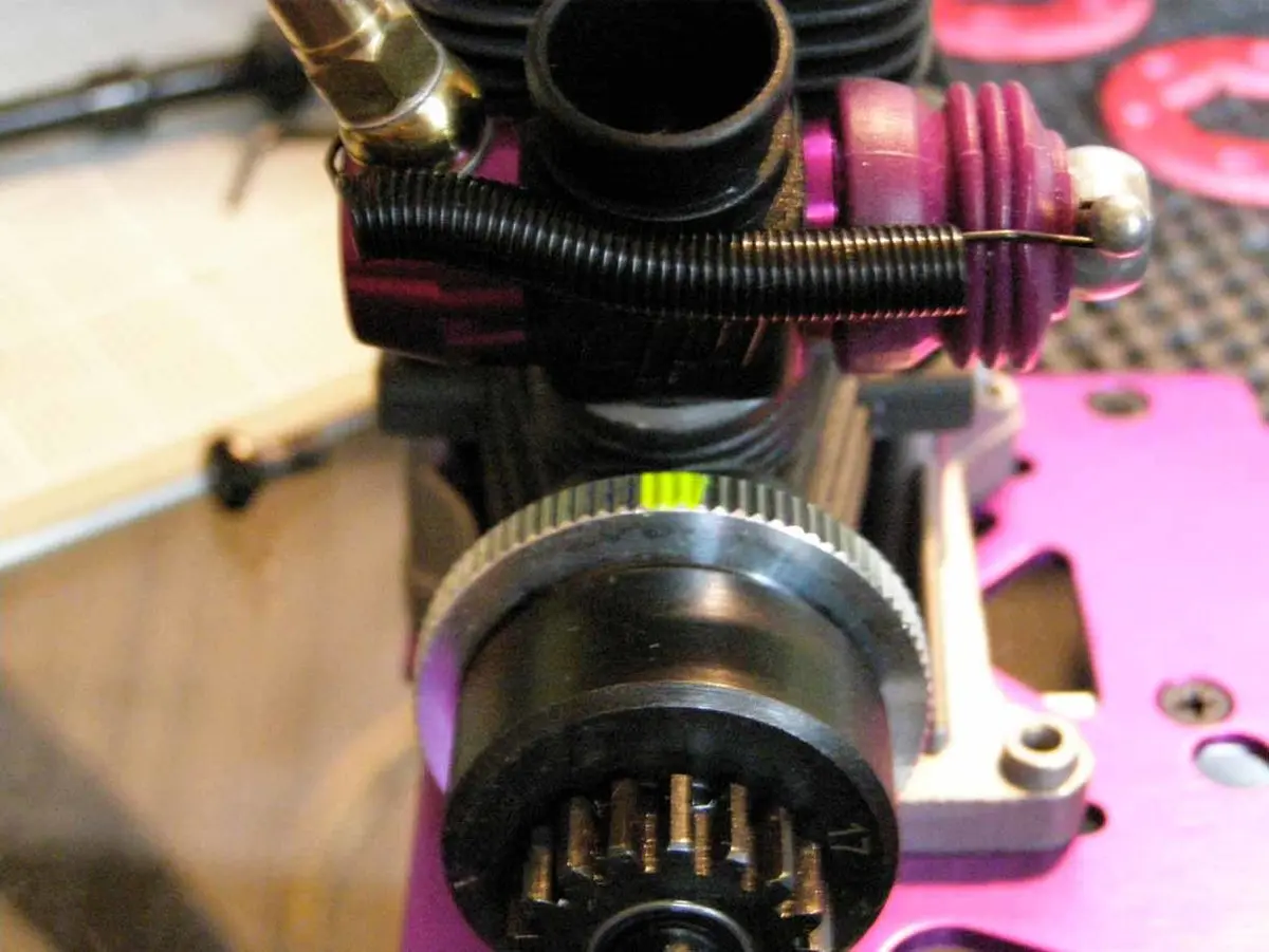

Must be throttle servo. A ghetto trick is to apply a compression spring on the servo arm to close the throttle as a fail safe, when not being pulled open. May put extra strain on the servo though.
Here's the throttle return on an HPI 4.6. Shouldn't be without one. More than just ghetto but a must back up system.

It depends on what the issue is. Pretty much every time I had a servo fail on me, it would always go full throttle instead of full brake, just bad luck I guess. Even with a TRS (throttle return spring), it wouldn't do any good because the servo would overpower it. The only time a TRS helps is if your servo loses power via the switch, bad wire, etc and on rare occasion for me, when the servo goes bad.
