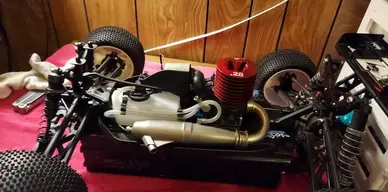

Ok so I just bought this new losi 8ight t rtr and I'm into my 8th tank and my servos are acting up..I'm bound to my spektrum dx4s. What's happening is, I trim out the steering/throttle and out of nowhere I have to retrim again, and the same goes for my throttle it's doing the same thing. Il be running with everything straight and then bam back to having to retrim.. could this be my radio, reviever, or factory stock servos.
Also when I bound this to my radio I didn't reset the model memory on the radio so could it be that it needs to be reset and rebound? Any help would be great! I just ordered a couple power hd servos and hope it fixes the issue..

After inspection I found the battery box and servo tray was loose and the steering servo was barely tight. 2 of the screws holding the servos were about to fall out. Rest radio and Rebound. Try again in the am.. but this throttle binding.. can anyone help?
RC..... I have the same truck and had similar problems with loose servo's right off the bat. Actually the two inboard screws on one of them (can't remember which one) were missing. Yes, checking everything on these RTR's is a must. Live and learn I guess!
From looking at your video, in addition to the loose servo, it seems like the shaft that the throttle linkage pivots on is lose too. Appears to be some side to side movement there. There is a nut on the bottom of that radio tray that will need tightened. You'll have to remove the 4 screws holding that tray to the chassis and pull it out to tighten. As far as the throttle binding, could it be the rubber piece making that squeaking noise when you apply the brake. That rubber piece, up under the rubber air filter inlet is compressing and squeaking.... possibly?? Trying to think of the simple stuff first. I just tried mine throttle/brake now and it makes a different sound, just like the servo is pulling hard. I can upload a video of mine for comparison if you'd like.
Yea that's what it's doing. When I pull.the break it kind of binds and the plastic piece that the linkage slides in seems tight. I thought maybe the angle of linkage but in.not sure.

Added a few things or changed a few things today..
Power hd r20 throttle servo
Power hd b4 steering servo
Pullstart delete
Can't wait to try it
Looking for battery suggestions for the starter box. It uses tamiya plugs and I'd like to get lipos for it if I could but not sure where to start
