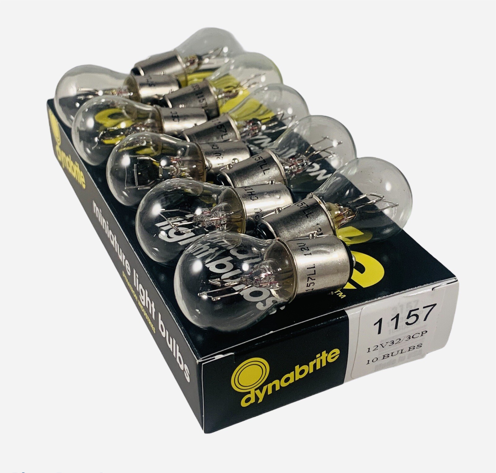

got access to a brake light bulb that isnt a led?. like a 1157 then measure its voltage...1 bulb both elements is like 5 amps.

They may be "old school", but auto bulbs (1157) are still a great way to quickly discharge a pack. Using a LiPo low voltage alarm to easily see when to stop.

Yea you can build a light bulb discharger. Like above. They work good. I got a venom charger as well.. But I have the Venom quad charger/ discharge. And also picked up a hitec X2 charger for the IR rating of the lipos...
