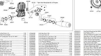

ok so i got 2 of these...
NEW RC Gear Shop Duratrax .18 Side Exhaust Racing Engine RGZG1018
i was getting the clutches switched over and the hpi is good but i need mounts so it can adapt to it. the losi i need a new larger bore washer and compression adapter for the clutch to sit properly on the shaft? any ideas where i can fine these?
i looked it up its called the collet. but i need to know is the bore gonna fit in this new motor. the shaft is a little larger than theild engine it was on. it came off picco .15 and wont fit on the new.
the part i need is losa9376 but idk if the stock one is the correct bore to fit on the mew motor
