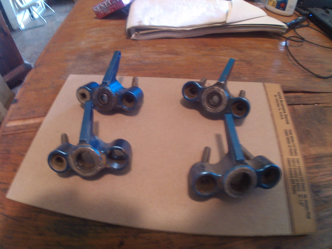

I have had & been using these aluminum knuckles because the originals keep breaking
at the horn on heavy bashing ,but they eat the bearings up ,I had already went through
2 sets of bearings both fronts an rears!
I can't figure out why ,the bearing fit nice an tight an have to be pressed in.
Does any body think that the fitment of the bearing maybe too tight messing up the bearings?
I see other people using aluminum carriers an they don't seem to have that issue!

I did take my dremel tool an reamed the aluminum ones out a little last night so the fitment is
not too tight ,the bearings fit snug an come out a little easier!...:cool:

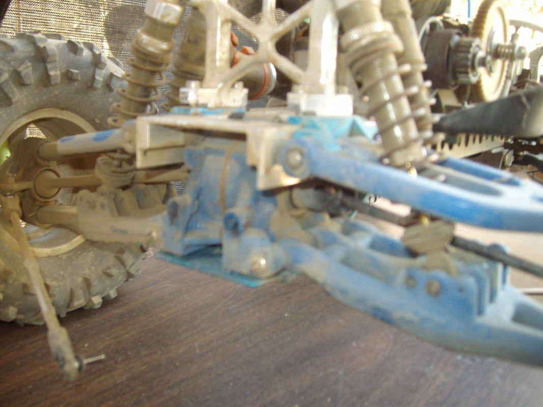

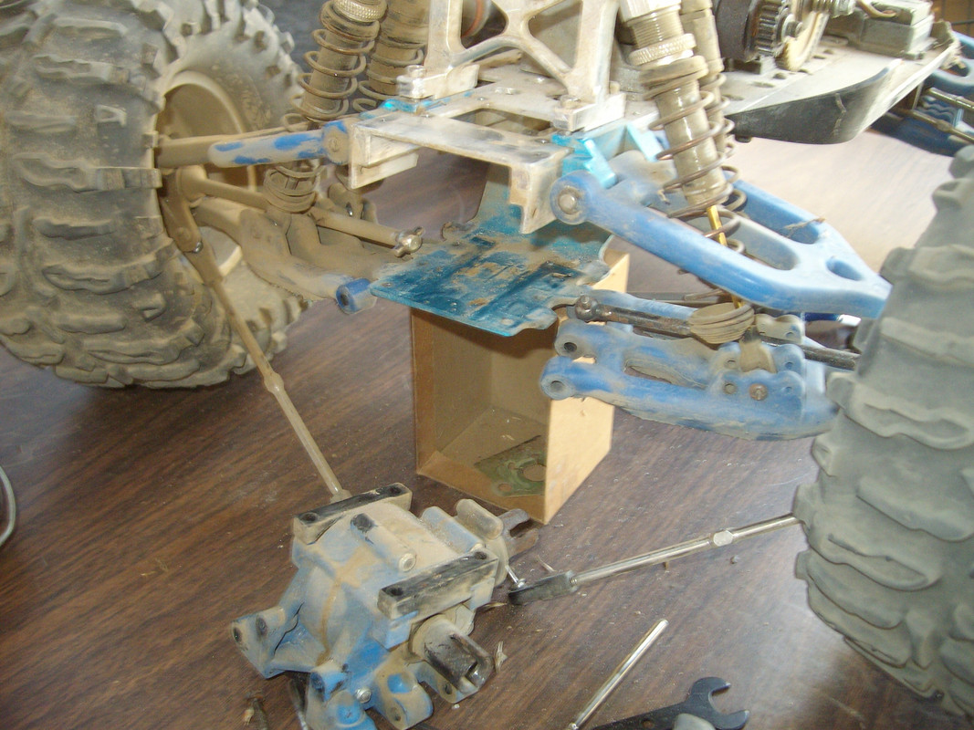

Here is some pics of the mgt. when I replaced the rear diff. ,it was only because the bearing wore out at
the cup shaft ,I just changed the hole diff. ,because a few years back ,I had turned it into posi-trac an dont
want that in there anymore!

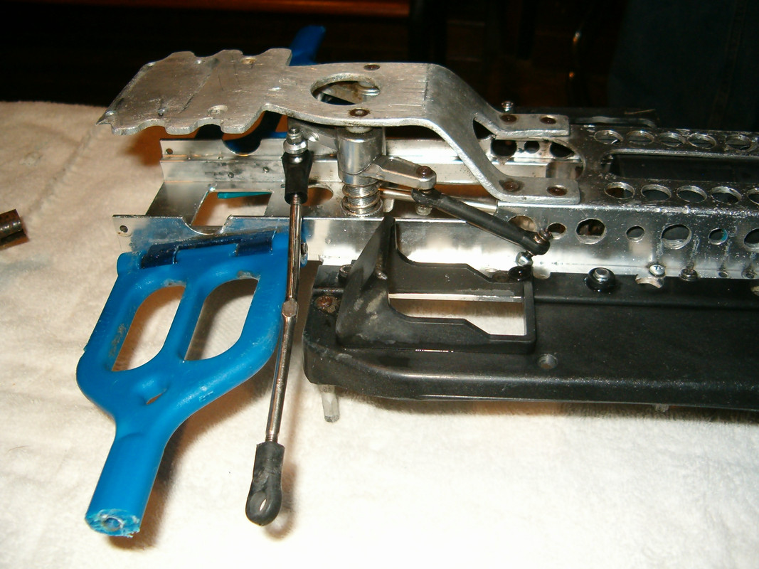

I think that I remember why I put this off ,further looking into my photos ,I see other issues that needed addressed ,
here is another issue ,a bent hinge pin mount!

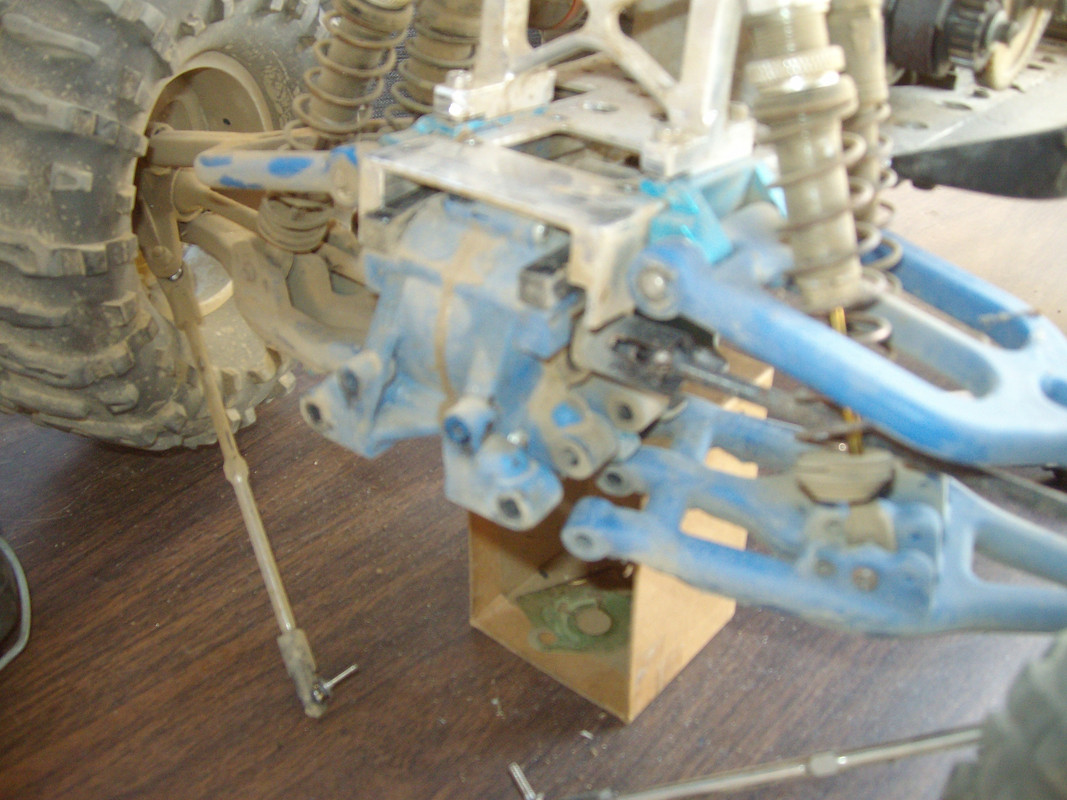

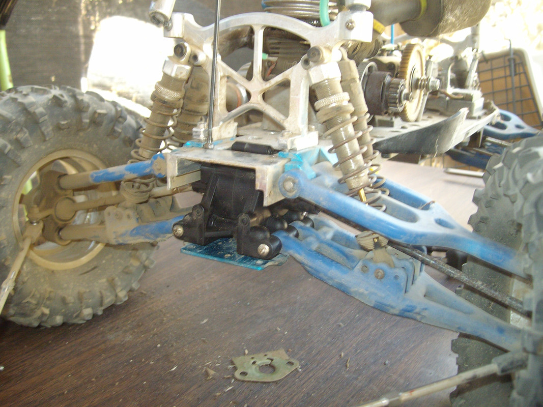

An here is one of the issues ,but like I said ,this only happens on a very hard hit ,more than likely ,when I
hit the curb ,or a bad endo ,in which that I am very good at!....LOL
This does pinch the suspension off!

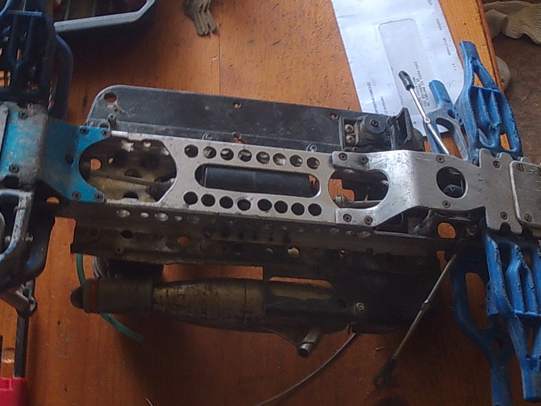

I think ,that I will go ahead an fab up a rear skid plate to match the front one that I did while I have
the diff out!

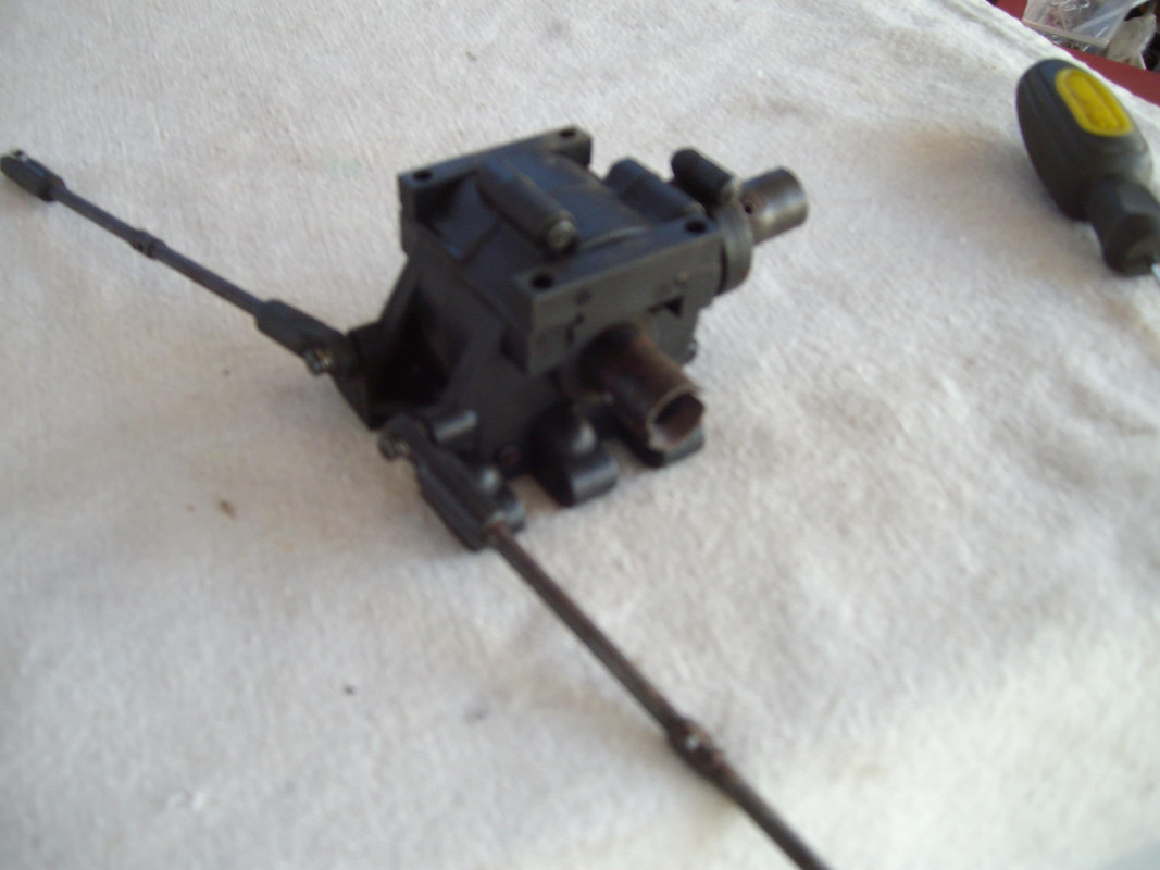

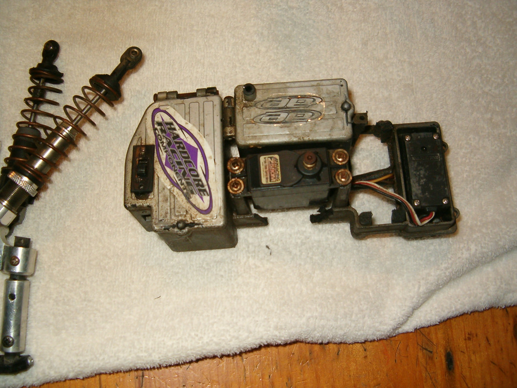

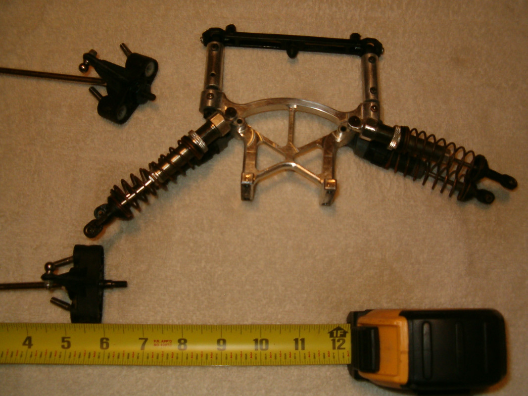

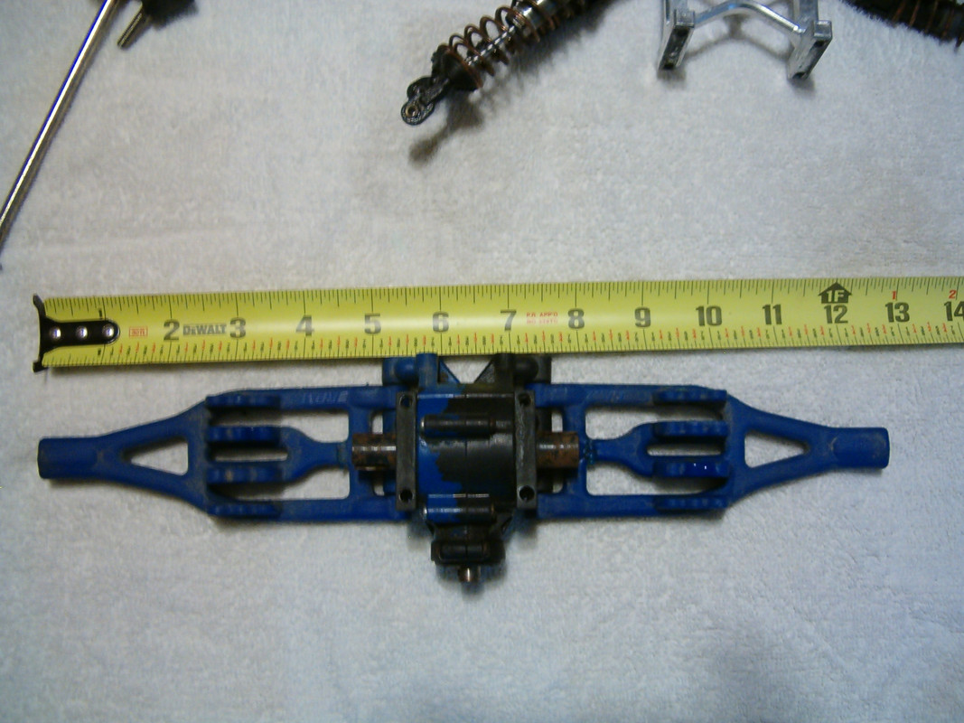

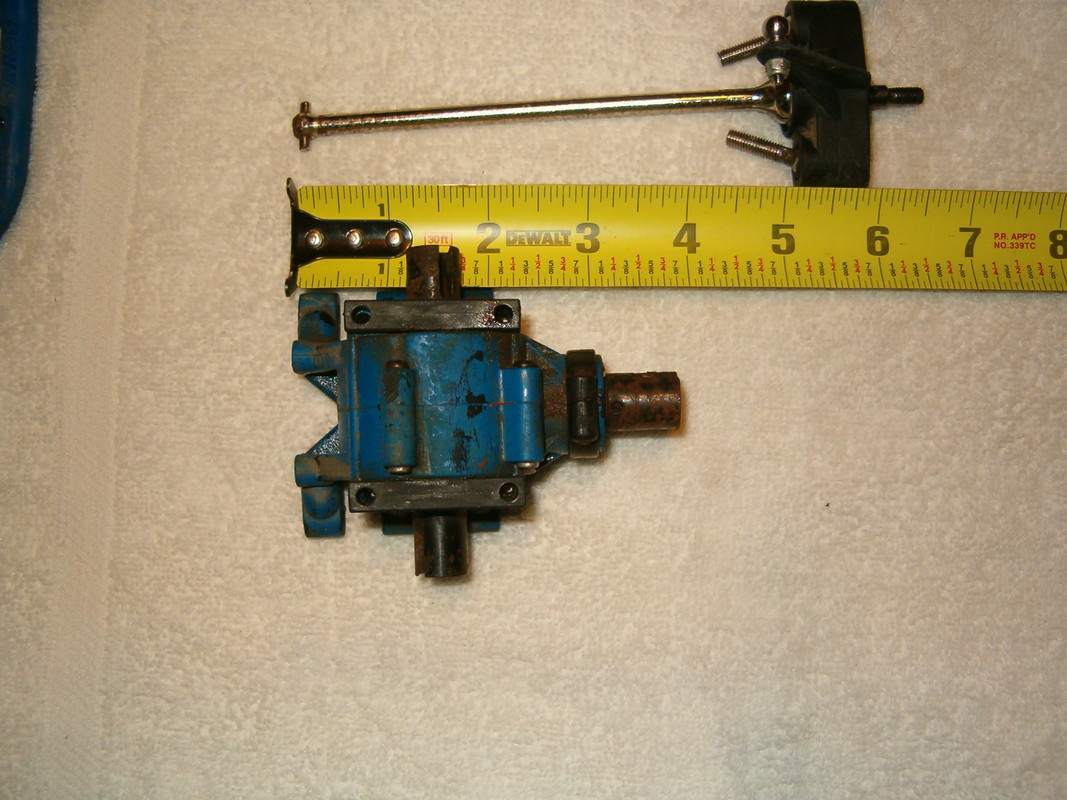

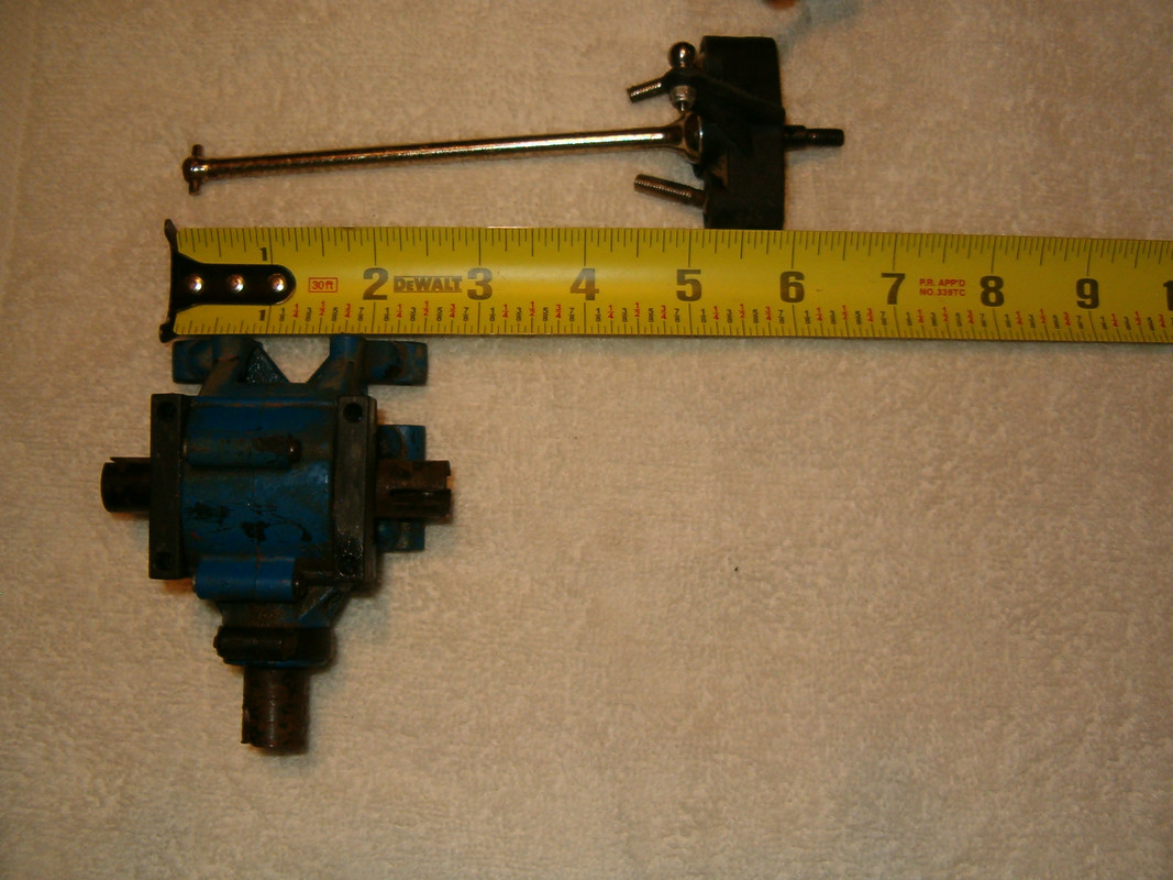

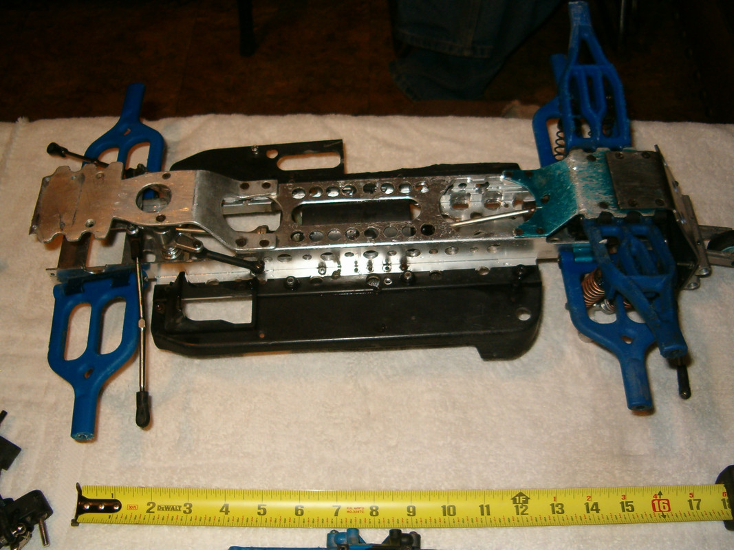

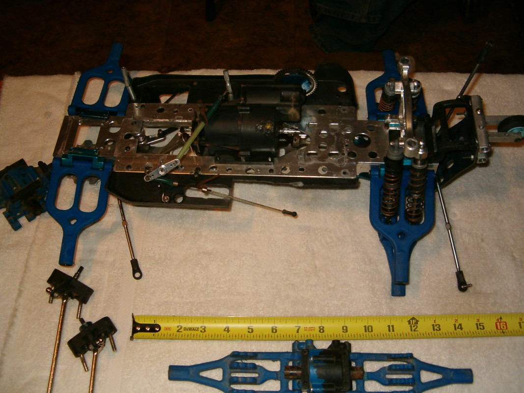

Took some pics as I get my parts out an clean so I can start putting it back together!
I am also putting a tape measure to the parts so that people can get an idea of the parts size.
The diffs are pretty meaty an are a good solid diff ,never had problems with them from factory ,
they haven't been shimmed!
The axles are put out by MIP. ,they ARE NOT their average size ,they are the MIP super duty ,an are rare!
Shock towers is Hardcore!

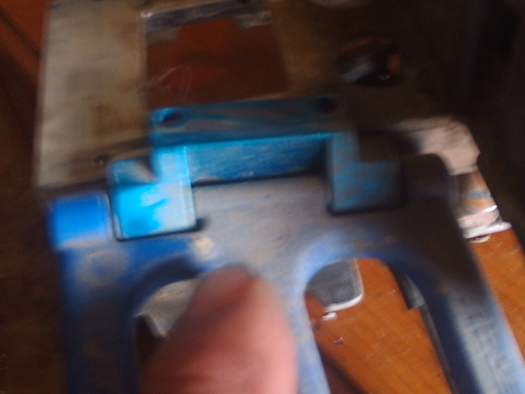

I just got the chassy cleaned up ,can really tell how one or two of the a-arms are pinched an don't move freely!
I have new top hinge pin mounts ,it is the mount that is bent ,I remember one time trying to bend one back ,its
hard ,they are loose ,this would be a good place to put some Loc-tite!
Oh ,the tie rods are Lunsford ,steering rack is either Lunsford or Hardcore ,can't remember!
An notice ,my front skid is thicker ,billet not titanium ,it is softer ,but thicker!
Rear bumper is Hardcore titanium ,there was a top piece on there ,but I manage to snap it
off on a bad landing ,titanium is a more stiffer aluminum ,so it will snap!
Center shafts are MIP!

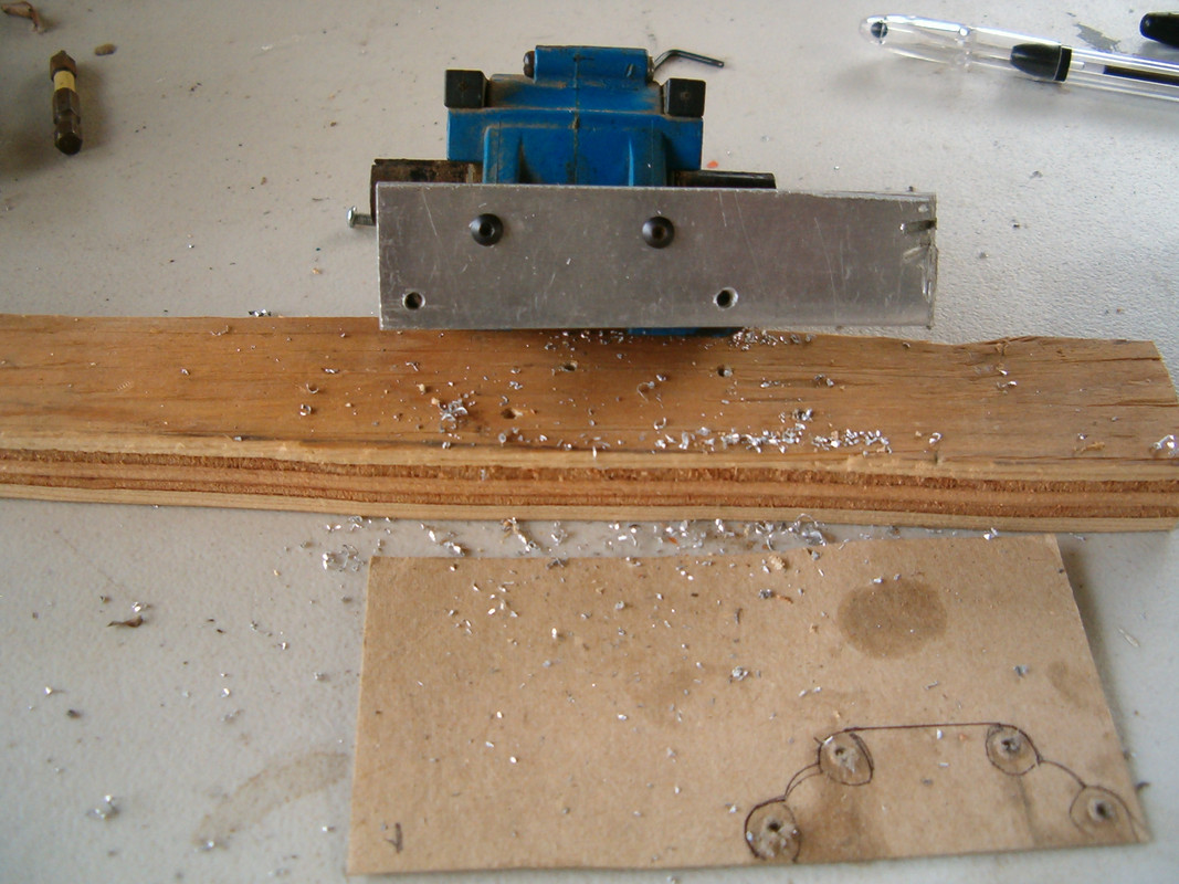

A member here had peaked my interest in a diff. hinge pin mod!
The lower a-arm hinge mount is molded to the diff in which is prone to break or the pin to blow out
sometimes on an awkward hit ,in which I had it happen to me twice ,once in the front an one time
in the rear from a nasty hill cart wheel.

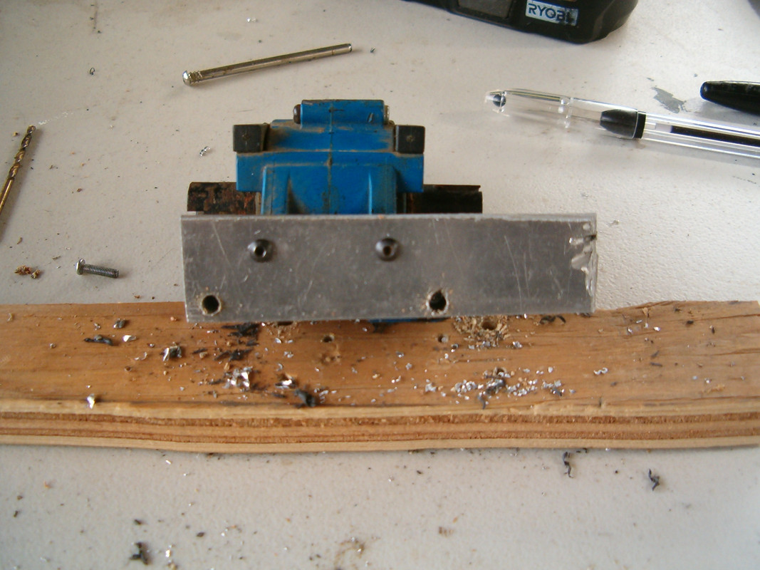

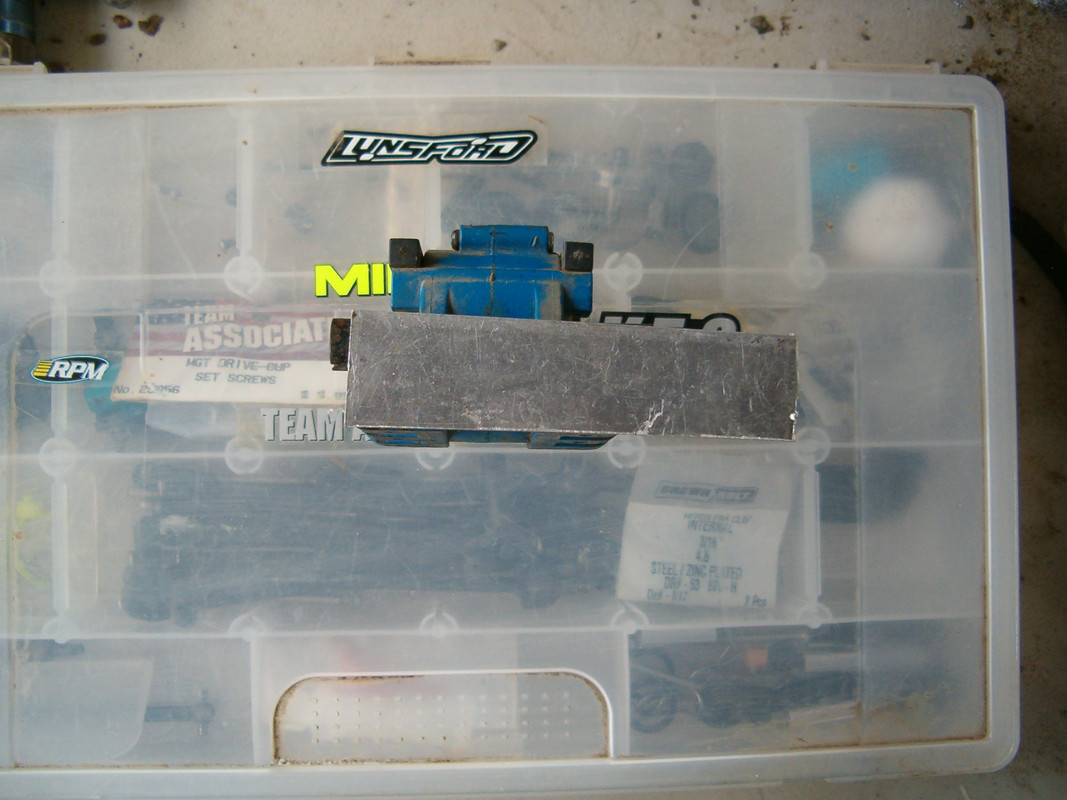

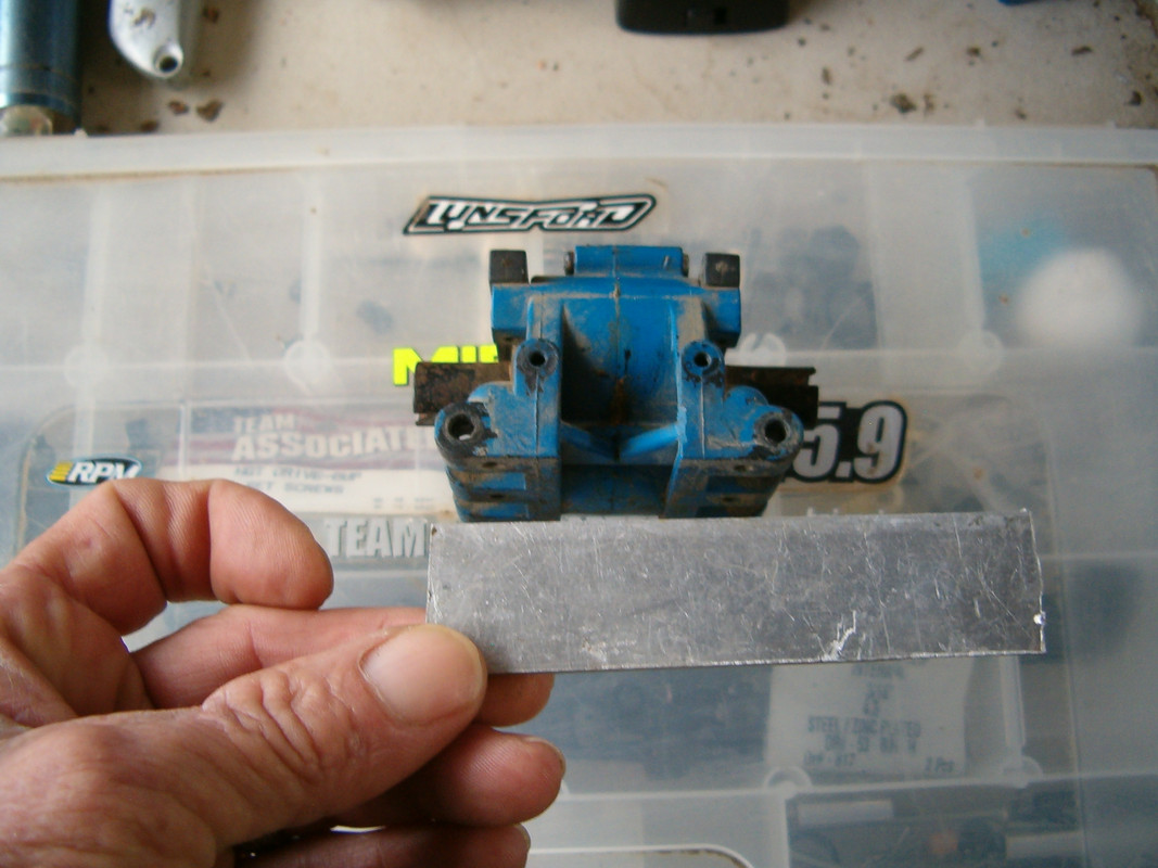

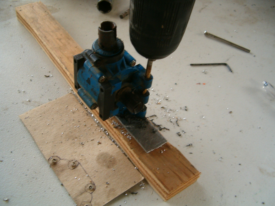

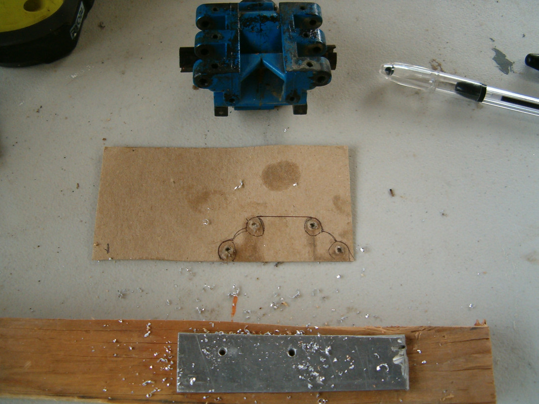

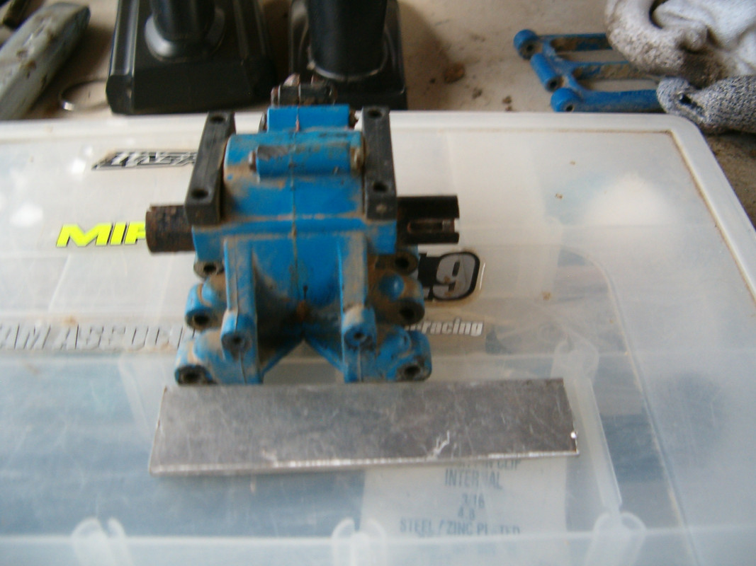

I came up with this idea!
It will stabilize both sides together an not allow them to blow outward on an impact ,may not be
bullet proof ,but should give it more strength an help!
There is two screw holes there ,the diffs are front or rear ,the 2 screw holes isn't used for the front ,
they are for the rear tie rods ,so they can be used to screw the aluminum plating in place ,an drill the
hole out for the pin!
Here is a pic!
Thnx to ,https://www.rctalk.com/forum/members/d3mon.41706/

LOL....By you asking me that ? ,you just made me think of another idea!
I do have a bunch of the original screw in hinge pins ,but I am not using those types ,I have the Lunsford
titanium hinge pins which don't screw in ,they have the little e-clip on the ends!
I will probably have to put the original screw one in ,the aluminum is 1/8'' thick!
ok , I just figured it out ,I will use a top pin ,they are almost a 1/4'' longer than the bottoms ,the
pin itself screws into the a-arm an the pin hinges with the a-arm ,I think that this was what you were saying ,
how am I going to do it!
I can thread the aluminum ,in which is easy because it is soft ,or I can make my own hinge pin an use the
e-clip method ,a small groove can be cut into the shaft for the e-clip with the Dremel tool!
I have both toolings ,Dremel & tap & die set!...:cool:
