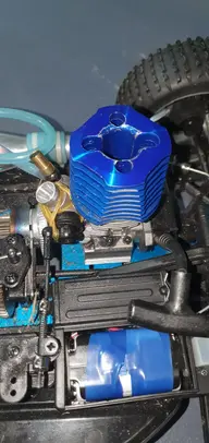

if possible try taking a pic of the engine, i am going to assume its an SH18, but i dont want to say that and it be a VX18.
should say on the side of the engine, if not on the top.
