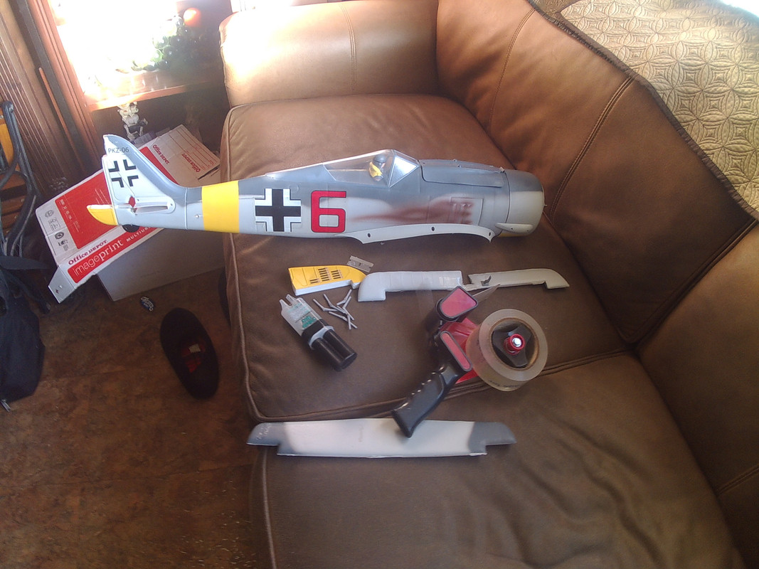

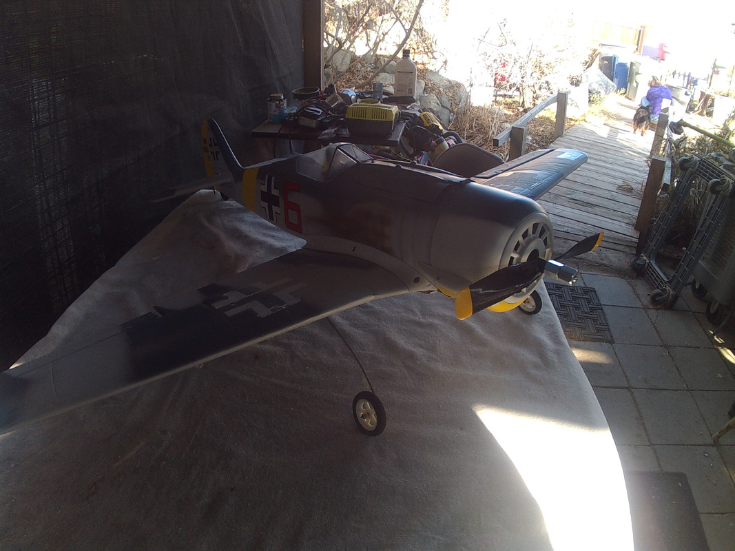

In my foamy days ,I used 5 & 30 min apoxy that you can get at Walmart or hardware store ,an believe me ,you will need
it on the parts that break on crashes ,clear packing tape is good to wrap wings ,it make the wing more stronger!

Why use glue when you can TAPE?!?!
Foamies is not new to the RC world ,folks also had nitro fueled engine planes like the Cox Ez Bee ,my friend had that an wrapped
his in clear tape ,not only did it add strength to the wings ,it also made the foam more fuel proof!
The tape wasn't used to tape parts together ,it was used to add durability to the plane!
