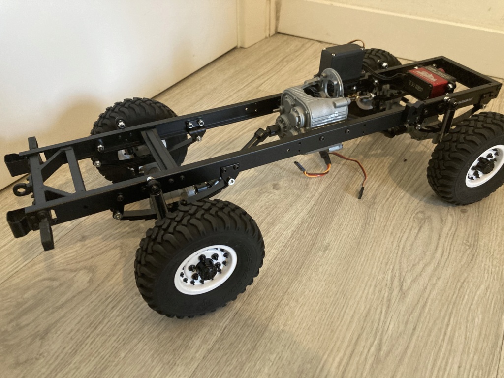

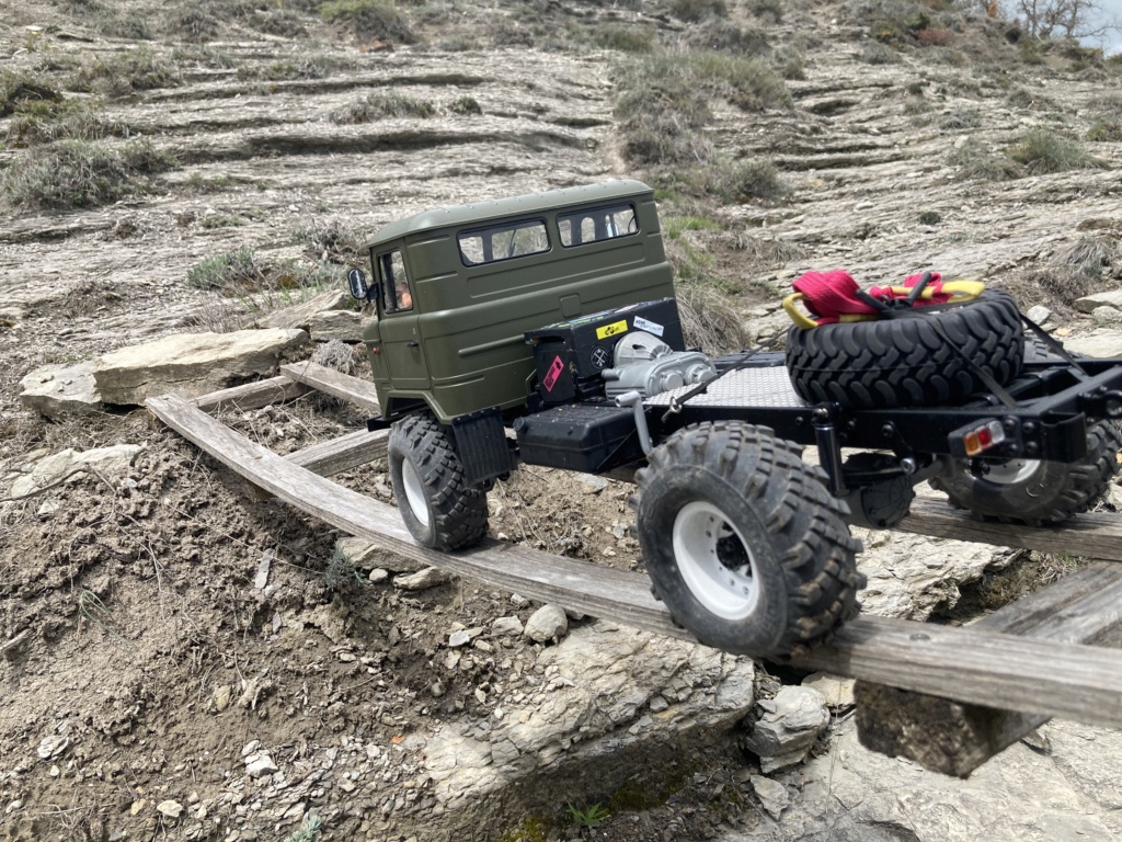

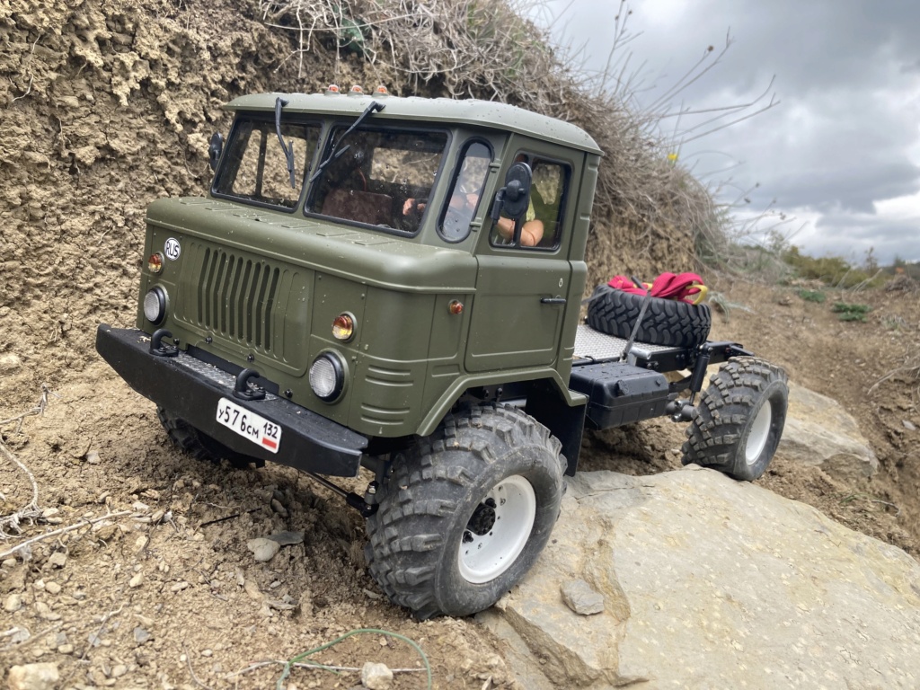

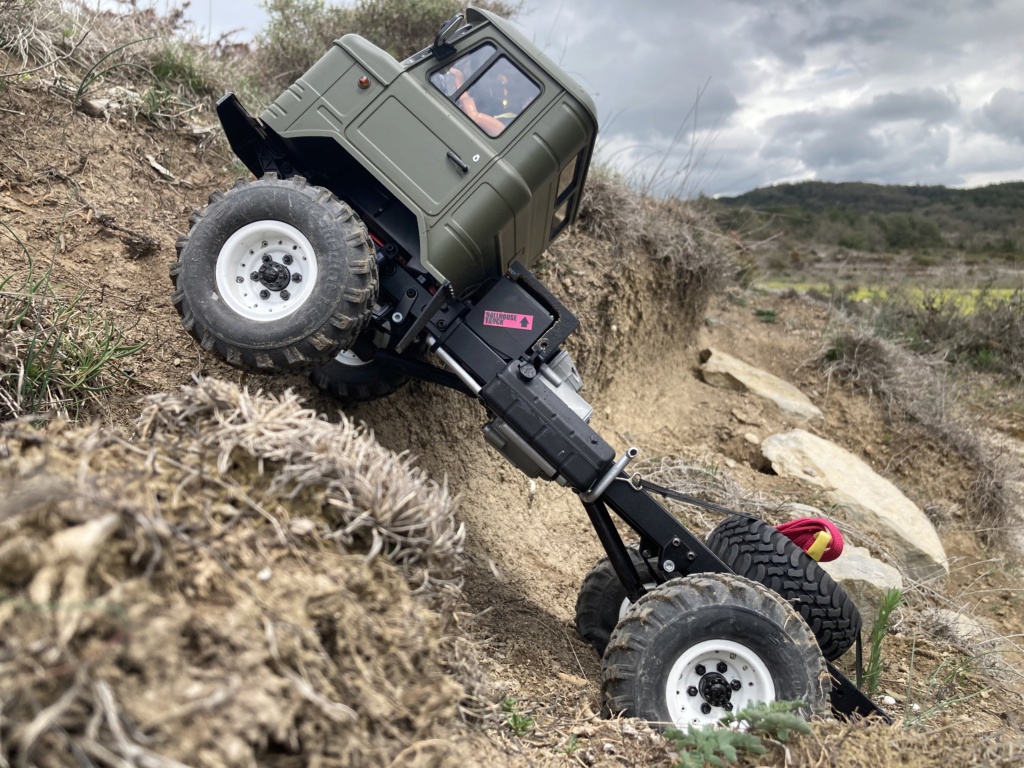

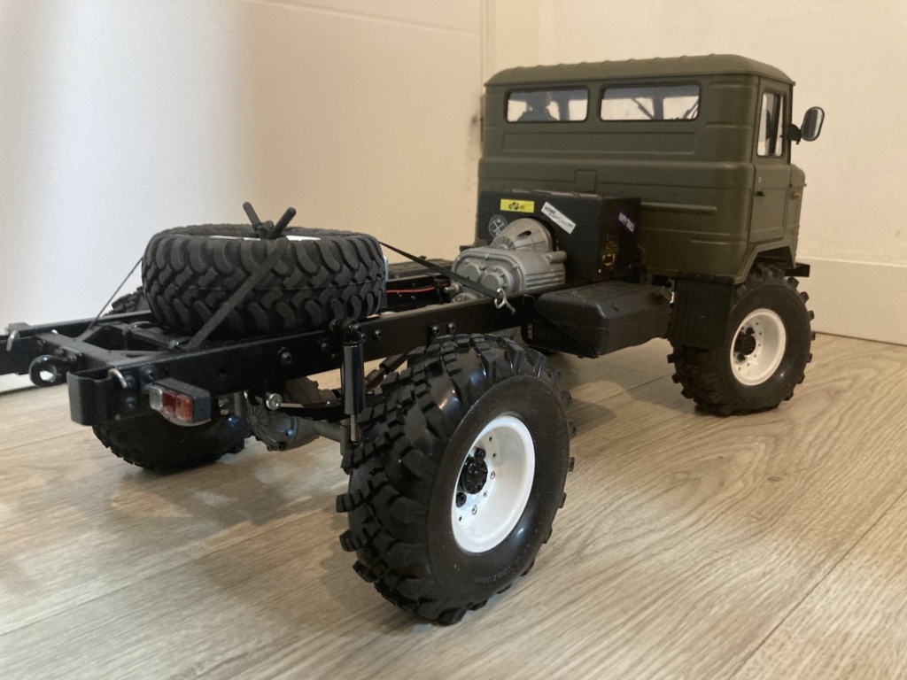

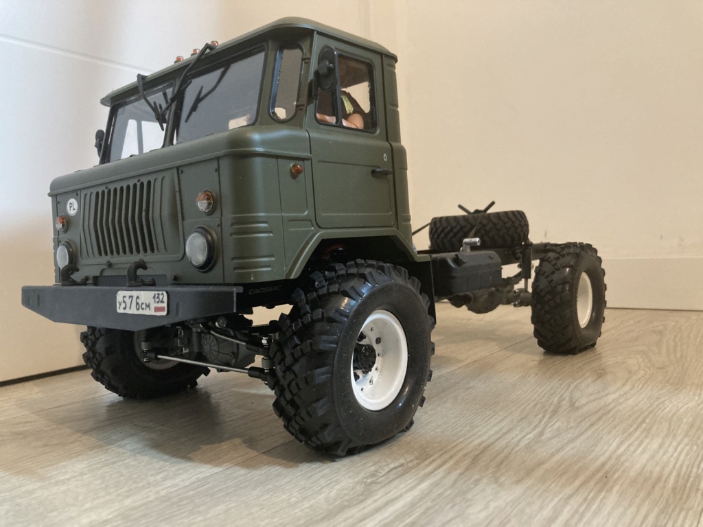

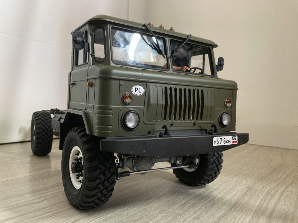

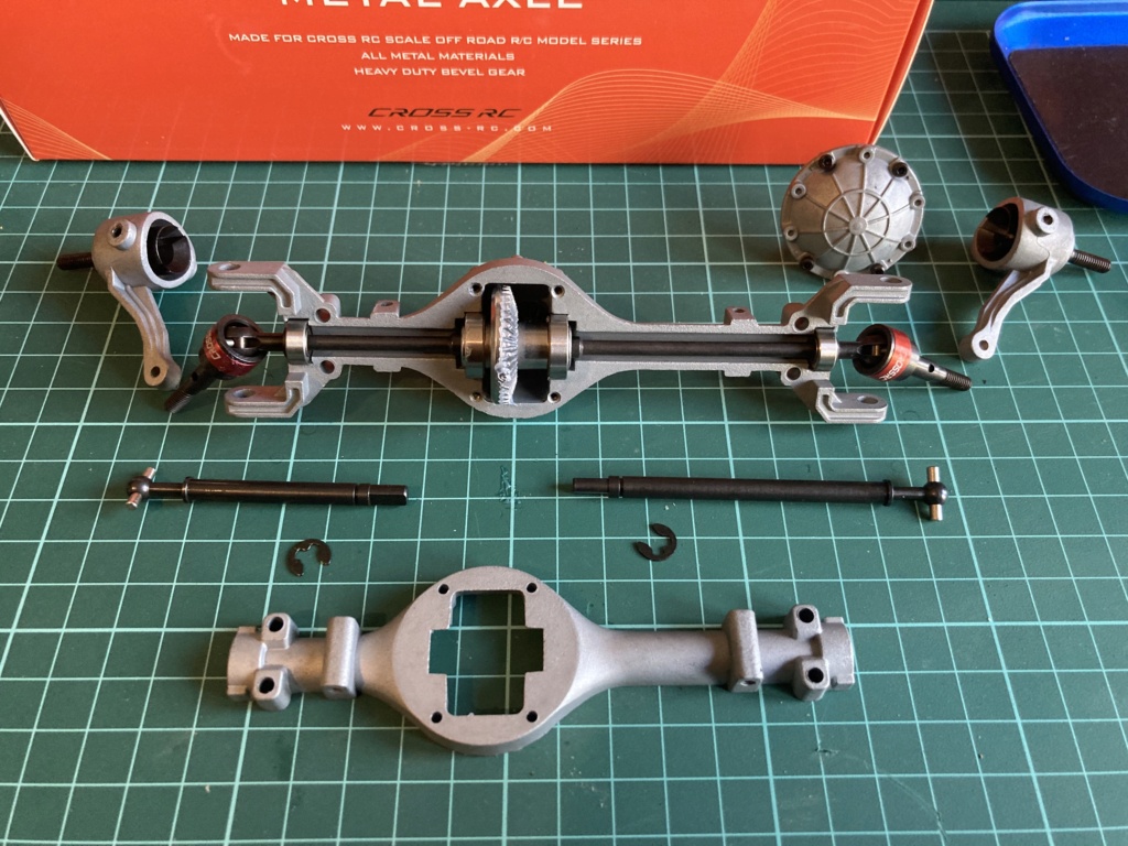

Well, after selling the Kingkong, which I loved and was hard as hell, but did not meet what I expected of it, I have on the way a Rc-Cross, I wanted this brand and as the 8x8, although I have fallen in love, I have gone out of price for my pocket hehehehehehe, I took a GC4, I have always liked the aesthetic "Russian" and will continue in the same line as the kingkong, but with an axle less to be something more "practical" for crawling.

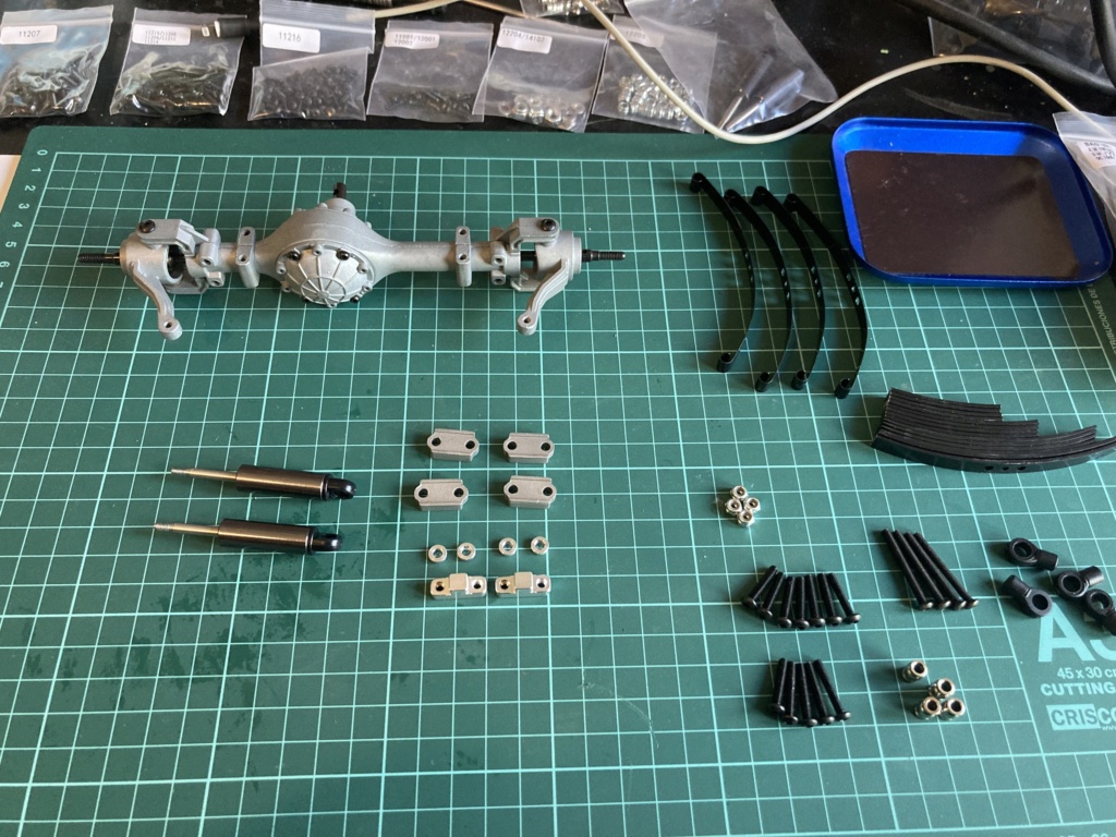

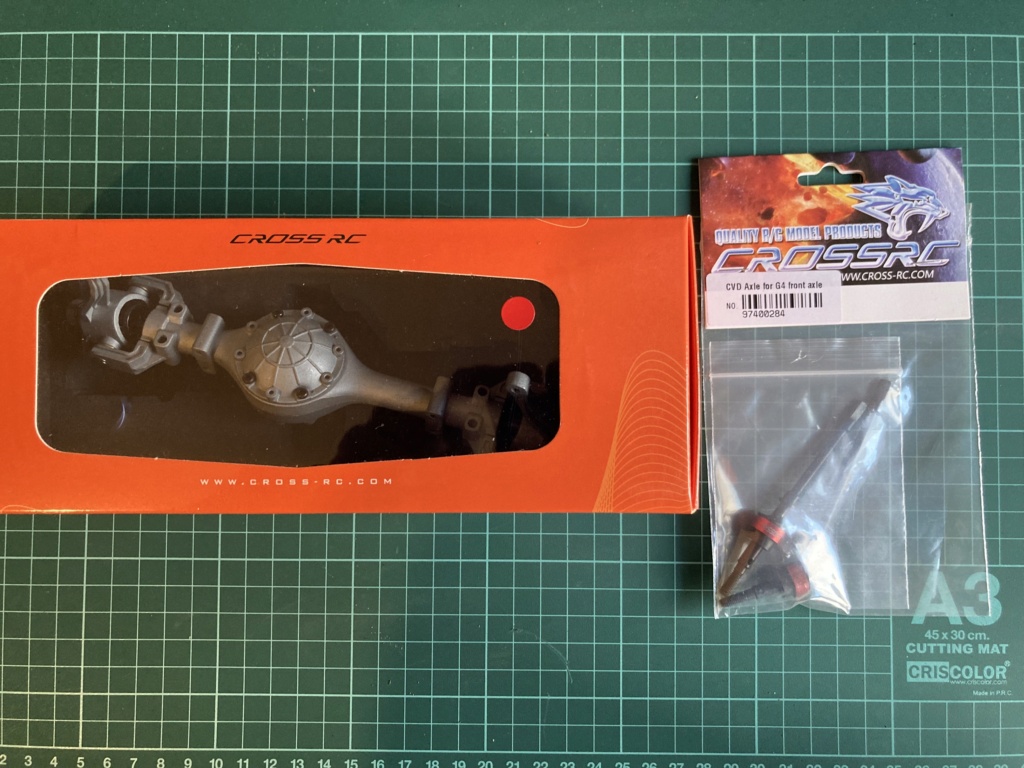

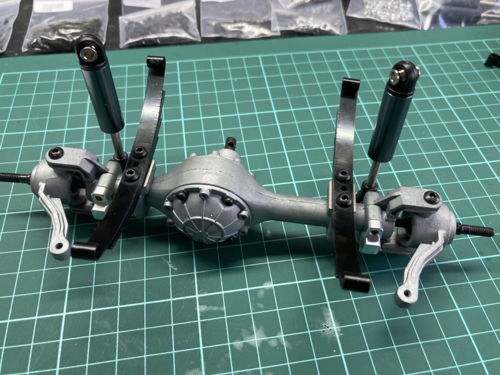

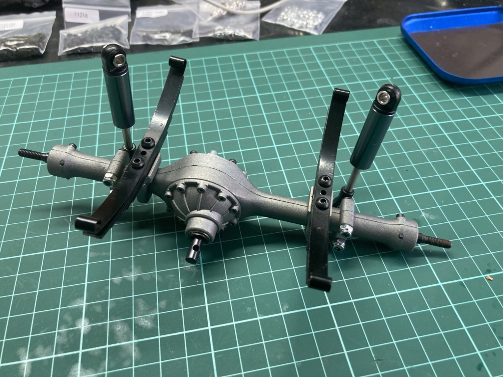

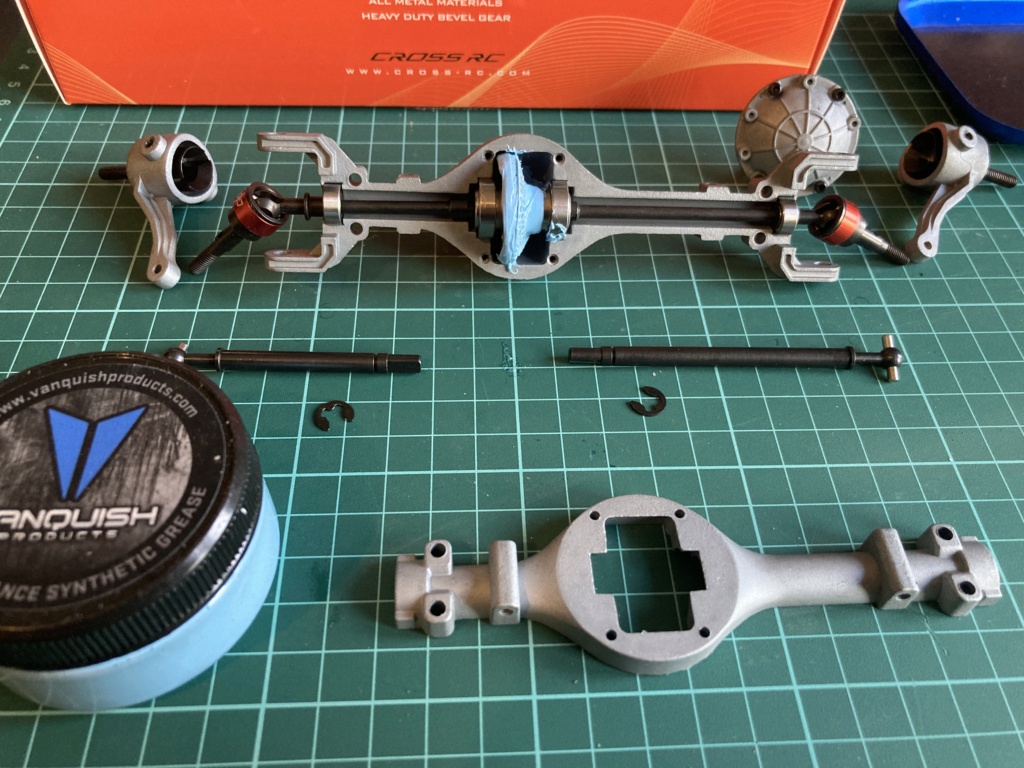

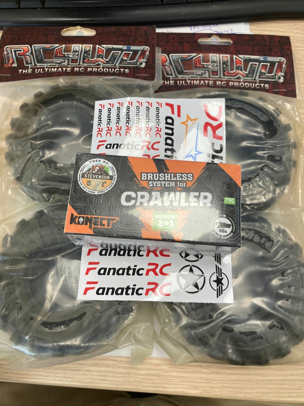

I have the truck on the way home, along with the CVD bearings and the kit of metal sprockets, that maybe the truck already includes I've seen later in some Youtube video hehehe so maybe I have to keep them as spare parts.

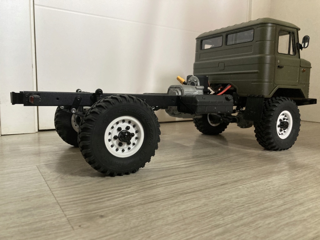

Servo I will mount a MOB that I remove from the Pajero that I have for sale and I was not going to give it with the Servo as I can not sell it even for 300 € ... I do not understand why but well . Motor mount a 1200kv Fusion to save space variator and gearbox servo, put any I have at home hehehehehehehej, paint I have two sprays of Tamiya ts-5 so we will have to take advantage of them, on the other hand, at some point I will order a rubber rc4wd flahspoint as not, more in line with the model in question.
Ordered on Friday at 10 in the morning from Lili modellbau in Germany, received today Tuesday at 9:45 in Spain... that's speed, not even ordering in stores in my own country takes so little...
Work starts
Another things
Waiting more parts

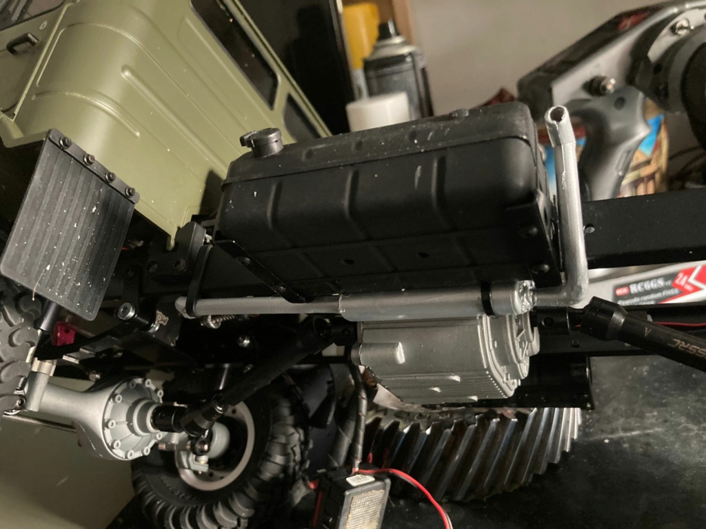

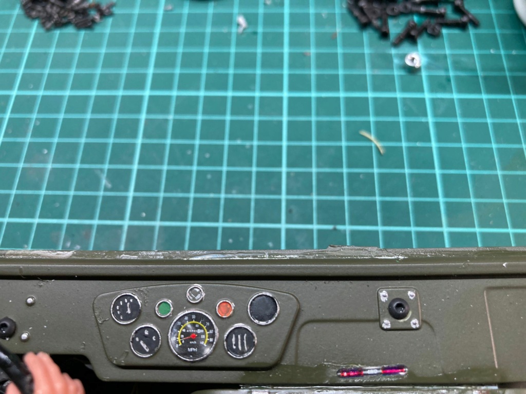

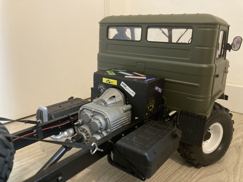

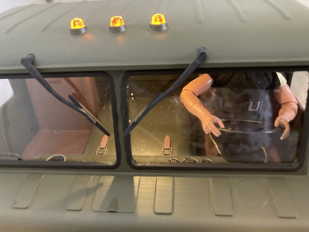

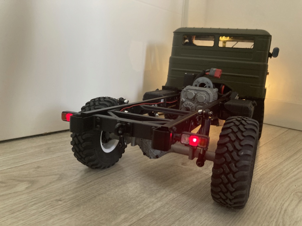

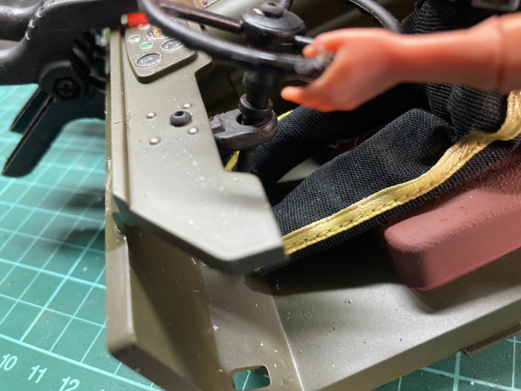

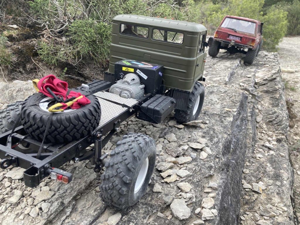

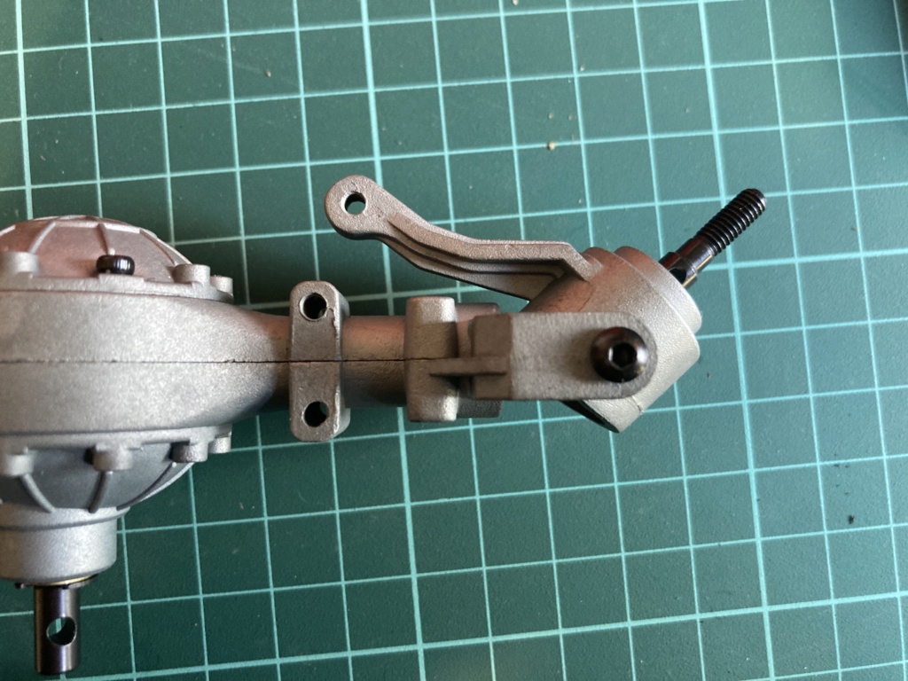

It has been necessary to reinforce things a bit, as in the King Kong, in the Cross the bodies are beautiful, but a lot of pieces are glued instead of screwed, which makes them delicate, for now, I have reinforced the steering wheel to its axis and the axis to the dashboard and turn the dashboard to the lower half of the body, now yes, this is not going to move
I have also made an exhaust, the typical one with a lighter and plastic to give it the curves, I have used the plastic that comes holding the pieces in the kit. I have also raised the deposits a little, of the two holes I put the lower one where the upper one goes and I made some new holes in the supports for the lower ones, so I have raised them about 10-12mm, I did not measure since the measurements were given by the holes so I don't know exactly.
That is a store that works as God intended, 3 days from Spain to France ... not even stores in Spain take that long anymore

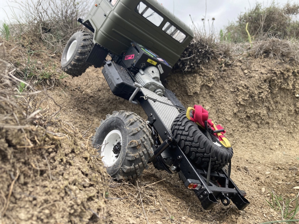

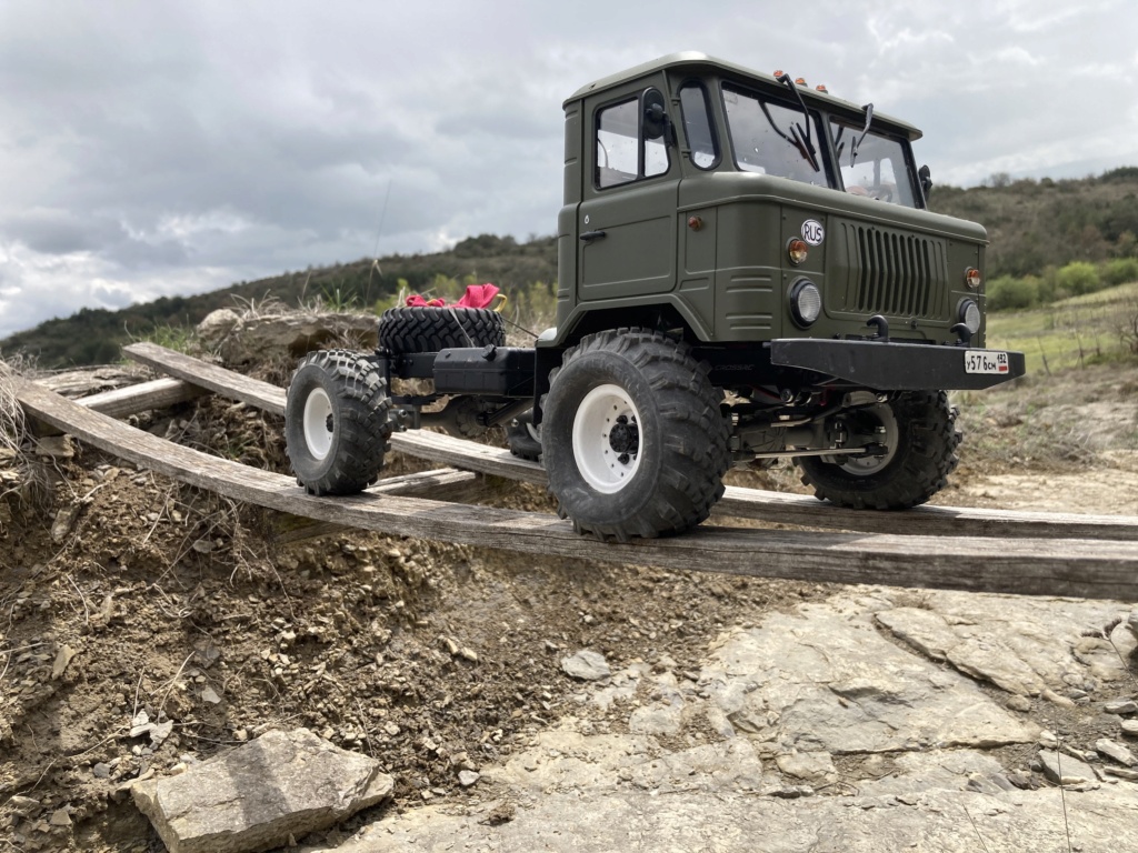

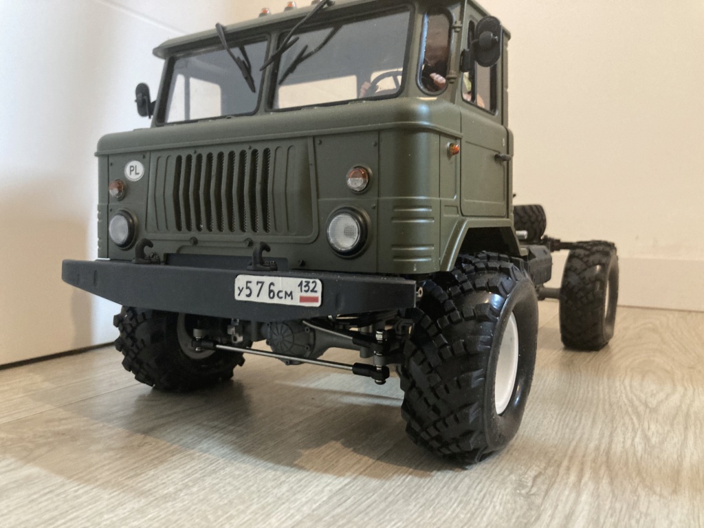

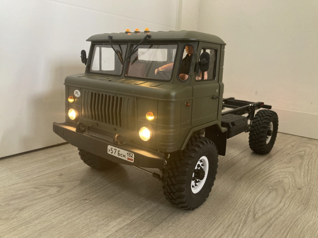

I'm liking how it's looking, now it's time to fight with the servo of the change and the lights that do the functions well
Love you build man. Looks great.
Aww, you call him build man 🥰😘🤣😜
Yeah, these builds are just ridiculously cool. So much detail. The tire hold down and straps are a very cool touch.

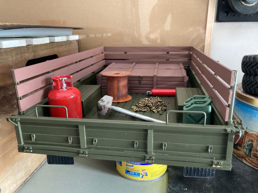

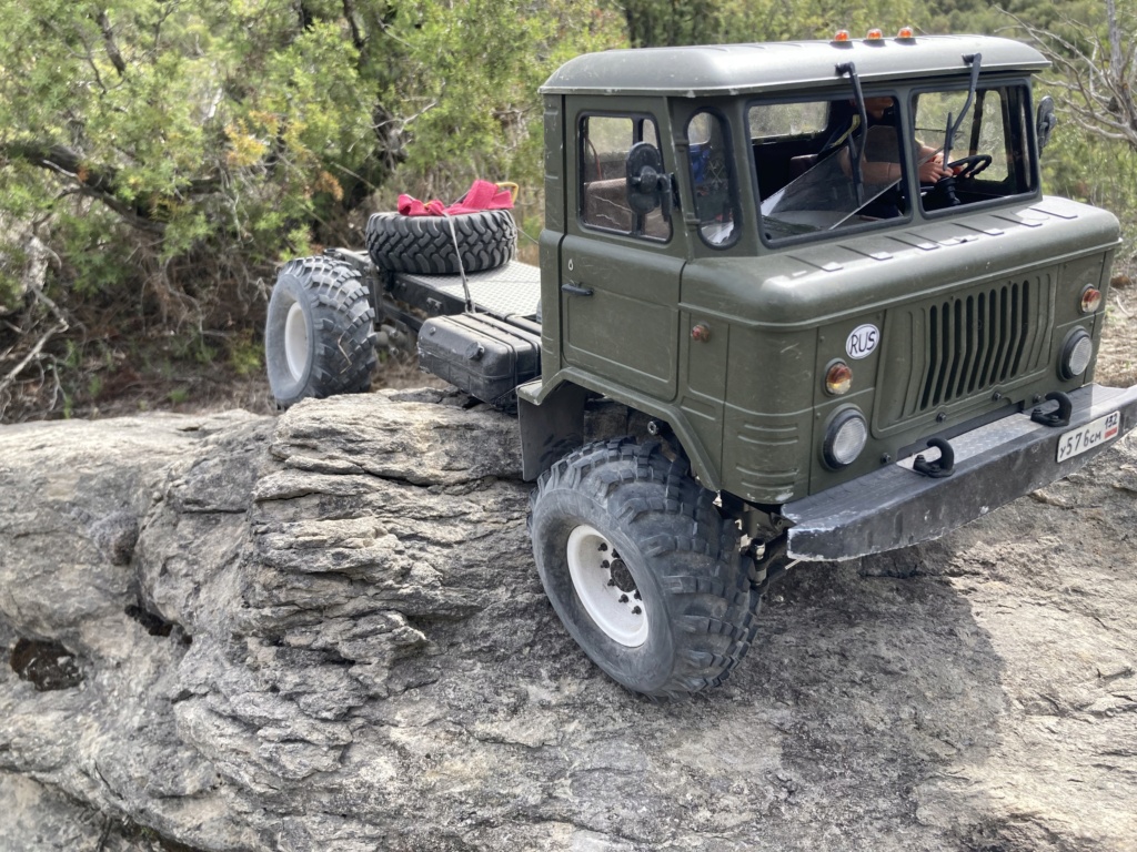

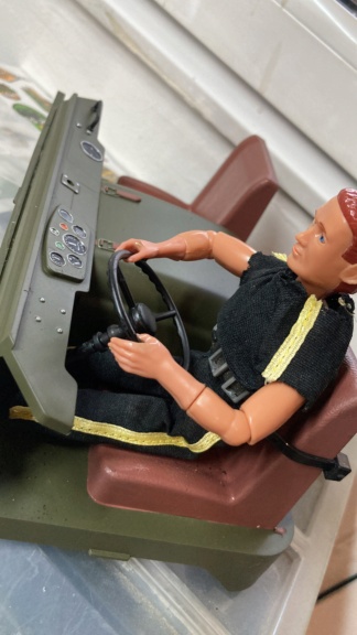

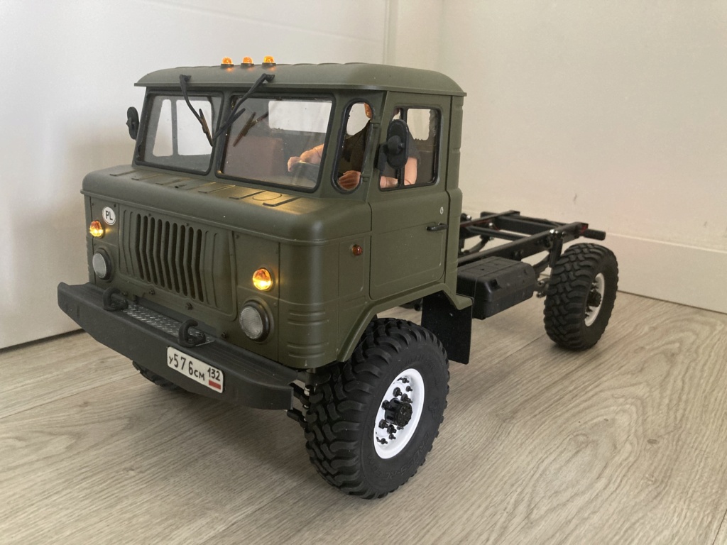

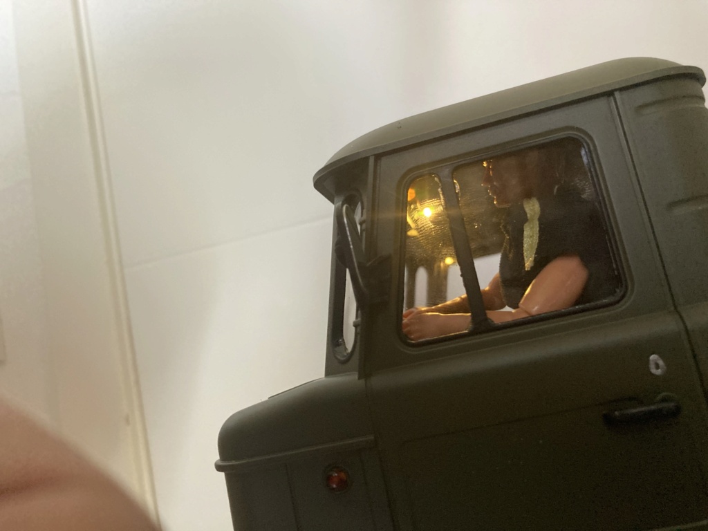

Cross RC has some great detail. Really good looking rig. Is you driver a Madelman figure? Looking forward to seeing more.
Yes , its a madelman , maybe too big for this truck , for the moment dont have other haha
Madelman was never sold in the USA, I have some I ordered from Spain about ten years ago, when I used tp collect action figures. Thought he looked familiar. :)

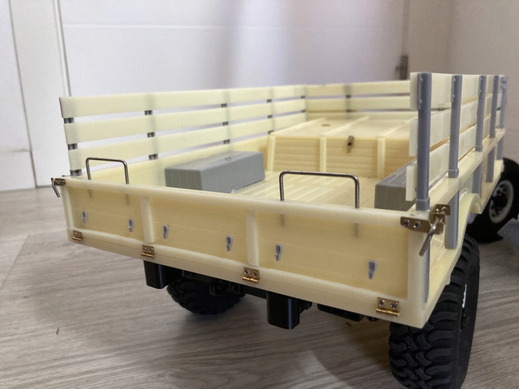

Second option near finish
