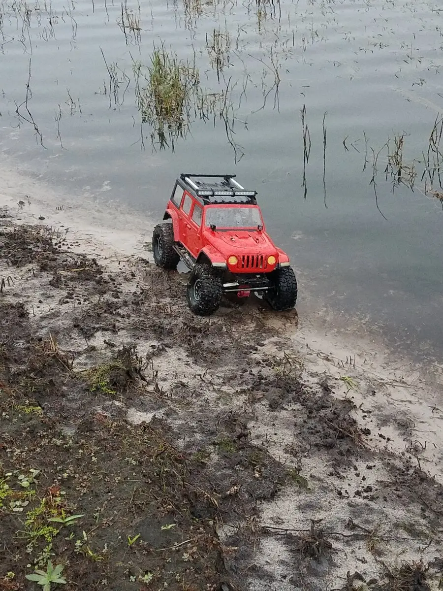

Been in mud and standing and running water.

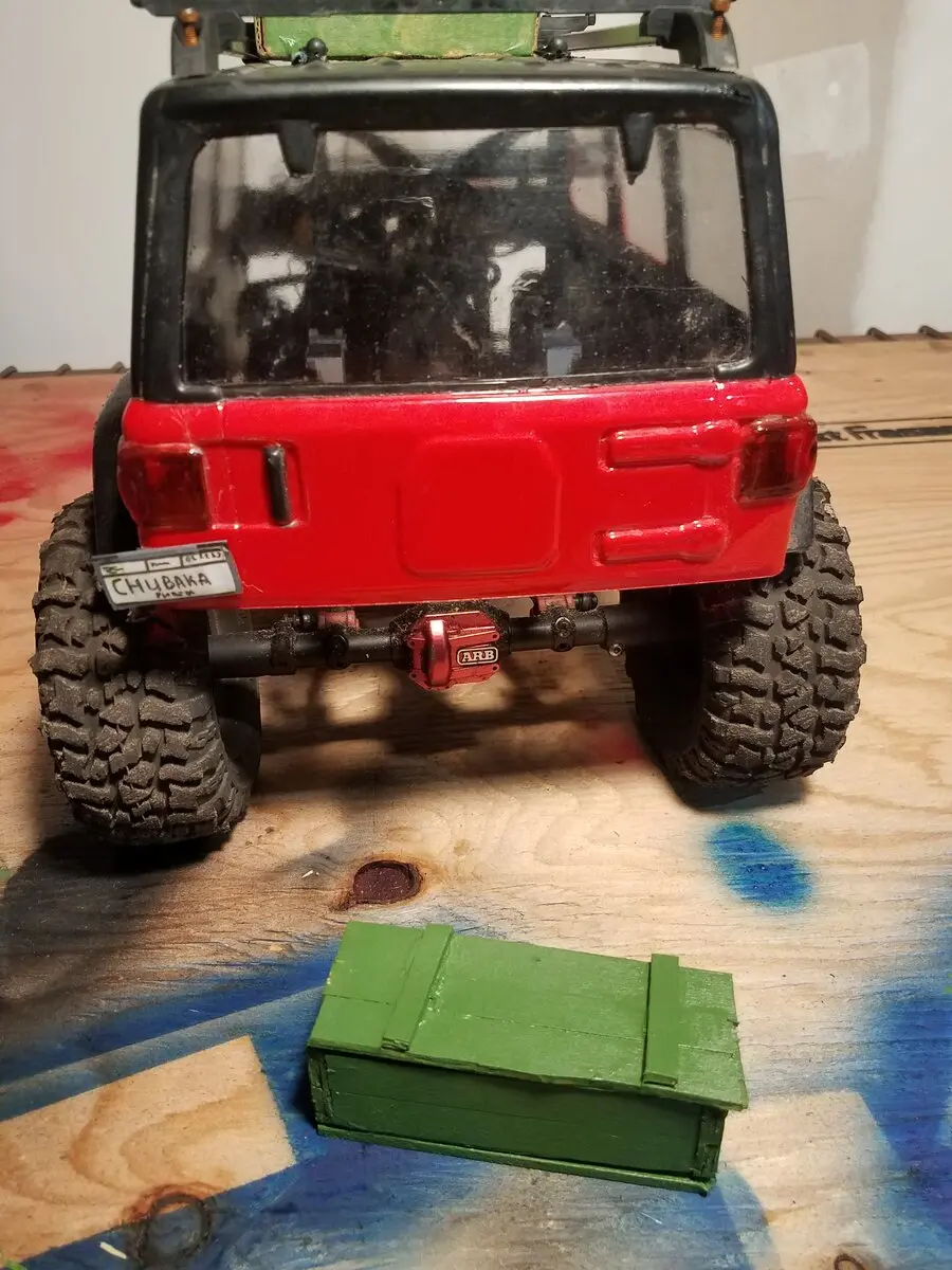

The cardboard box is now green. In it is spare parts and some basic tools.

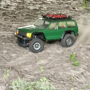

Took her out for a spin. It appears I have the issued copperhead 10. Mine hit lvc after 45 minutes to an hour. Factory 10.2 with ax10 tranny on a 21 tooth pinion and a 2080kv. There was momemts I had to drive reverse as it was the only working option. If you get it to go forward, the second you lay off its more than likely gonna go at about 10% throttle for 2 feet then locks. Reverse usually resets it, could be 5 minutes, could be 20 or even 2 seconds. According to research its the esc software. Might go Tekin 1rst quarter 2023.
Pics below, hour 20 minutes, maybe 4 or 5 miles.

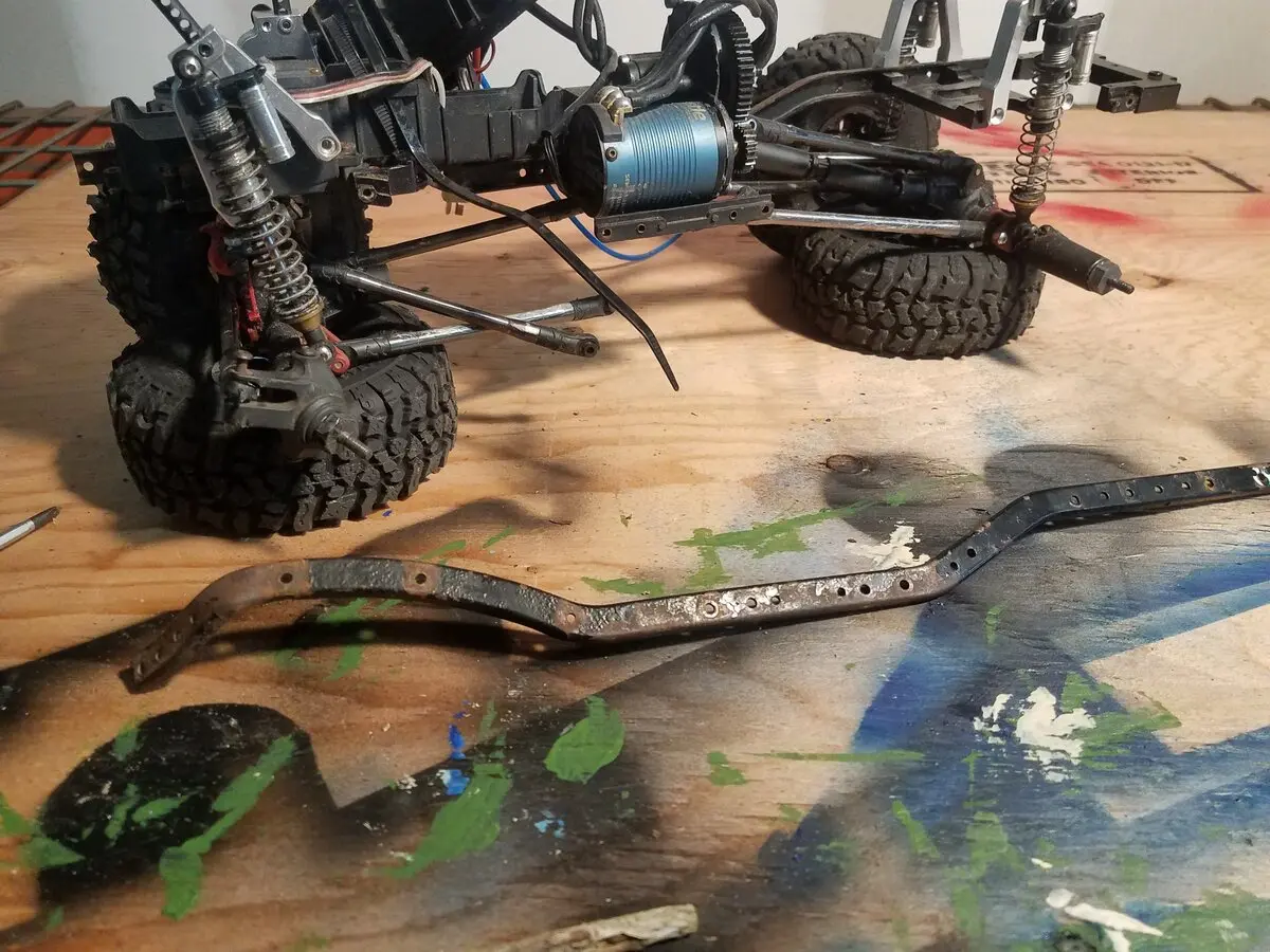

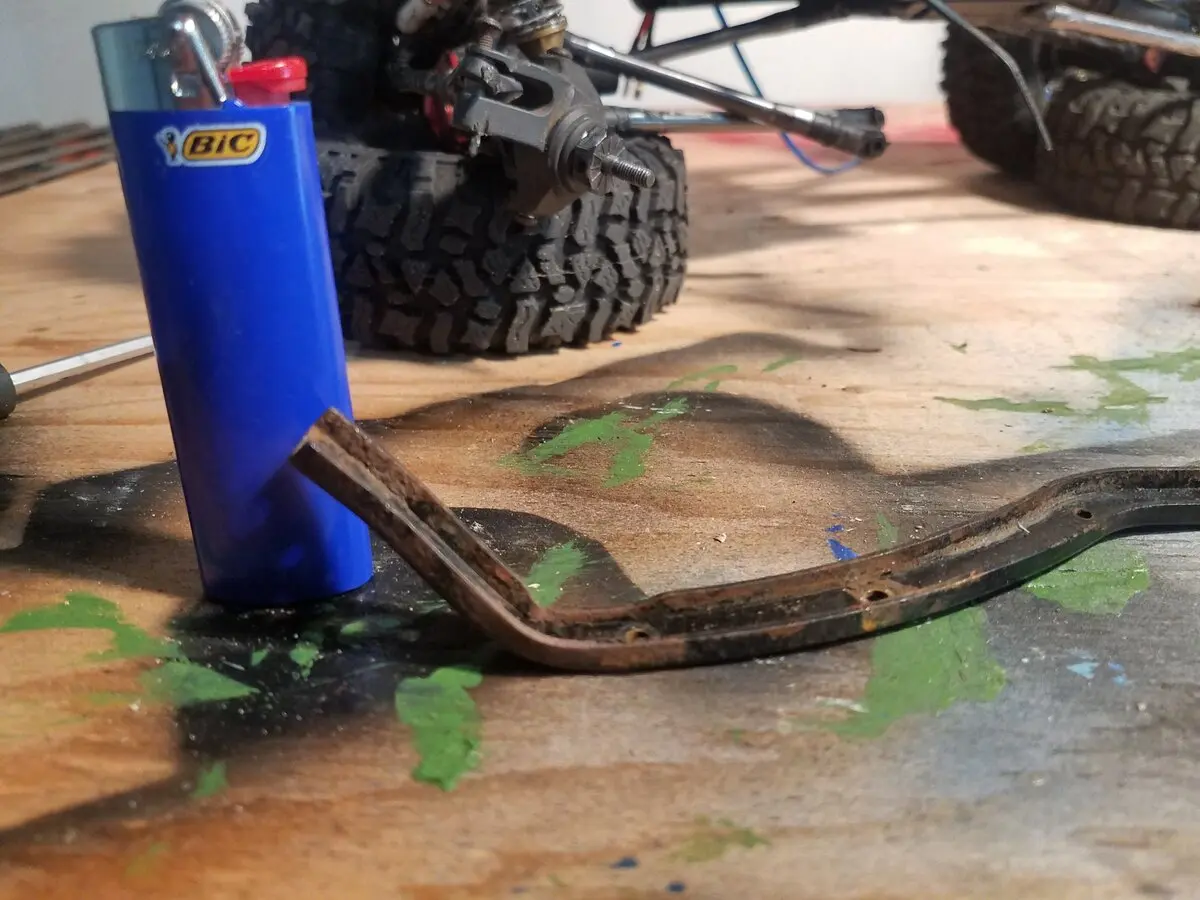

Bent chassis. Yes I did pull one rail off and left it a twisted mess. 😁
full
full
Used a vice, torch, small locking plyers amd my knife to fix it. I had the tranny part of the chassis locked in the vice. I heated it and used locking pliers to hold the bent end to bend ot back. My knife, a S&W M&P, I used the metal tip for breaking windows to push the bect part in and used the pliers to pull up on the bent side. On the road, if its at an angle and that angle runs towards the drivers side the truck will pull. On normal ground not as much.

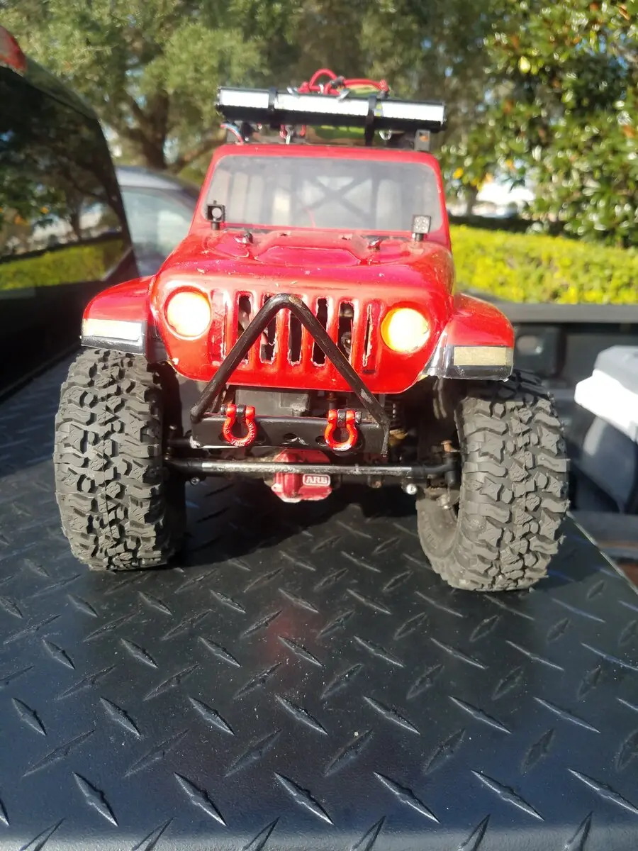

Some updates. Shoe goo'd a radiator, added decals, and created a badge. The badge is painted lexan with a sticker on it shoe goo'd in place. Also creating a box. I'm painting it as a U.S. Army weapons crate.
Added a reflector to hide the screws for the grill. Also added plates so my Dodge Dart FHP keeps it moving. Daylight only driving until I get a tag light.

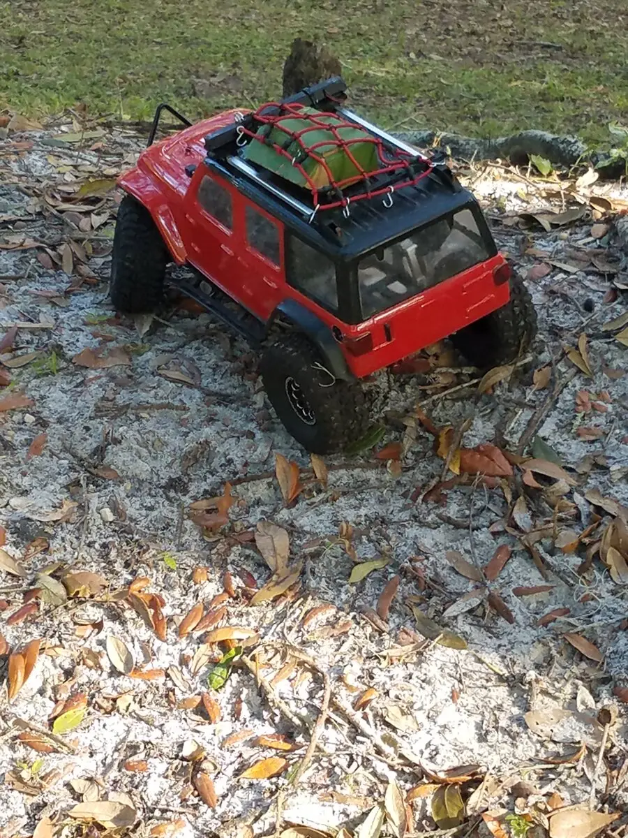

I would like to state this first. This roof rack and cargo net straight up rocks!

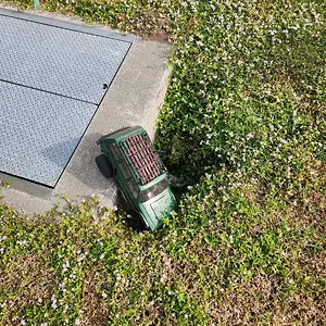

Some under bridge shots by the river.

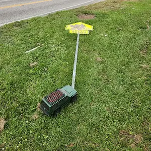

Can you Trx 4 flatten road signs? 😁😇🤪

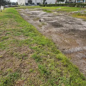

First explore after the hurricanes. I found multiple holes and dips. The largest was 3-3.5 feet deep. I feel in driving from a distance. The bulky Axial body kept it from hitting rock bottom.

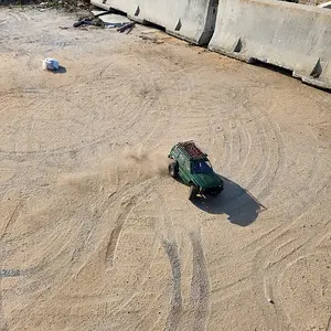

Finishing up with some donuts.
Gonna bring the gopro next time and yank upclose action shots from the video. I also have a complete ar44 encounter for some 4x4.

It said 1.5 hours for that, and I hit lvc 20 minutes from home it went off once and not again. I think I have the copperhead 10 that prematurely hits lvc. With that said I drove it to and from home on the same battery. Very fuel efficent with the gear reductions of a crawler, my top speed on 3s is 19 or 20mph.
It was calm driving, full speed passes, and alot of tire spinning. I have the ax10 tranny with a 21 tooth pinion, castle 2280kv, smc 3s 5200mah.
I plan on another 3s of the same size and running 8-10 mile round trip in January. After that I'm going 4s to try.
