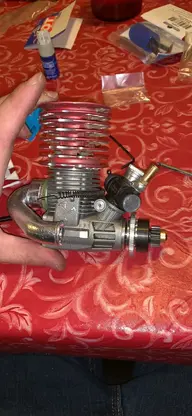

So I wanted to support my local hobby shop, was an expensive venture but the engine is all together!
I did use a traxxas flywheel, clutch setup! I appreciate the help! Now I just need to figure out how to mount the engine once I get my adjustable mounts in.
