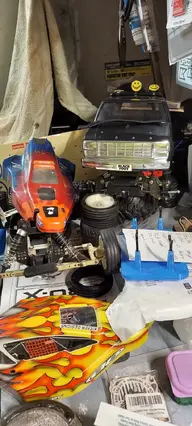

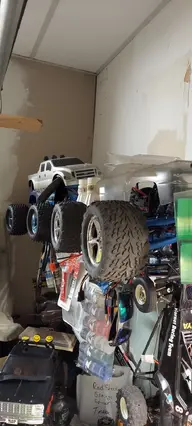

All rc wheels stick out. Last pic are RC's from the 80s and early 90's. So it's always been wheels out 👍👍

Sweet! Would love one of those old retro looking shells tbf, I even wondered if you could fit something completely different to it so I'll see what is around!
Which retro body one? The blackfoot for ranger side step. Or the Kyosho Pro X body?
