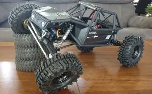

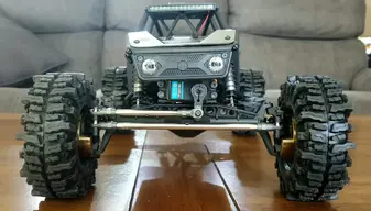

Warby's built CAPRA 1/10 1.9 4WD
Upgrades, mods and gear used:
-Holmes Hobbies CrawlMaster Sport 16T 540 Brushed Motor
-Hobbywing Quicrun 1080 80A Waterproof ESC
-DS3235 35kg servo
-Steel High Clearance, longer Links
-Smallest pinion (can't remember what it is)
-1.9 Beadlock steel wheels silver
-1.9 Hyrax copy tyres
-1.9 Mudslingers tyres
-Hot Racing Over Drive Portal Gear Set 13-22T
-CF and Aluminium Servo Mount
-Brass front portal covers
-Tamiya PS-23 Gun metal grey painted body panels.
-Stock shocks with pen spring mod and softest springs
-Custom made drop shackles for shocks Frt/rear

Challenges Faced
Never fitted the interior or connected the dig servo
