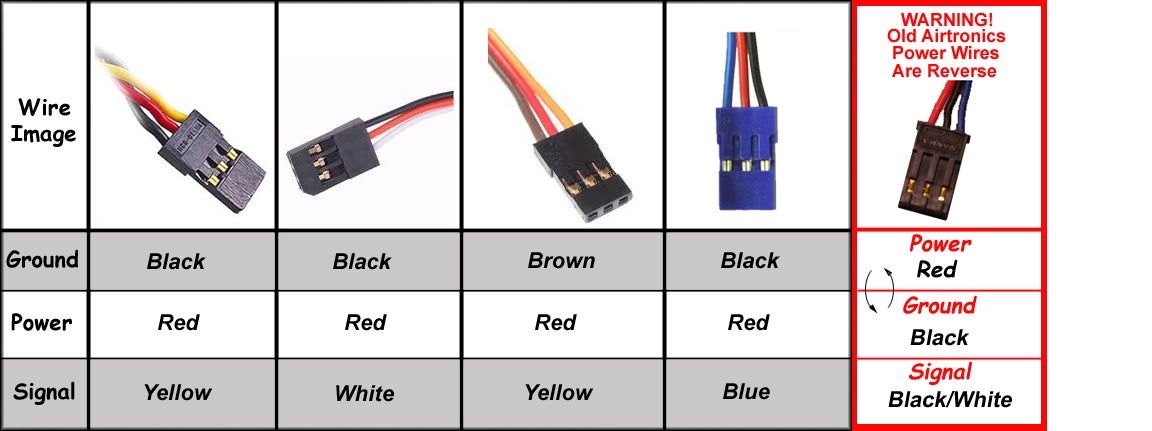

I think I kind of get how this RC stuff is set up but I don't fully understand where it all plugs in and how it all works together. Can someone please explain it to me or else show me the resources so I can understand it?
The servo wiring is pretty simple. Power is always red and with rare exception (some older Airtronics servos) in the middle. The signal (PWM) and the ground on are always on the outside.
Just remember the darker wire is ground and the lighter one is signal. If you swap them no big deal it "shouldn't" hurt anything, but it won't work either because the servo will be looking for pulses and GND has none.
