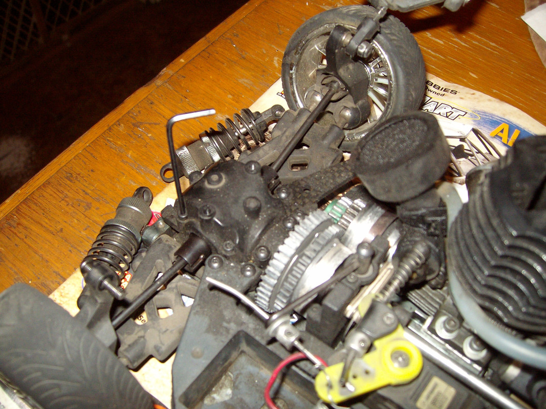

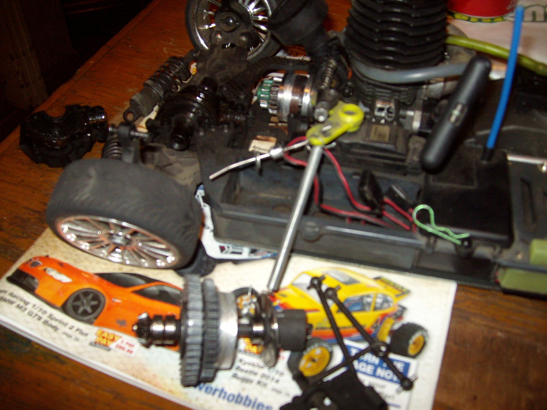

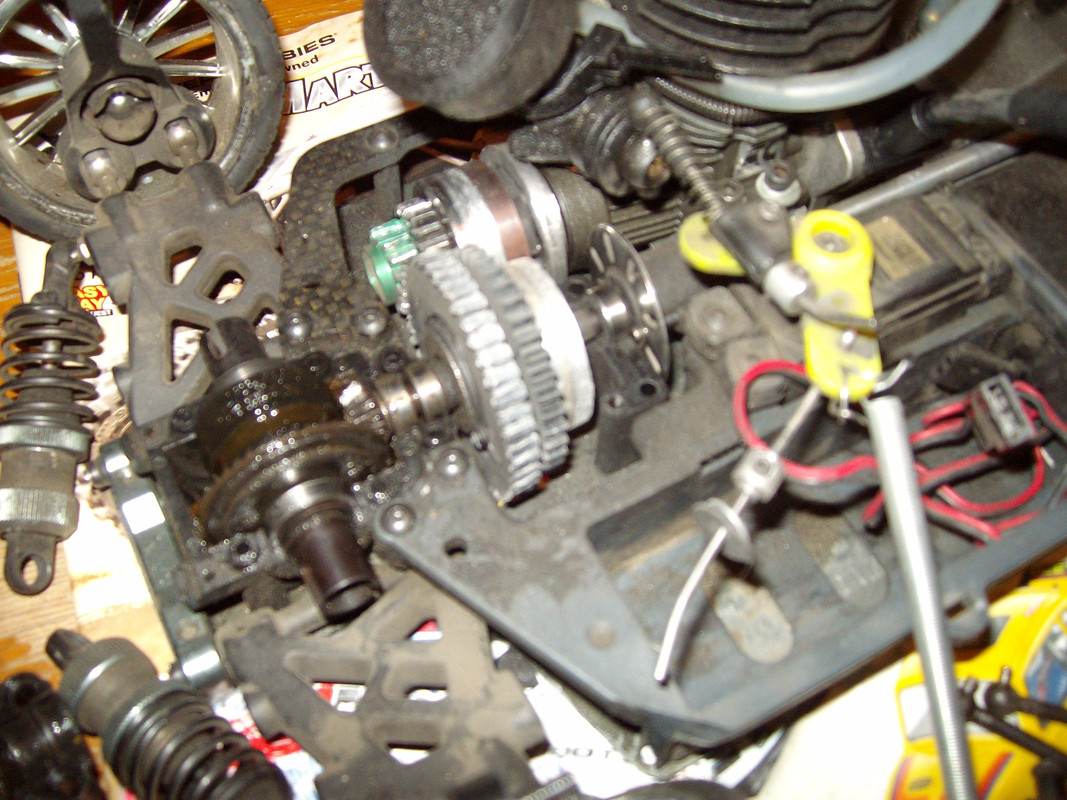

Okay cool is their a easier way to remove the transmission I have a picture here. Can I remove the rear case & slide it out
You think this 40pds springs will make my cvd bone stick out this is how they sit
You dont need to remove the whole diff because the diff splits at the rear ,when you
take the shock tower off ,then you un screw the top of the rear diff housing ,then you
can pull out the 2 spd gear assembly!

Not sure ,however ,the pics that I showed is not an Ntc3 ,it is the Ofna LD3 ,but they are built in the
same way ,but Ofna's running gear was built better with metal gears & dual bearing an capable of
handling bigger power!

I have the Ntc3 ,but it is a shelf queen an I think that I do have an extra 2 spd hub & gear set up
laying around!
I can get it out an take pics of it an post it!
It is very important to keep those gears in line an shimmed properly with out slop or wobble!...:cool:
