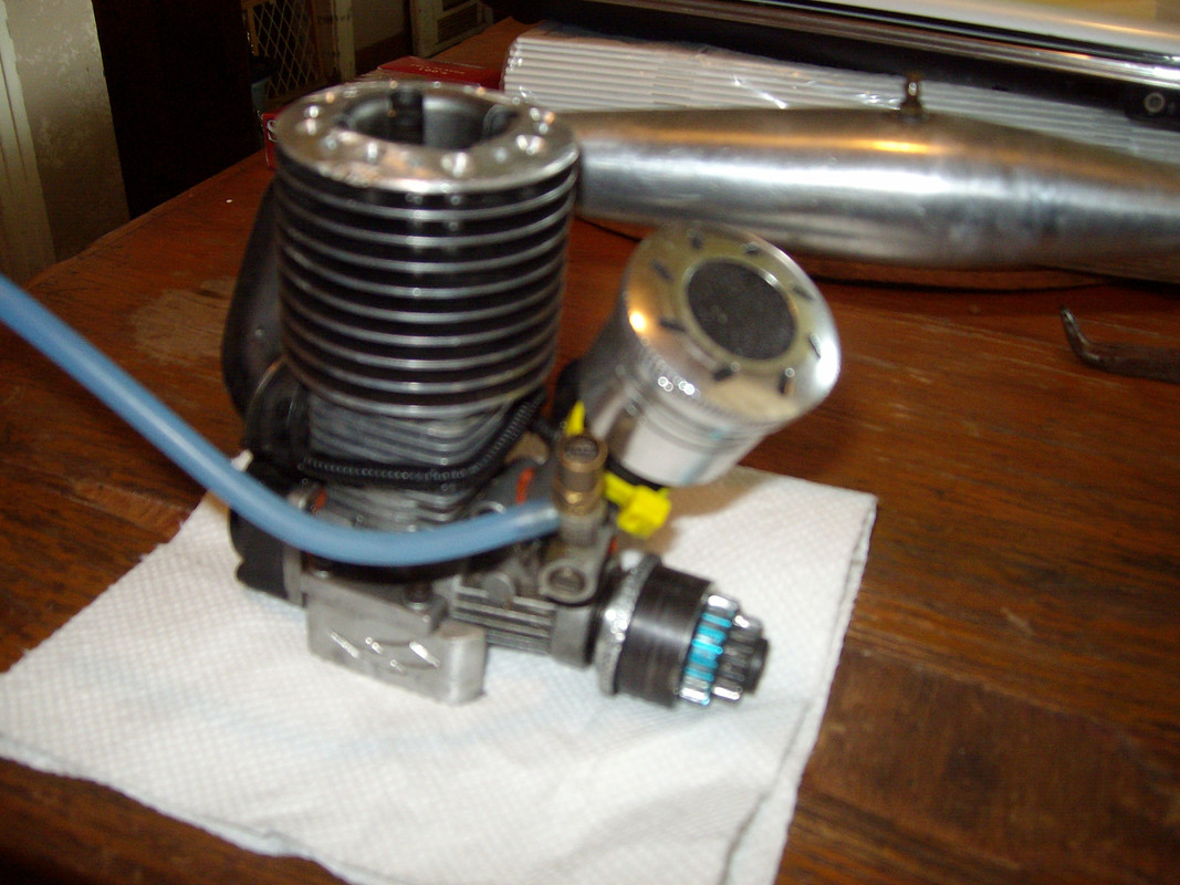

Do you have the screw on pinions gears that screw on a threaded clutch bell?
That is what I use ,they can be spacers & shims put in!
Here is a pic of a threaded clutch bell with the colored gears!
