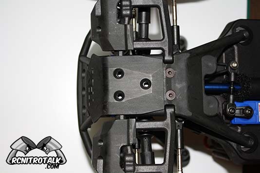

Installation of the bumper is incredibly easy (as is all work on the Stampede), simply remove the three screws holding the stock bumper/skid plate.
T-Bone bumper install, remove stock screws

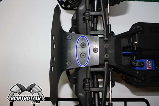

Next place the T-Bone Racing bumper over the top of the stock Stampede bumper then use the two included screws in the locations circled below. Use your stock screw in the last remaining spot.
T-Bone bumper install, add bumper and replace screws

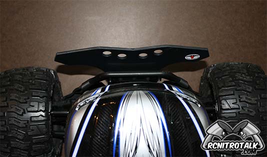

It's just that simple. After installation I did check to ensure the T-Bone Racing bumper did not hamper the suspension or a-arm travel and there was none. Even pulling the a-arms down they at no time touched the skid plate portion of the bumper.
Flipping the truck back over you can obviously see that the T-Bone Racing front bumper is much wider than the stock stampede 4×4 bumper and sticks out further then the stock bumper. Where as the stock bumper was very close to the chassis the T-Bone Racing Stampede Bumper is now providing more of a buffer to absorb impacts.
T-Bone Racing stampede bumper installed
