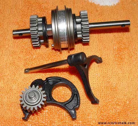

Below is a picture of all the items removed from the inside of the Monster GT transmission after the FOC kit was installed.
monster gt FOC removed
