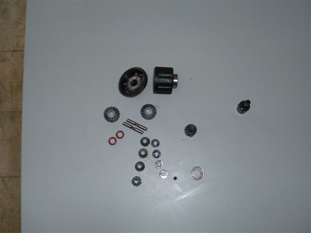

Here are the parts from the diff.
Dissembled diff

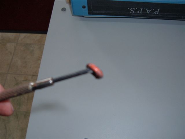

Start off by greasing the o-rings.
Grease the o-ring

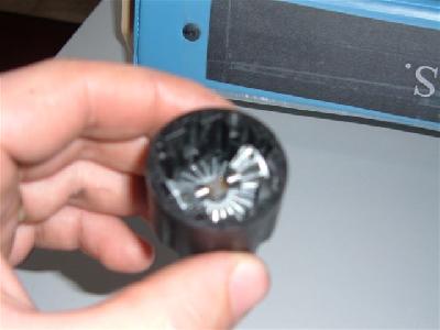

Insert the o-ring into the diff. Make sure it is seated well its your main protection from leakage.

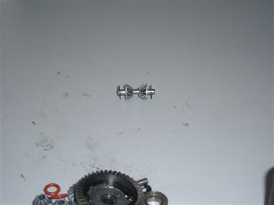

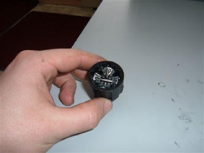

Assemble the inner gears, you will have two sets of these.

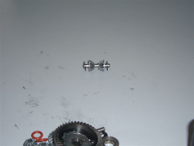

Insert the two sets of inner gears. The shafts that the gears rest on have grooves cut into them make sure they line up when inside the diff.

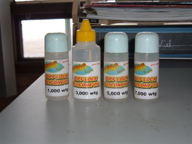

Choose your fluids, they range from 1,000 wt (1k) all the way up to and beyond 100,000 wt (100k).
Diff fluid weights

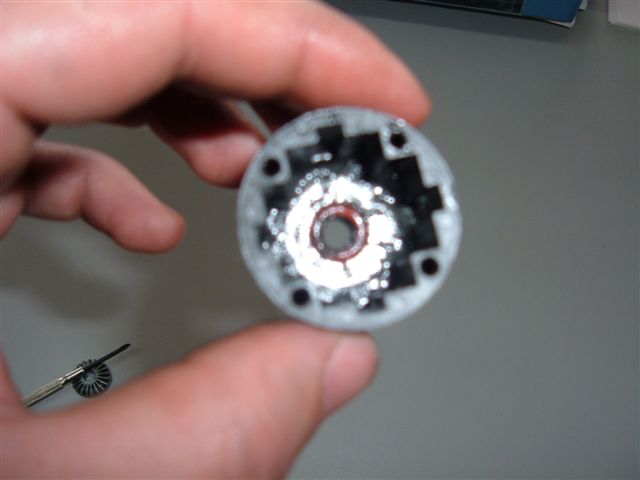

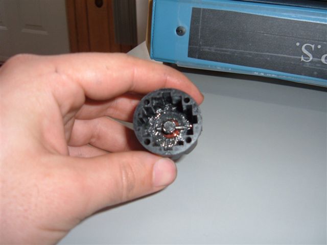

Fill your diffs with your fluid, I went with 3,000 wt (3k). You want to fill them up to the cross section. I usually fill it to the cross section then add a little more because there are voids inside that don't get filled right away.
Fill your diff to the cross section
