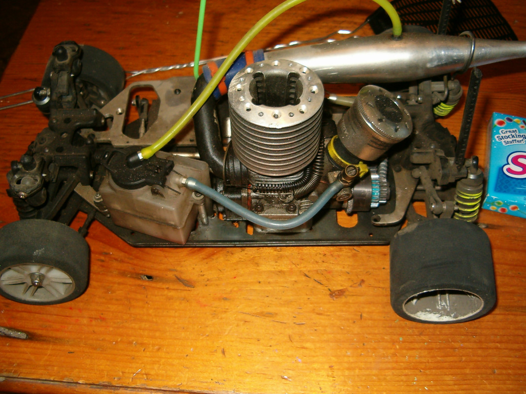

photo share
Got the spring on ,now ready to throw the engine in ,maybe get test run in a bit!

I just did a test run after fixing clutch ,it runs pretty good!

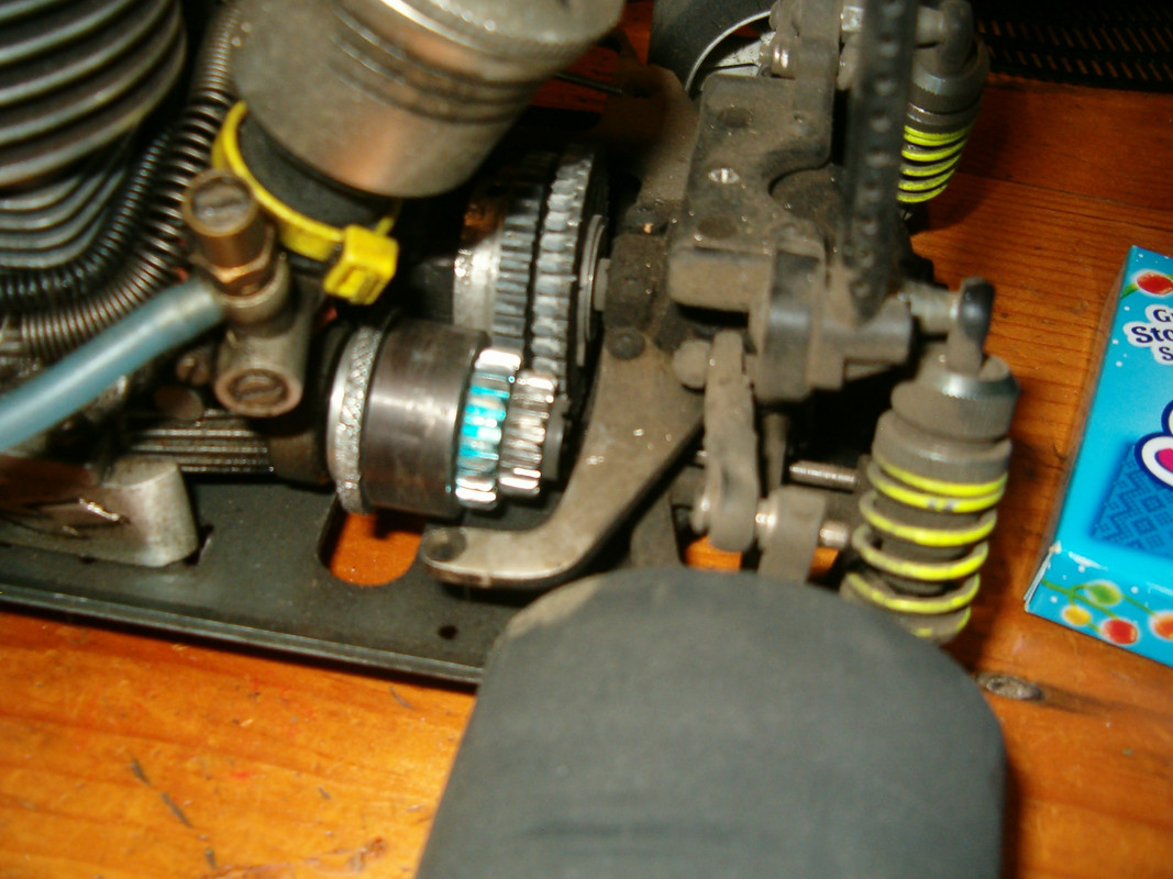

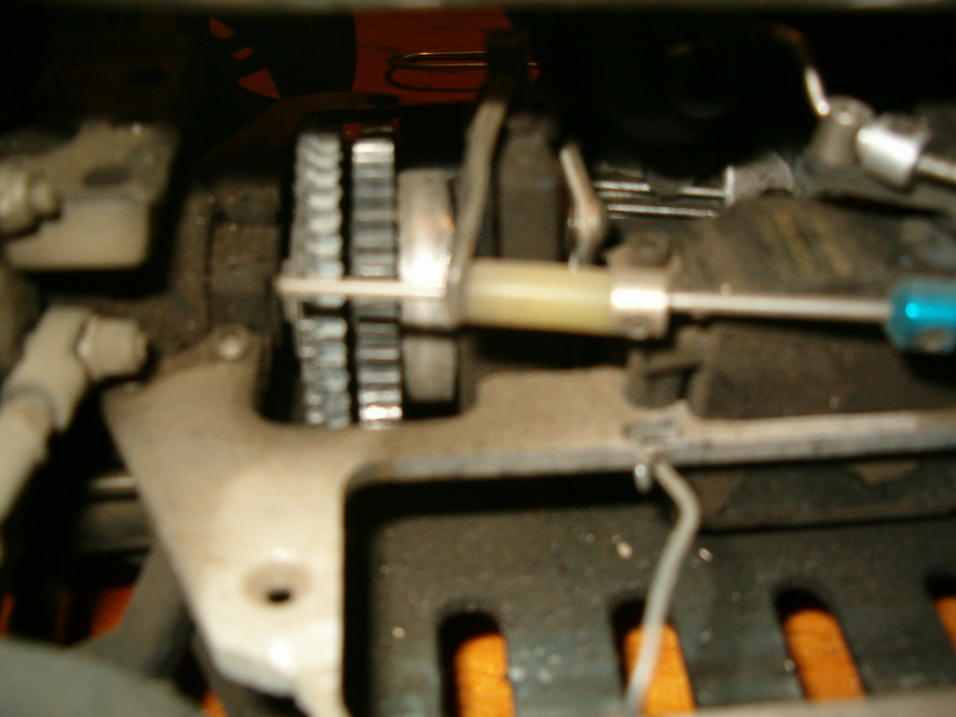

My engine loosen up a stripped one of the spurs ,Theres still got some meat on the
teeth ,I maybe able to salvage the gear with file!...I think I got xtra gears though ,its just the
idea of pulling the stuff back apart!.......BLEH..:doh::doh::doh:

Yea I pulled it off the shelf an looked at it ,I need to do some repairs ,I think with a little file ,I can salvage the
second gear ,put a shim behind the second gear on the bell to scruff up what little teeth is left an re-adjust
the engine ,it looks like I lost screws to ,so I will replace those ,along with some wheel adjustments!
