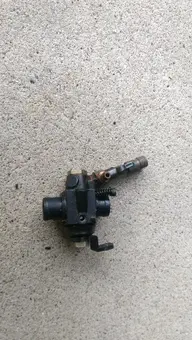

i got it to run!!!! i took a picture of the carb that was originally on it (the "broken one") and the engine for you guys, its definitly a HPI. it was so nice to see it scream around the driveway again. but the carb is a single screw so i guess I'm buying the other one, can't wait to see what its like with the new one. any tips on cleaning this thing and is it worth it to eventually break down the motor to get the gunk out of it? (I'm thinking winter time project). id like to get this thing running as well as possible. also how do i tell if its a .15 or a .12? any tips on keeping this thing running as best as possible?

your carb has a low and high end needle adjustment from what I can tell the high is where whe fuel line hooks to the carb and the low looks to be where the rotaty arm is in the middle of it.Your idle screw is right below the air filter.
didnt know that was where the low was. so if it runs but cuts out after a minute idling I'm guessing the idle screw has to be adjusted correct? or is it normal for them not to idle forever?
cool thanks. how could you tell its a traxxas? i couldnt find a marking on it. Also is the black carb i have the original carb for the engine?
when i looked at it yesterday there wasn't a scratch on it. maybe it is a 1 screw and thats why they took it off?? i dont remember the low speed being where it is on the traxxas one.
