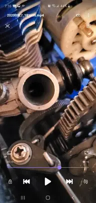

Thought I could upload a video but looks like extra steps needed. I'll send pics later. Carb isn't fully closed at neutral. Maybe .5mm gap. At wide open its def open all the way. All fuel lines are new and secured with clips that came with lines. Engine is almost brand new so doubt brings are worn. Trim settings are a mystery to me. They're currently at 100%. Should they be reduced? Exhaust is secured with zip ties on both ends

Neutral throttle pic attached
trim is the location of the servo rotation at neutral position. (i.e throttle trigger is not pressed or pushed/idle position.) if you are not touching the throttle, and the carb is closed as far as it physically can (leaving the .5mm gap) your trim will be ok. if the trim is adjusted too far one way, the servo will hold the throttle open, but when you brake it will close. if its adjusted to far the other way, it will hold the brakes, and be pushing against the throttle slide further than necessary.
