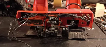

Got the light kit in its place and the supplied electric equipment.

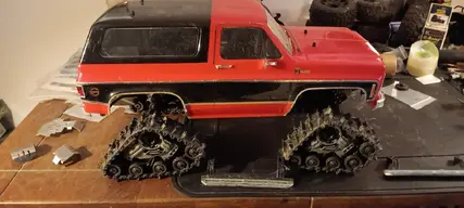

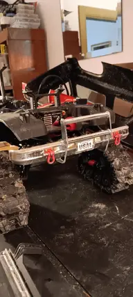

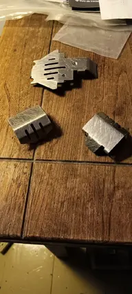

Tried stainless skid plates, they act like magnets on rocks, resisting sliding over so I took those off! Of course any snow crawler needs a set of deep tracks in his inventory!, put the hobbywing fusion 1800(old model) and it's amazing! Slower crawl speeds faster top speed, and the battery lasts 4 times longer! Didn't have problems with the stock servo but put in a ridiculously strong one power directly to the battery! Put the tow hooks right on the stock bumper, made a custom winch mount and cut the receiver part from another rear bumper bracket and glued it under the front bumper, the idea came from a 1980 pick up I had and made so I could put the winch front or back, just incase the closest winch point was behind where I got stuck. But on the trx-4 it was to low and crashing into everything so it broke off at the glue. Got a replica interior that even has Guage lights, cooling fan, and servo to turn the steering wheel
