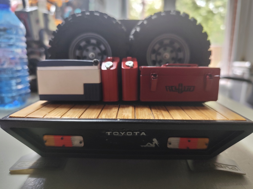

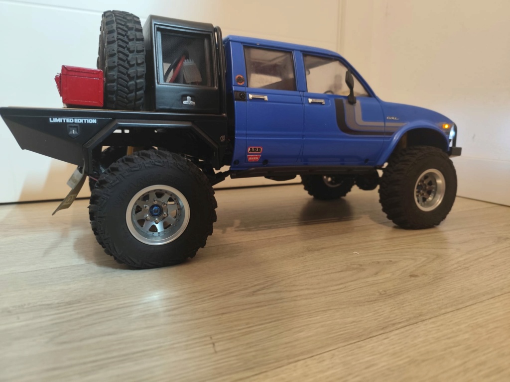

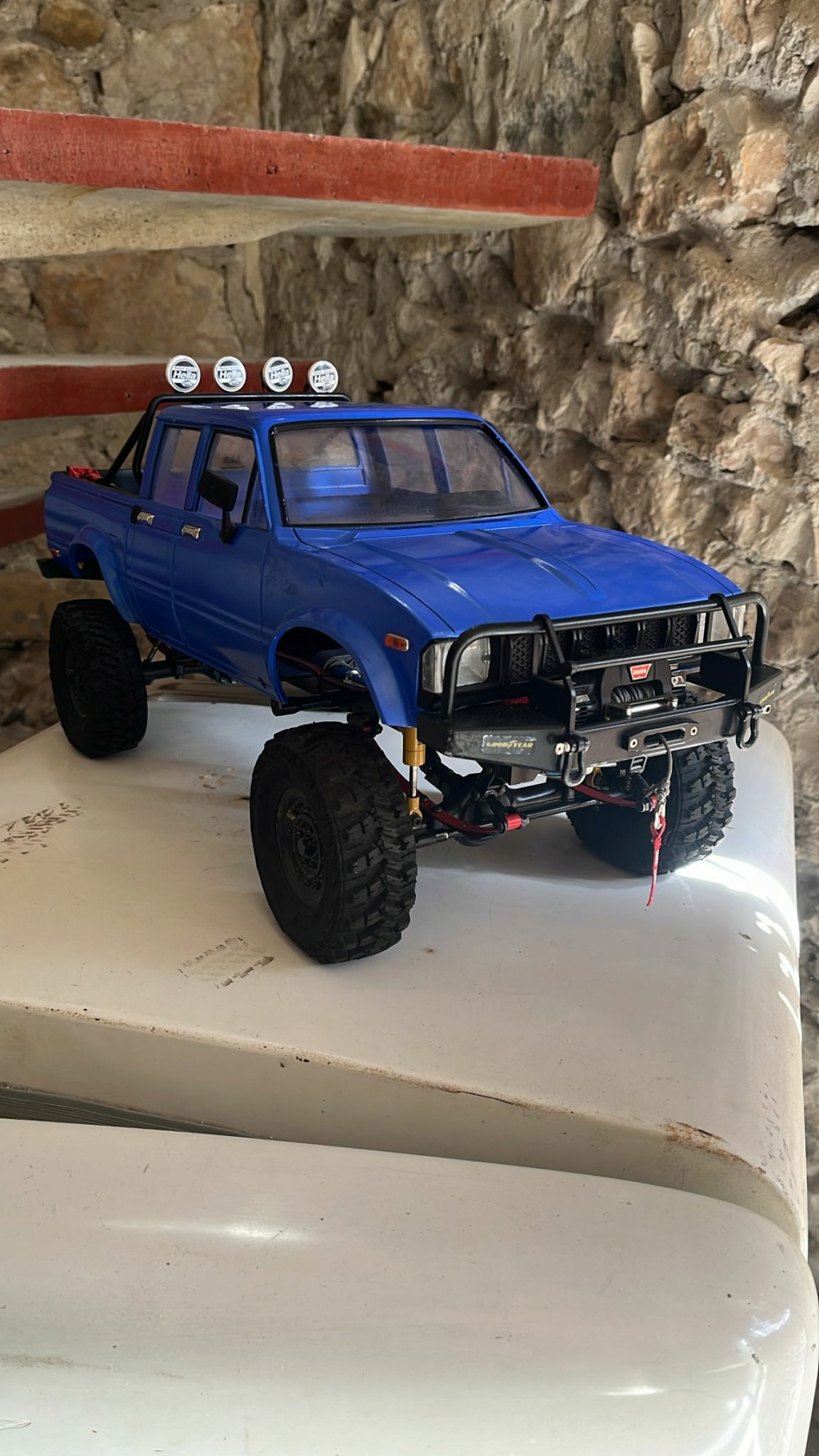

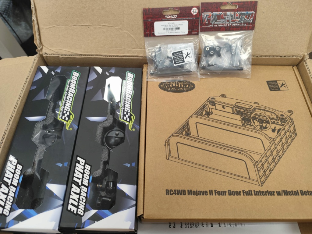

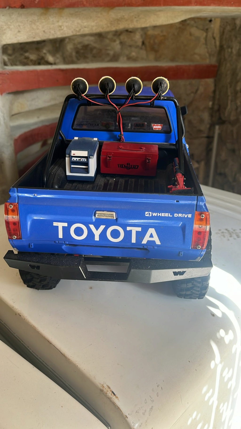

This chose is arrived at the house today, avec pas mal de choses RC4WD.
ARB Front and Rear Bumpers Anti Roll Bars with Red Crossbow Spotlights 3 Pairs of Teraflex Twins Nitro Shocks Goodyear MTR Wheels Highlift Tank Tires rc4wd rc4wd Fridge rc4wd Metal Tool Case And I'm sure I left a few other little things out there, time to revisit and make some changes, you'll see them as always:
Awesome. I like me a Toyo 4wd. What's your plans?
The first thing to do is to assemble this with everything that it entails, adding an interior, changing the Yota axles for more reliable Boom axles, improving the servo, adjusting the suspension...

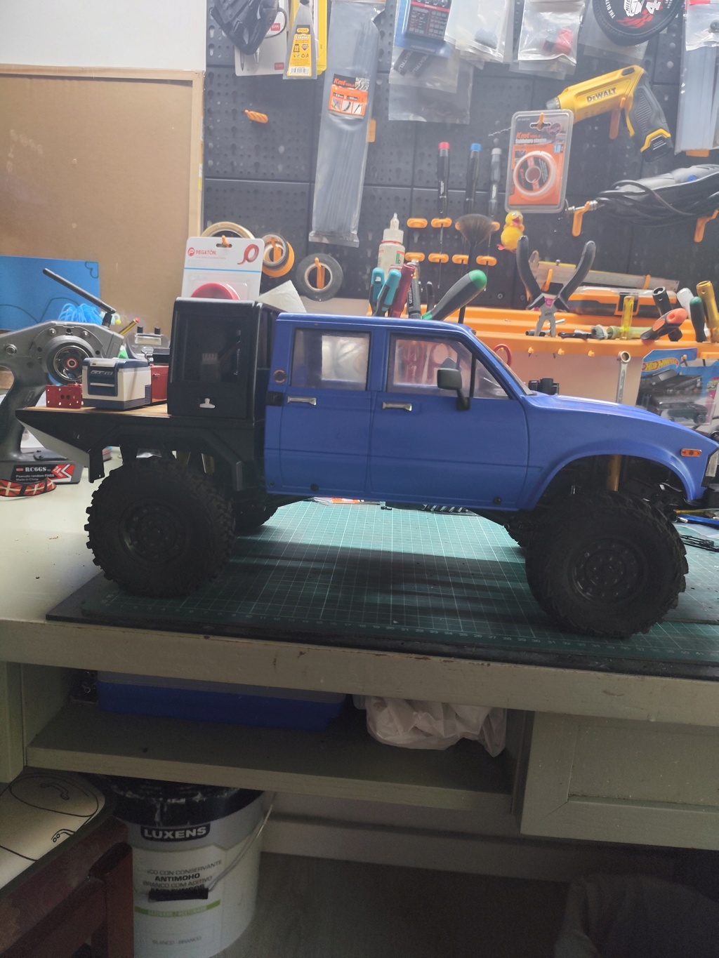

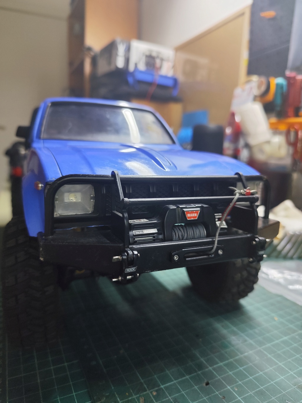

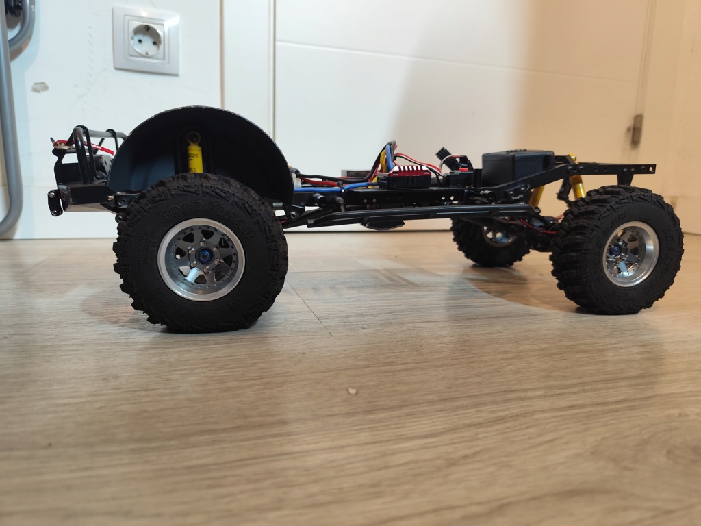

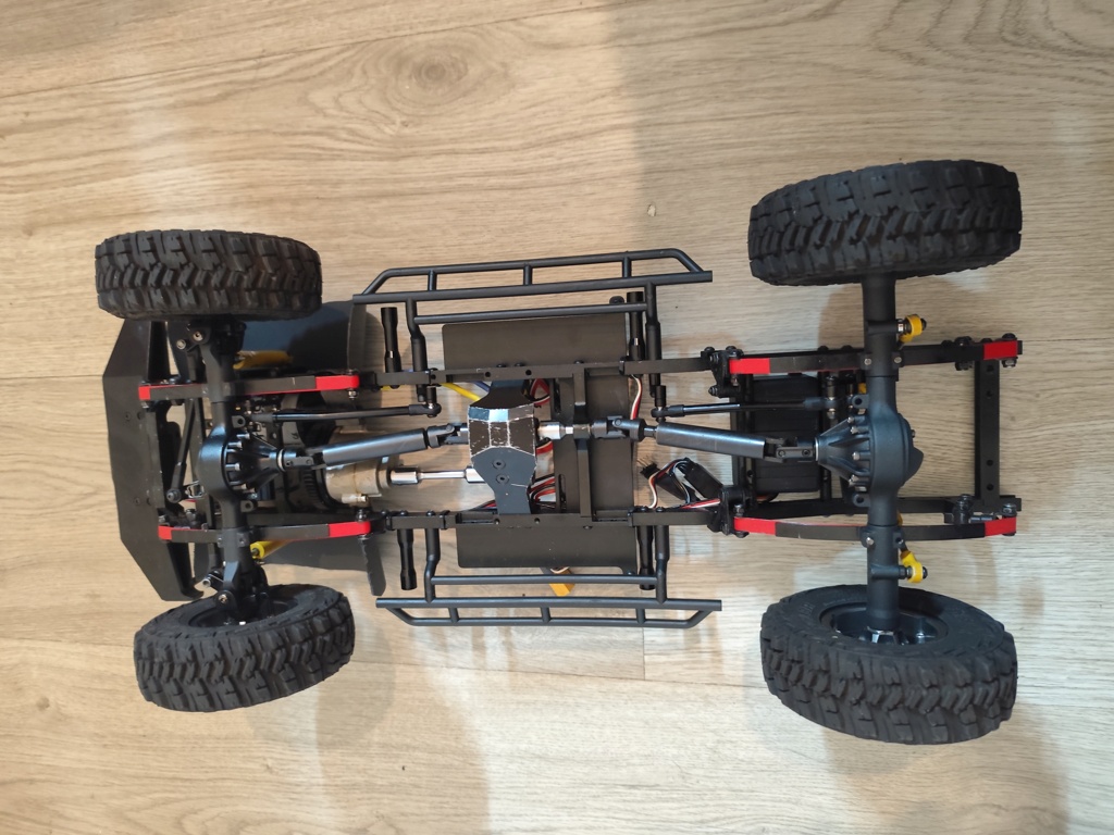

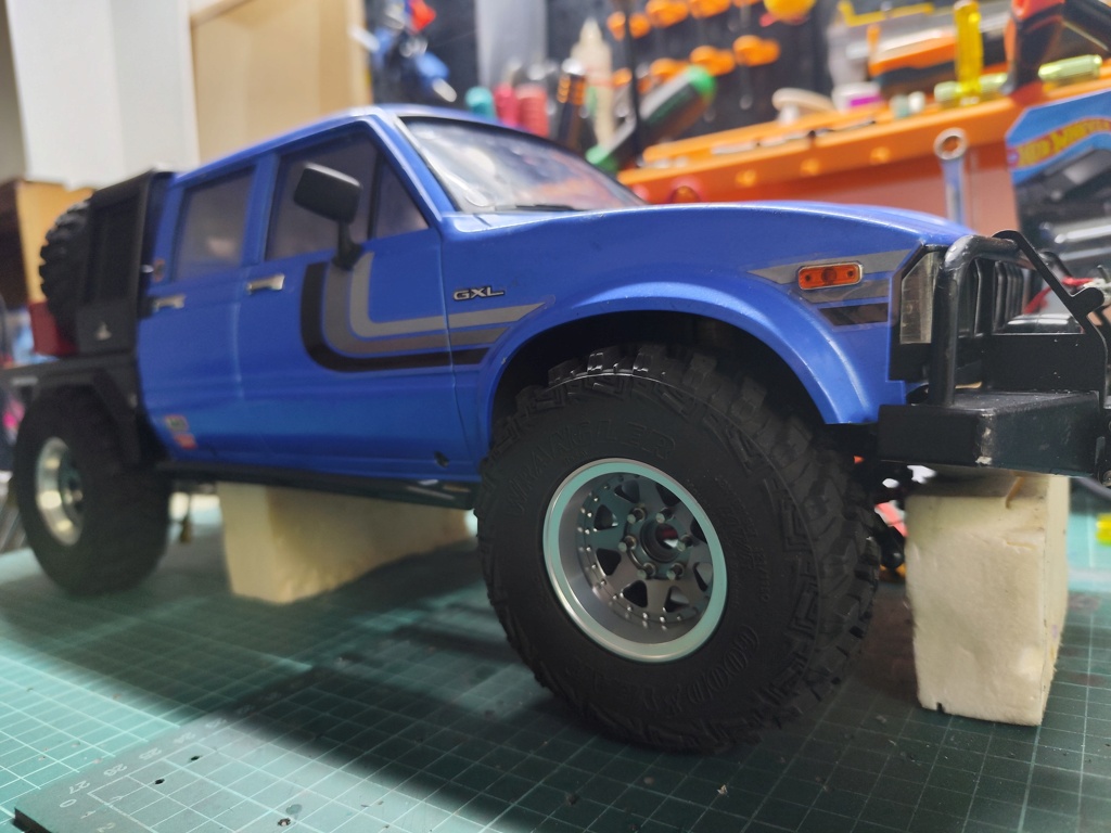

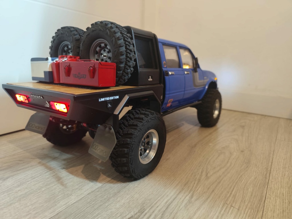

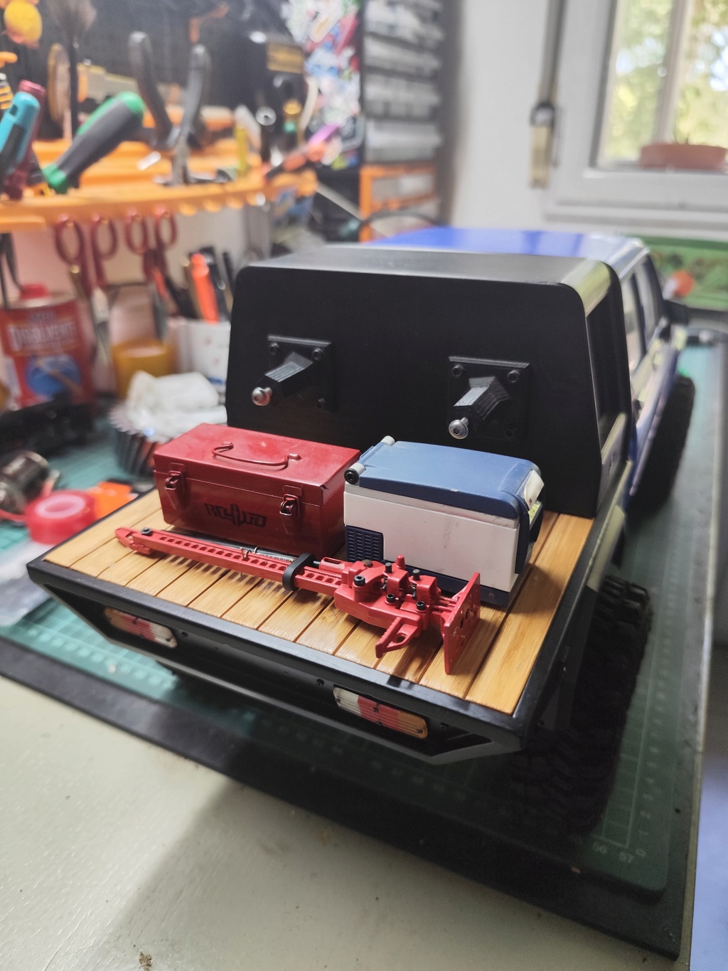

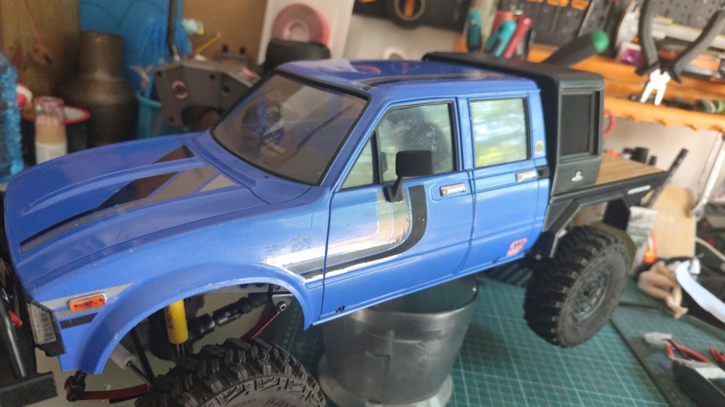

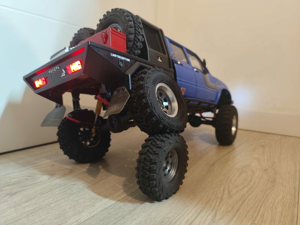

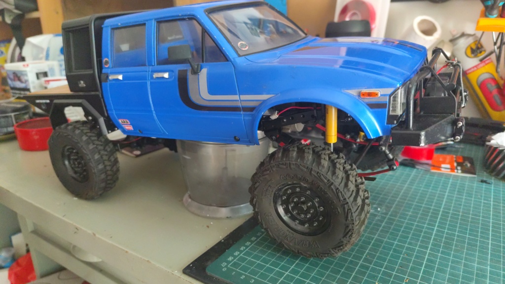

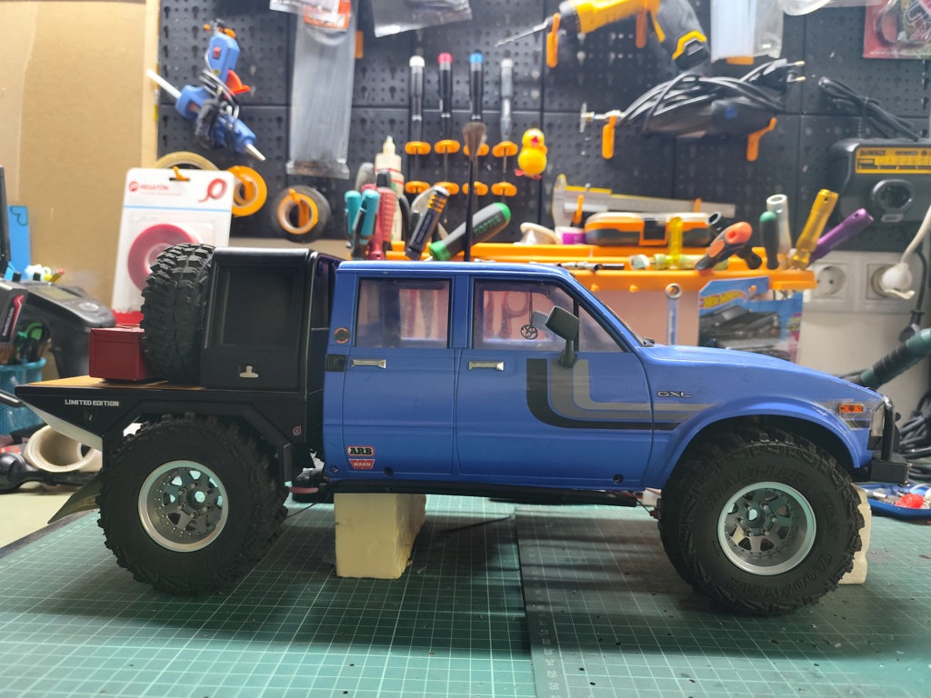

Today I have made some progress, I have advanced the winch, so I have moved the bumper back, I have removed the body lift kit, I have tested the rear bed , I have adjusted the suspensions, I have changed the electronics for a Holmes 40t and 1080 and servo srt 45kg, it still has hours left but you can already see something

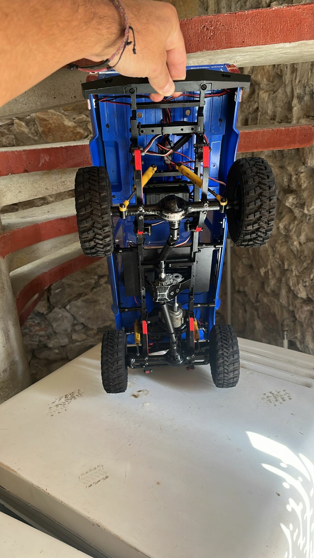

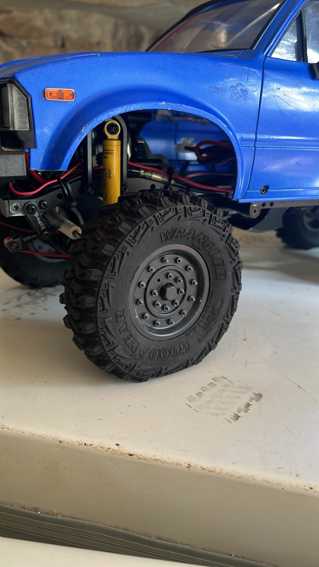

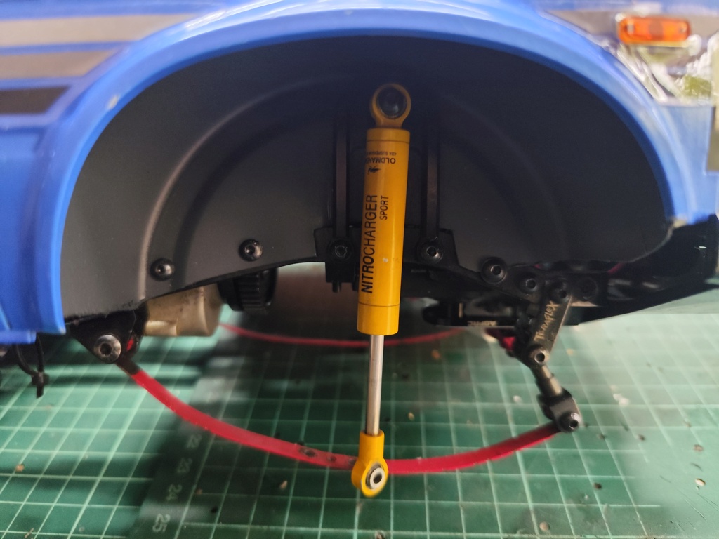

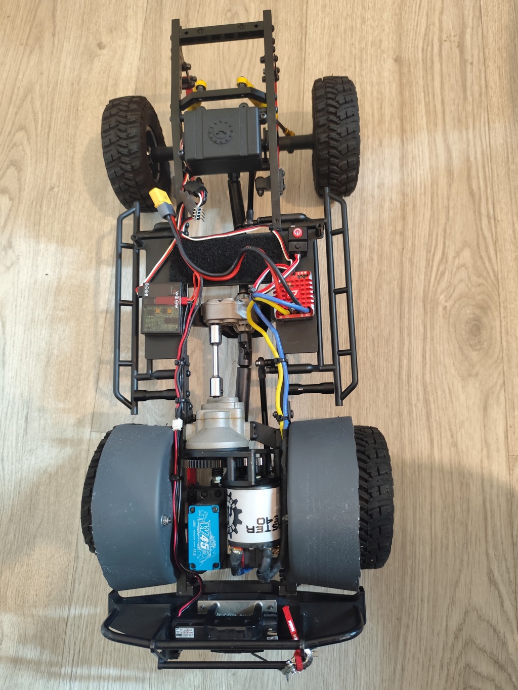

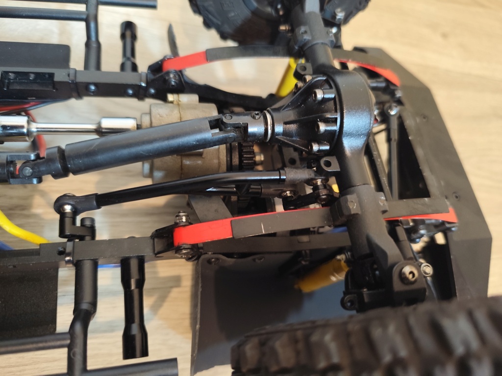

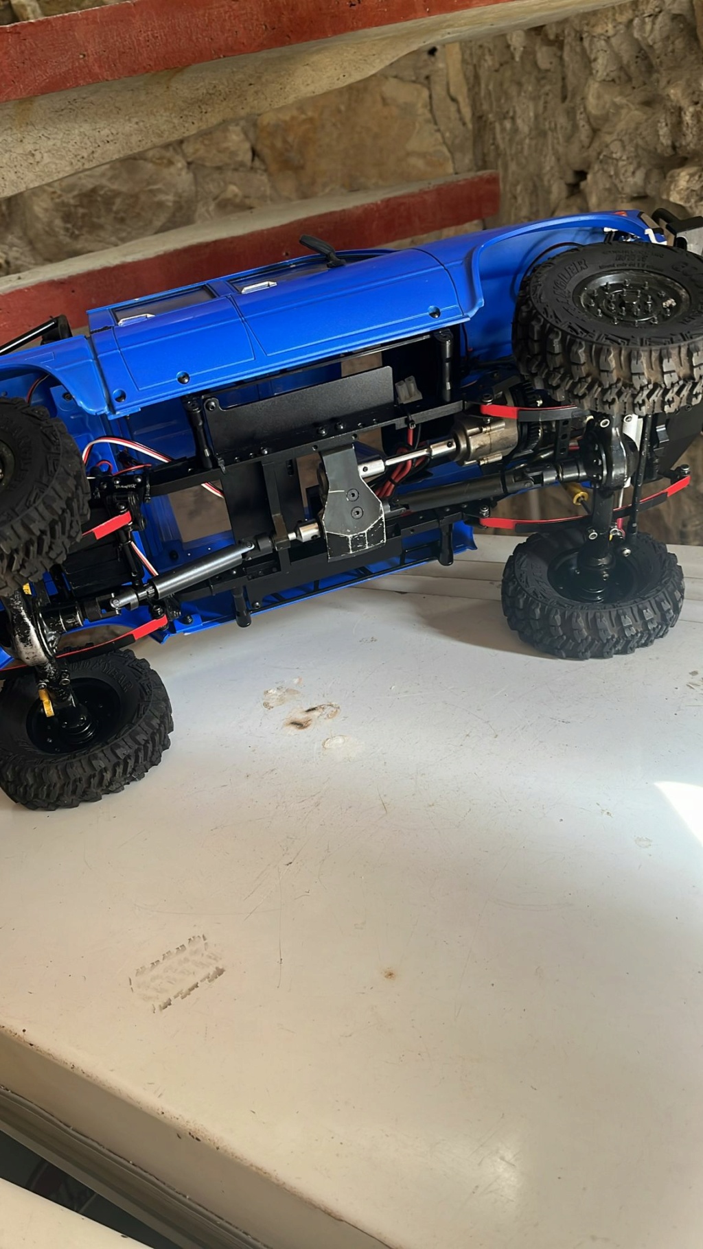

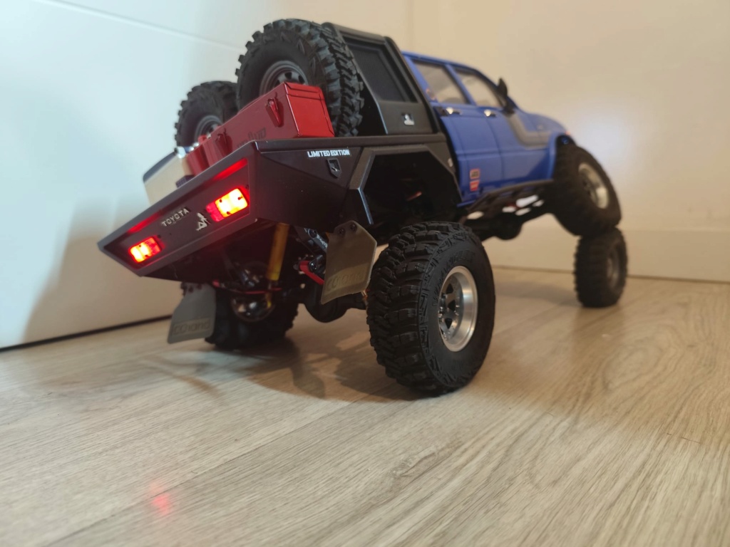

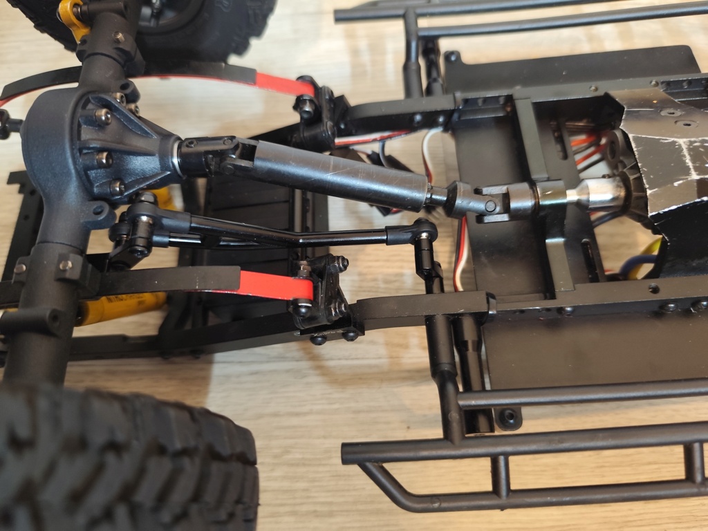

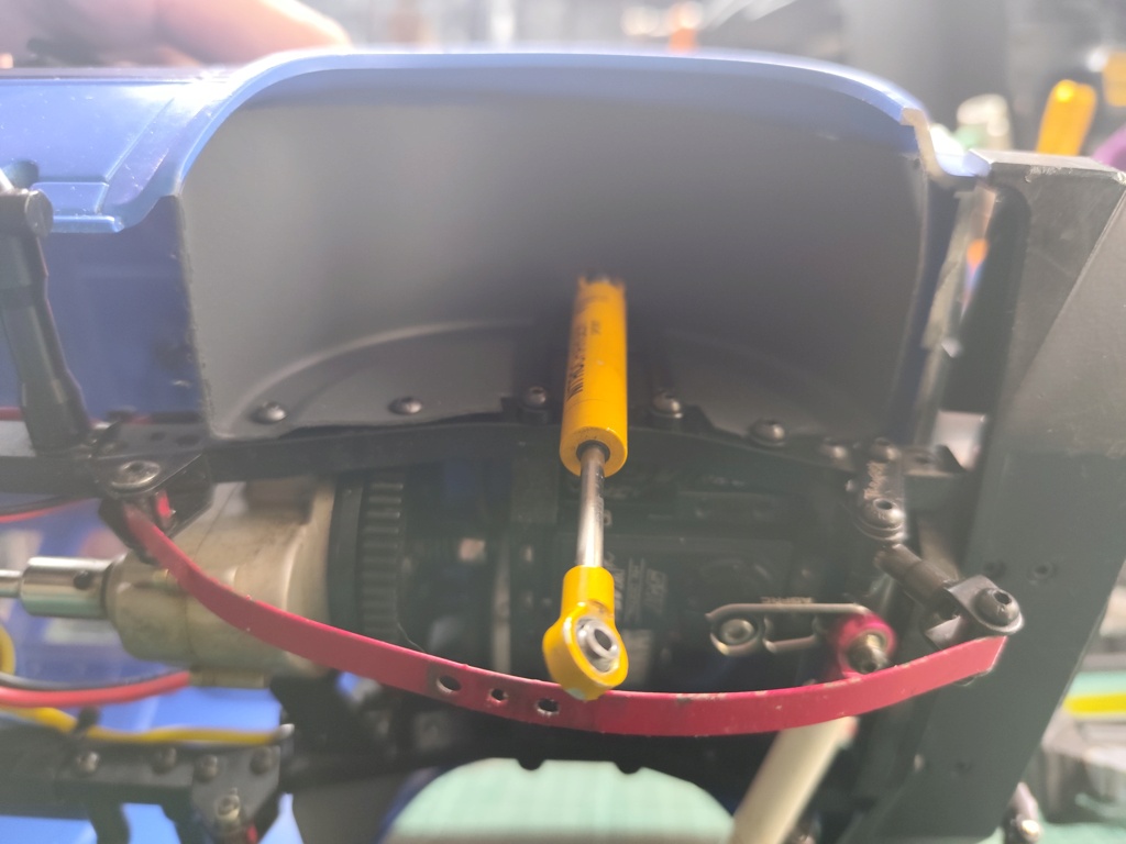

Well, it's almost done. Although it seems simple, it took 4 hours to mount the axles with the antiwrap bars. I had to put several bushings on the rear antiwrap bar to prevent it from touching the teraflex, and the front one had to be mounted on the opposite side to which it is intended, so I modified the support and mounted one of the longer ball joints. The boom axles are in reverse with the rear ones, so in the photos the axle can be seen the other way around, but I got a normal 30/8 pinion and crown kit for the rear axle, while waiting for some slightly narrower hexagons. You can almost say that it's finished.
