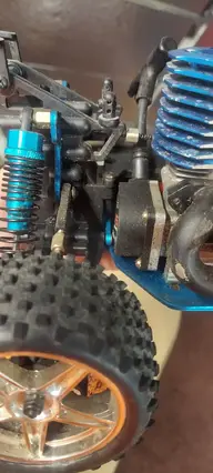

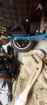

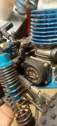

I have a original SH pull start. That's what I was thinking. That pull is pretty deep
In sure I have the old case laid around too as I remember the SH sticker on it and thought it looked identical to this one tbh, so I'm a bit puzzled ATM gonna check the part by number and see if I can get dimensions, right after I've fed and walked the hounds that is lol
Sorry I got caught up doing crap around house since it was nice 70° today crazy..
So the original SH pull start is
.06 or for you 16mm deep.
So I understand that the brace is needed. Could you shave down the pull or the brace..
OK the pull I have is 20mm deep so defo must be the wrong one for this engine/chassis combo. Looks like I'm buying a new pull start again lmao thanks stoner more awesome info saving the day!!!

I try man.. I thought that pull look deep. So it's a after market one. So its basically a universal fit.. Did you messure to see how much was past the brace? I use some old red lipstick to messure stuff like that. Rub it on brace then install the engine let it rub on the brace. Pull it off should have the lipstick transfer on to the pull

It's around 4 mm so would make perfect sense that the one to fit would be 16mm wide! If you can check postage costs mate that would be epic, it's not always the cheapest US to UK and I'll try find one over here just incase

Oh the SH pull start is a very tight fit on the redcat tornado.. over here at Hobby town it's $7.99 and Amain it's$9.99. Let me know what you find. I will send you this one. It Works just fine. Can also order you some backup string. Or just another one all together. Shot I might even have a second one. I will look in a few to see if I have a second one...
