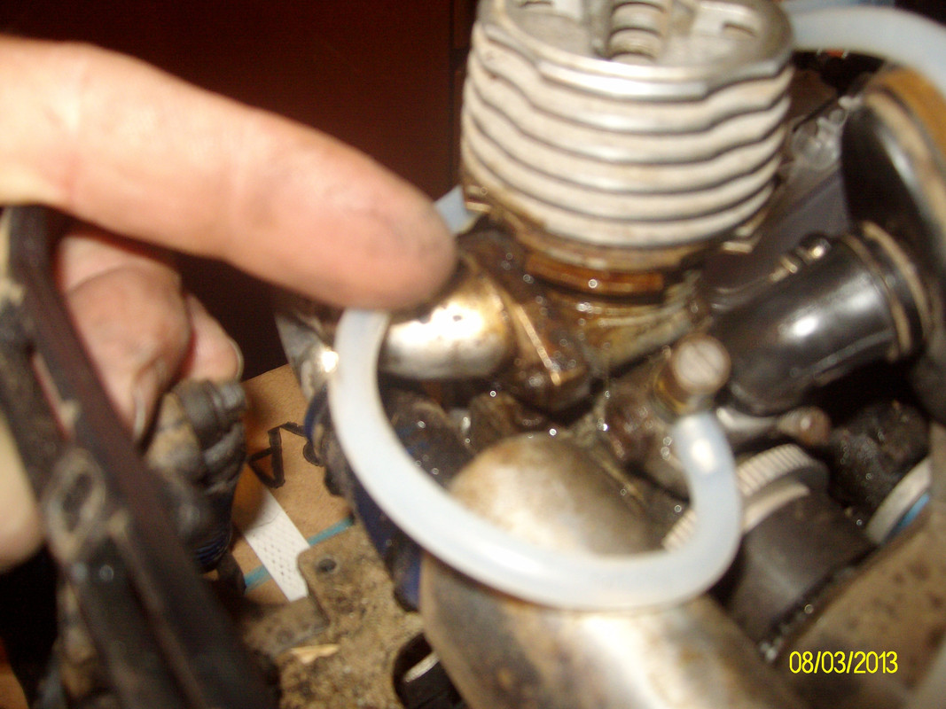

Here is the results of an engine that was never tuned & leaned off of the break-in setting ,break-in settings
from factory is a very rich setting an if it is left that way ,can cause massive leakage due to the high pressure
from the ecsessive fuel & compression of the engine!
