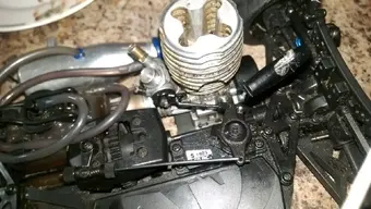

Okay, so I never said anything about cheap batteries I simply said old I will replace them with new ones. If I take a picture of my throttle and brake linkage could someone tell me if I'm missing a throttle return Spring? Thanks so much for all of your help guys!!!
Here's the throttle and brake linkage..
Basically I want to do everything possible to correct this problem before I try to drive it again. It's broke twice from this issue and I don't want to do trial and error testing and permanently destroy it. So what would the community recommend for me? Thanks in advance!!! It's all truly appreciated.

I would swap out the stock servo for something newer/stronger. I would also add a fail-safe as Rolex suggested if you're not running a 2.4 GHz radio system as well as a good NiMH rechargeable receiver (RX) pack over Alkaline batteries.

Rechargeable pack and a throttle servo are a good upgrade then. I prefer a good-sized/powerful servo for both steering and braking/throttle. On my buggy, I used a pair of HiTec HS-6545MG servos I also used a 1400 mAH NiMH pack.
I'd run a failsafe regardless of what frequency you're using for control. As saturated as the 2.4 spectrum is these days, and at the speeds touring cars car reach, one momentary RX blackout can be expensive. Or you could have an issue like I had when I raced touring cars, had a battery wire get rubbed in two, lost control and hit a curb head on at about 50mph or so, cost me about $100 to fix it.
Alright. So a failsafe, servo upgrade for throttle/brake linkage, and rechargeable pack for my reciever rather then alkaline would be beneficial?? And once again would a THROTTLE RETURN SPRING be important? I do not have any springs around my carb or servo... So I'm assuming my car did not come stock with one. Or it was lost while wrecking. Thanks for all the information guys it really helps!!!
A throttle-return spring is a necessity, IMO. If you suddenly lose power, it will help return the car to idle.

A throttle return spring is necessary, yes. Keep us posted- and give it a good clean well you're at it :)

Did you buy this car new? Most of them come with a return spring from the factory.
No I bought my car used but when I visited the manufacturers website it shows pictures of the car brand new with no return spring. Also, when I turn on the transmitter and receiver the throttle opens and closes fine. The brake linkage and throttle linkage operate fine. But when the engine is started and it accelerates it basically becomes conscious. Lol.
