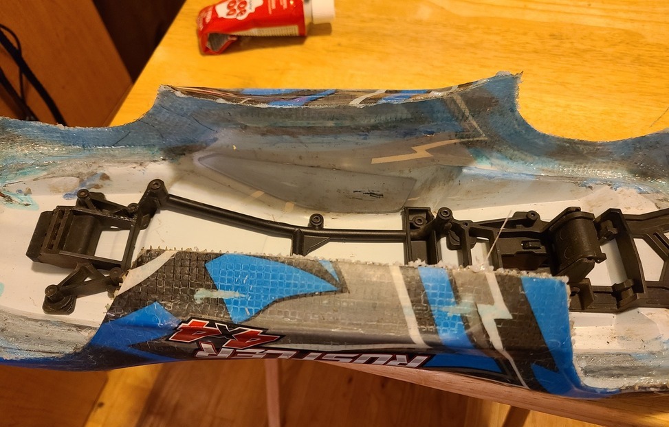

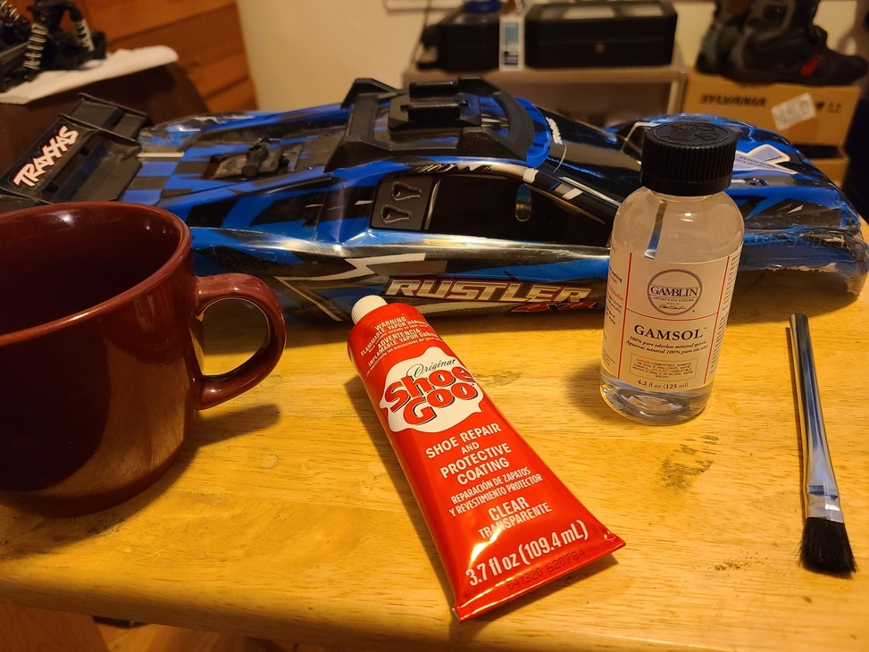

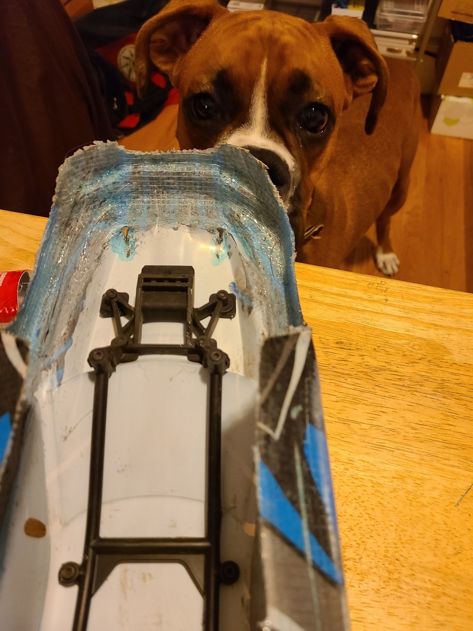

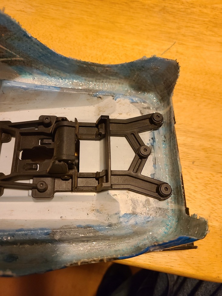

Did some reinforcement on the lower half of the rustler body. The shoe goo was a little too thick for my taste so i tried thinning it with mineral spirits. The mineral spirits didn't do squat to thin the goo, just made a gooey mess. Next i tried thinning the goo with some acetone, acetone didn't work much better, the goo mostly just coagulated into clumps. I was able to complete the task with the goop soup i created, just wasn't as smooth or light as i was wanting. Next time i'm going to thin some silicone caulking and give that a try. Also acetone and plastic doesn't play well together, it curled up the body a bit... :hehe:
Did it just eat the paint, or did the mesh texturize the surface with the acetone?
The latter, didn't harm the paint. The blue smearing on the inside of the body is blue ink from a highlighter marker...

Shoe Goo can be thinned with toluene or xylene, but be careful using either of these. They are both pretty bad chit to play around with. Shoe Goo has Toluene in it also, so don't breath it too much when using it. Especially if you live in California.
