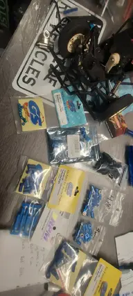

I have already switched out the turnbuckles for Schumacher ones. I was just thinking the metal horn in the link you sent looks as if the two holes at the front are too close together to get 2 ball posts next to each other
This is my little project so far
Nicely done sir.. Personally I would probably go with the one from Tamiya then selves.. its the closest to what you already have.. and the horn or any of the links were just references.. just showing you that they made the high torque savers for the Tamiya's.. sorry should have been more clear about that.. would definitely want a squared of servo horn instead of arm.. they also have round circles horns for tighter spaces..
