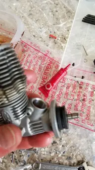

Hi guys. I finally got around to taking the engine out and soaking in DNA. Placed a few drops of Marvel oil in all areas and put back together. Attached pull start and backed off slightly after tightening. Still cannot get a recoil with engine mounted and glow plug in. Any ideas? At this point I am thinking to just buy a 3.3 to drop in

If the engine is spinning freely and you have good compression, I doubt it's the engine that's causing the problem.
I know my dynamite .28 did that for a little while when it was new. It would only recoil a small amount but it was enough for it to turn it over once. I would pull it lightly a couple times until it fired and it would recoil then. After awhile it stopped doing that.
I think the problem was the pull start plate and shaft needs cleaning. Once you pull it enough, the gum get loose. Whenever I get a used engine, there are steps I used to follow, before I even try to start it. Sometimes on an old pull starter, the spring will need cleaning too, the can get gummed up as well, but since you have a new one, that would not be the issue.
The cord itself also gets gummy. I have some old ones in a drawer that won't retract and the cord is just soaked with old oil. If I take them apart, clean the clock spring, housing and soak the cord in DA, then drag it through a pinched paper towel a few times, they usually come back to life. In most cases, easier just to throw away the old cord and get a new one.
