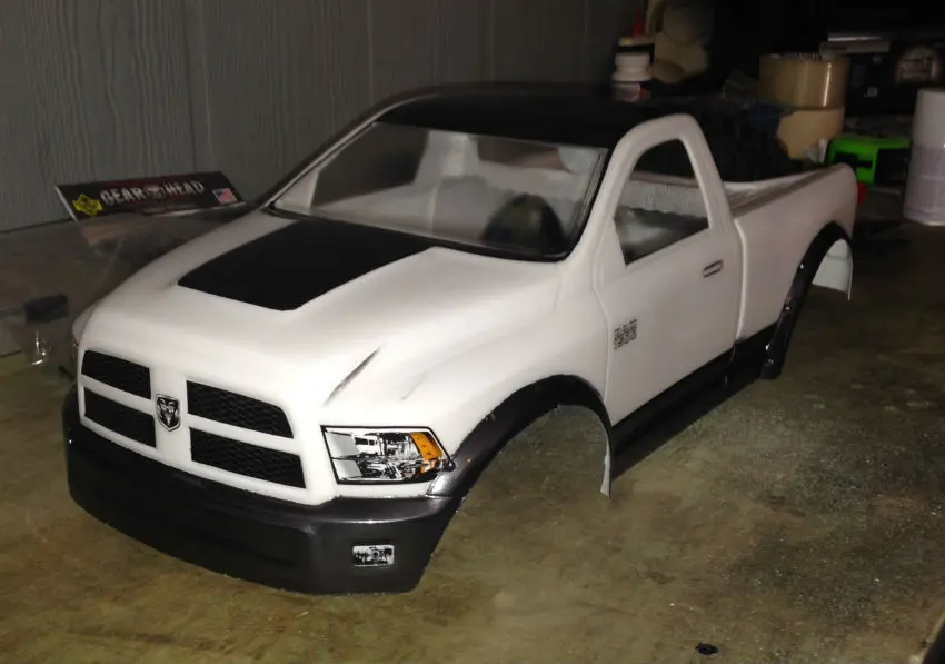

Got my body all trimmed and ready for paint. Now I need to decide what color to paint it.
Colors I have currently
Duratrax Metallic Blue.
Tamiya PS-1 White
rb2_zpsa6843820-jpg.86525
Pactra Outlaw Black
And partial cans of
Pactra Fluorescent green
Pactra Rally Green
1009449d1356717086-u-s-vintage-trans-am-%5Bpics-paint-discussion-only-%5D-img_20111202_171523-medium-.jpg
The Fluorescent green and the Rally green were no good and I did my best to salvage the paint job.
I kind of like it.
The sticker for the drivers side got a bunch of air bubbles in it, and no matter what I did they would not come out :/
