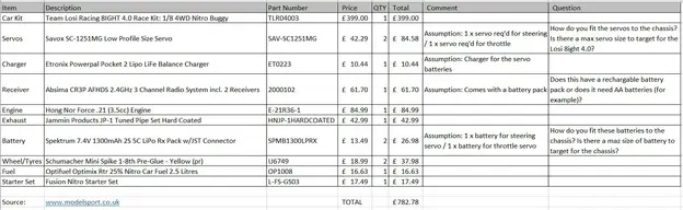

Hi folks,
I'm looking for a second opinion. Here's my shopping (or "wish") list for my new RC build.
I've been checking this so far every step of the way with Modelsport.co.uk and they've just been great … I really can't speak highly enough of them.
I'm staging the purchasing of the parts thinking about my wallet but what I'm looking for a second opinion on is what parts I'm looking to buy. I've made some assumptions and I've got some questions still so I'm just looking to continue building my understand before I get assembling the car.
My plan is to obtain all parts needed for build by beginning of July. Assemble the car in July / August and be ready to run in August.
I'm not looking to race … just to have built a solid car that'll last me.
Your opinions, assumption validations and answers to questions would all be gratefully appreciated.
FYI - this is why I love forums.
Sadly I won't be able to offer any advice back until I feel a bit more confident.
Thanks
Rich

i like how you have your list layed out with questions like that makes it really easy to check out!
on the servos, are you sure that a low profile is required i think they are standardized servos (id just double check that.) ? there is typically a standard size unless its for a small 1/16 and smaller, and on the flipside typically is a large scale for 1/5 and bigger. i would suggest at least 150oz/in torque servo rating in right around .10-.16 sec.
metal geared is always better. they arent digital but the arrma 1/8 scale ones may be good to look into, waterproof, .14-.16 speeds.
that receiver combo, i have not heard of that brand before so i can't comment on that but they are typically AA's that go into them. 2.4ghz usually takes 4.
i know alot of people really like that JP-1 pipe. good mid to low end pipe.
you are only going to need one receiver pack, the pack plugs into the rc's receiver then the receiver diverts power to servos and itself for the receiver needs. (extra pack wouldnt be a bad idea anyways though. ) should be able to just google a battery pack for that vehicle and go from there. I'm old school-ish and am used to either a 5 cell nimh/nicd hump or flat packs for receivers. so as far as post lipo scene releases i dont know.
hope any of this helps.

the .14 and .16 is how many seconds it takes the servos to achieve (if i remember correctly) 60 deg rotation.
+10 to the research sheet, it is very helpful especially when just starting out, once you get more familiar with the truck and rcing in general it will become second nature but getting there takes awhile. also would be a good idea to have a setup sheet for suspension tuning and engine tuning including temperatures out that day, if it is really humid etc, as those factors will change the tuning of the engine, so you can fall back to that if the need arises.
there is so much information to be had when it comes to rc's, I've been learning new things constantly.
as far as metric/SAE, id check replacement parts on hobby stores websites like A-Main, and look at the screws it has listed. if most of them are metric that pop up for replacement parts, its probably going to generally metric, vice versa for SAE.
on the note of tools, good tools (hex drivers primarily) will make your life so much easier, dynamite tools are awesome and highly recommended from my LHS.
Personally, I'd steer clear of arrma servos. I'd also go with something 200oz-in+.
If you can fit a standard, the savox 1210SG is a decent servo for the money. Waterproof as well.
Speed @6.0V: .15 sec/60
Speed @7.4V: .13 sec/60
Torque @6.0V: 277.7 oz-in (20.0kg)
Torque @7.4V: 444.4 oz-in (32.0kg)
That has been getting used a lot on the arrma forum in all their 1/8th trucks. I have one in my outcast, only on 6V and it's a brute of a servo.
