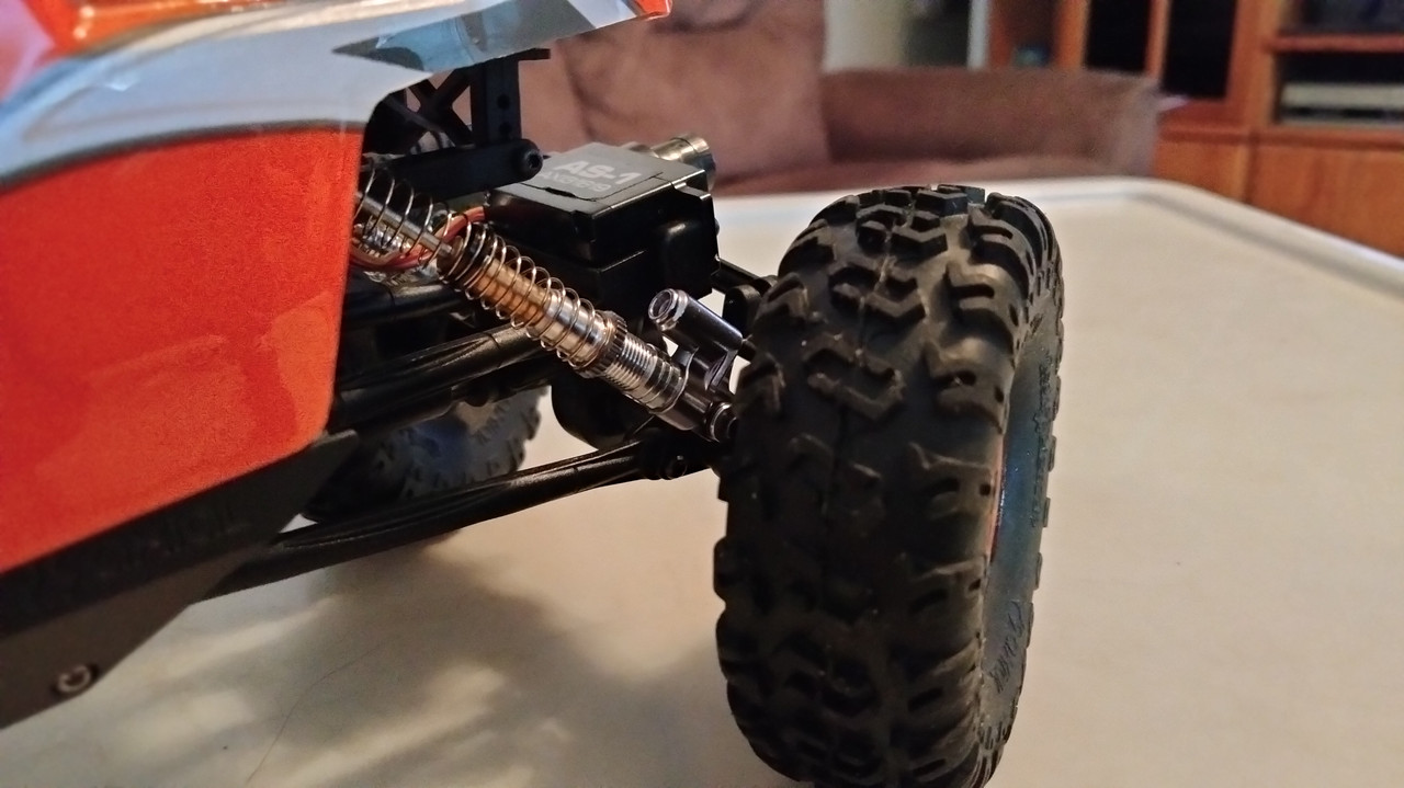

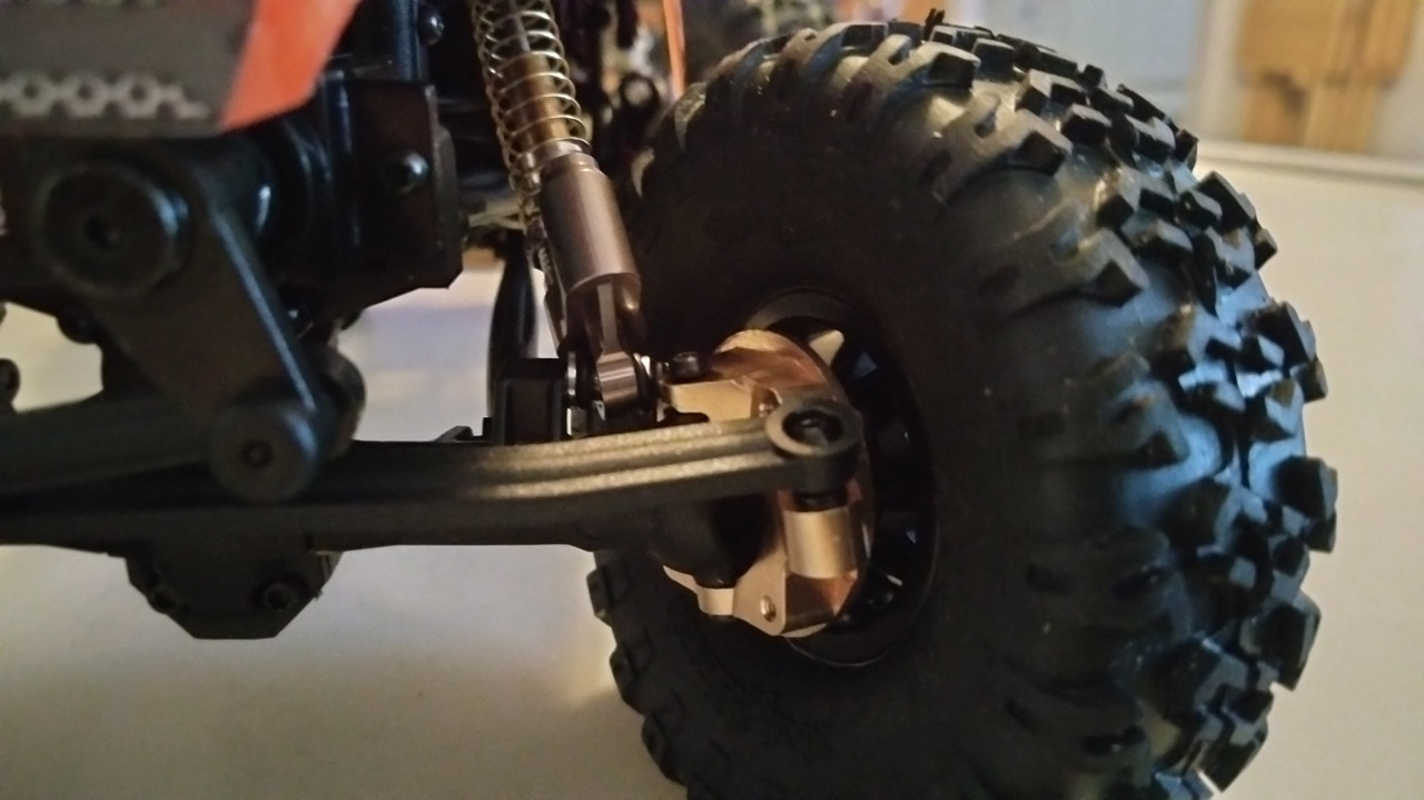

First up were brass knuckles and the bolt-on weights from Axial. Gotta' help with climbs and backflipping so easily. I threw in a 14% o.d. while the axle was disassembled also.
Didn't help a lot, it just hit harder when it backflipped!

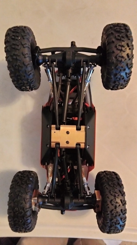

Oops, forgot - I also picked up the Spektrum brushless combo (don't) and a brass skid on clearance too!
Thought it would help more weight low. Brushless power and weight made it LEAP over backwards and SLAM instead of just flop! That's when the wheelbase thought came.

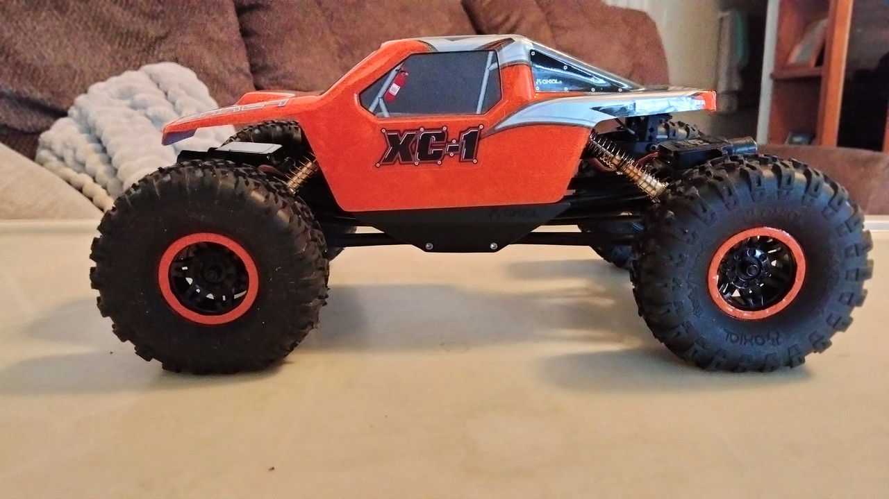

So I dug out the stock rear arms from my Deadbolt, it was about right to add +/- 10mm. Bought the Axial bag o' driveshaft parts 'cuz I couldn't come up with the right combo.
The problem? Didn't think about shock length - sat too low in the back to crawl over much of anything. Stock shocks are 51mm, so to lower the front a bit I chose 48mm and to raise the rear used 54mm.
Came out just right.

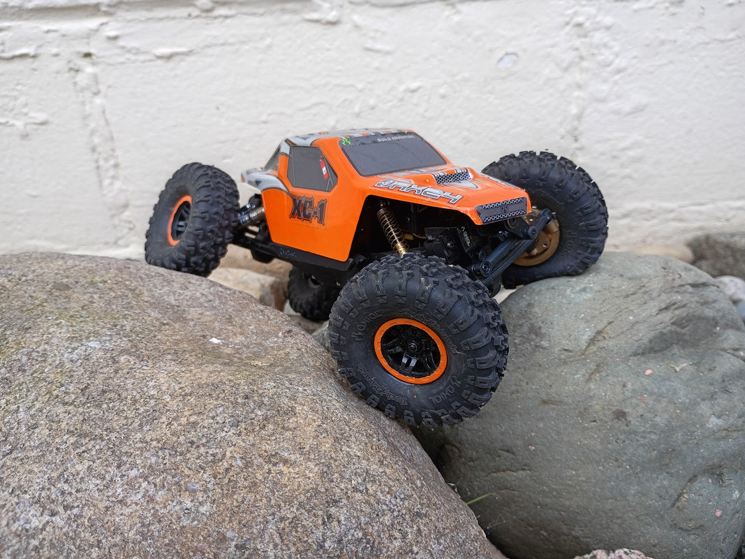

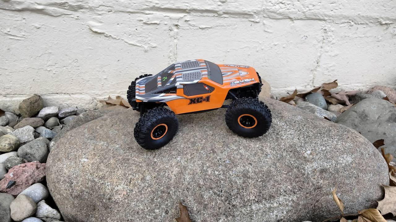

This thing's far more capable and fun now, cured all that ails it out of the box.

Oops! Forgot the "budget" part... close, but over a bit. Was shooting to not exceed the $159 MSRP.
So, $99 for the car, Knuckles and weights were clearance priced at like $27 for all, couldn't resist the $30 sale brushless kit (that wasn't worth it!), $20 for brass skid. Shocks were the kicker, had to buy 2 sets for my mismatched lengths, but oh well, I've spent $40 on dumber stuff and I still have $20 worth of shocks for something! 🤣
