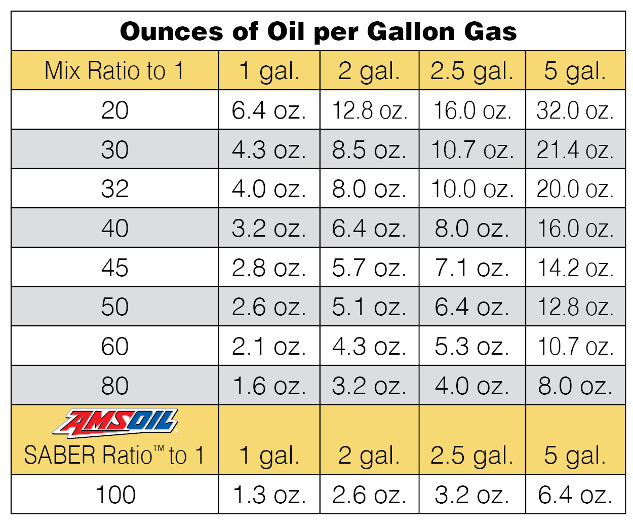

- What is the best premix ratio to use *for this engine*? (This is the 30.5cc.) I read everything from 25:1 to 50:1.
I believe Rovan specifies 25:1
I was looking for real-world data points. I know what the manual says. And I have a great deal of experience with premix-using two-stroke gasoline engines in general - I raced motocross for ten years (before those horrid 4-strokes were mandated) and later in life flew full-scale light-sport aircraft with Rotax engines (503 and 582).
I want to know the ideal gas:oil ratio for these engines in particular. I suspect that 25:1 is not necessary - that is a LOT of oil and I've never run a ratio so high on any engine I can think of. 40:1 is more common.
I think I'll start with 32:1 and see how it goes. I don't want fouled plugs.
I don't know why the ratio is so high myself either. I don't have a zenoah rc but like you have experience with 2-stroke engines. In the past I ran the richer oil ratios in my small engine weed wacker/chainsaws/outboards up to my bigger sled engines and had that build up of carbon. With today's better quality oils (I use Amsoil synthetic) I don't get that carbon build up. But I do run leaner oil ratios in addition to the better synthetic oil. I also run high octane ethanol free gasoline.
I know the manual calls for 25:1. I've also read where others have run 32:1 (or even 40:1) without any issues. I might run the heavier mix for the first gallon for break-in then switch. Just be sure to retune when changing ratios.
I got two of those cans ,they are pretty cool!
32 to 1 is the most common mix for all these low budget engines an a safe mix ,itis 4 oz's per Gal.!
When I ran my gardening equipment I shaved the oil back to 3 1/2 oz's because the oil would cake
up at the exhaust port & clog the spark restrictors in the muffler can ,but I remove all of the spark
resisters out of my equipment do to the 32 to 1 was just a little too much oil ,but that ratio is safe
for break-ins ,40 to 1 was about right for gardening equipment but I would feel safer at 32 to 1
for RC engines!
