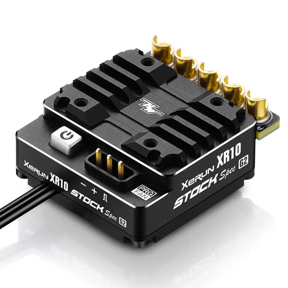

First, the Flysky Noble started squawking about low voltage. I thought it was the TX voltage. Put it on the charger and 3 hrs later, the TX voltage never went above 4.2V. I was scratching my head about that and figured out
it was complaining about the RX voltage. Somehow, Disney magic or Gandalf wizardry, the Flysky Noble talks with the Hobbywing ESC and knows the voltage. I haven't figured that one out yet. But I learned something.
Also I set the cut off voltage on the ESC, which caused the problem. I set it to 3.7V, which
I thought was like a normal ESC and 3.7V per cell, but it's
3.7V total. I ended up running my battery down to ~6V (2S). Crap. That was close, hopefully I didn't damage the battery. It charged up to 3.7V pretty quickly and is holding steady. I do number my batteries so I know which one it is.
