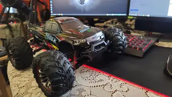

Any opinions on this 4wd truck does 50mph 1/10 scale, looking to race with it?

Racing a monster truck is hard, but possible, you would need to lower the center of gravity somehow. I recommend getting a 1/10 or 1/8 truggy/buggy to race with instead. Also, it doesn't really look like a 1/10 scale from the pictures, more like a 1/14 or 1/12 scale.
You also need to find a monster truck class at a track which would be pretty hard unless you're just doing it for fun during practice time.

Monster Truck racing tends toward to solid axle rigs. Swing-arm A-frame suspension MT's get sort of left out.
Looking at Trigger King RC Monster Truck Series, they list six classes. Four of them are solid axle only. Of the two remaining, one is Losi LMT [axle] only. The other is Trophy Truck [Short Course].
JConcepts has sponsored one or two wildcat events days past. Minnesota, I think they were. Now it seems their events link to the Trigger King Series.
Like pug says, you'll have ask about and look about for a series or class for your MT. Good luck. Hope this helps. Cheers. 'AC'

Do you have the model # or manufacturer name?
I ask because that truck looks very similar to a Spirit Vatos. My son has one of these and it is a fun truck and decently made for the price. It isn't a full 1:10 scale vehicle. It also isn't gonna be a good platform to build a race MT.
Have fun with it and learn how to repair and maintain it. Then take that knowledge and start looking for a race platform that your local track has competitions for.

Welcome sorry but I would say get a short course truck. You will have better luck finding races. MT really aren't big on racing...

I've seen that car before, it's closer to a 1/12 scale than a 1/10 scale.

By race, do you mean like racing with friends and stuff, or actual, competition racing, with a proper track, timer, everything? If you mean the latter, than you might not have super good luck, as 1/10 scale MT racing isn't as popular as like 1/10 and 1/8 buggy and truggy classes. Welcome to the forum! Also, do you need any help indentifing the truck?
That isnt a true hobby grade truck, and parts arent really available to make it into anything you could race with, unfortunately. For those who may be wondering, it is this truck: https://www.amazon.com/FMT-Control-Controlled-Off-Road-Assorted/dp/B07MV54BXL Its dual motor, has a circuit board instead of an ESC, and almost every part on it is plastic, including the diffs.
Lot of reports for the shocks breaking and being the size of a 1/12 scale. Good price though.
It says it has a partially metal driveline, and 60a "ESC"? And it has some other metal parts, including metal A-arms? Interesting choices...at the end of the day, ESCs are Electronic Speed Controls, which means that inside the case, they are circuit boards too. I get what you mean though. Interesting how in the rear, it has 2 shocks per wheel, older nitro style, but in the front, only one shock per wheel.

Monster trucks (with all the respect...) are just not able to follow the pace on race track; too short wheelbase, too much roll over, too much bouncing...
All those guys on the pictures have switch to Truggy 1/18...
But MT are a pretty good start for air control.

Yeah, from videos I've seen, MTs don't handle/corner as well as buggies or truggies obviously, and they roll and flip too much like you said. Just not stable enough, all though, if the objective of the race is to pull max wheelies, stunts, backlips, flips, ect. then an MT is your best bet! However, you may not need to go out and buy a buggy or truggy, you *could* in some cases, convert your MT to a truggy, by lowering the suspension/ride height a little, maybe fitting some sway bars, getting a truggy body, and sutible race tires.
