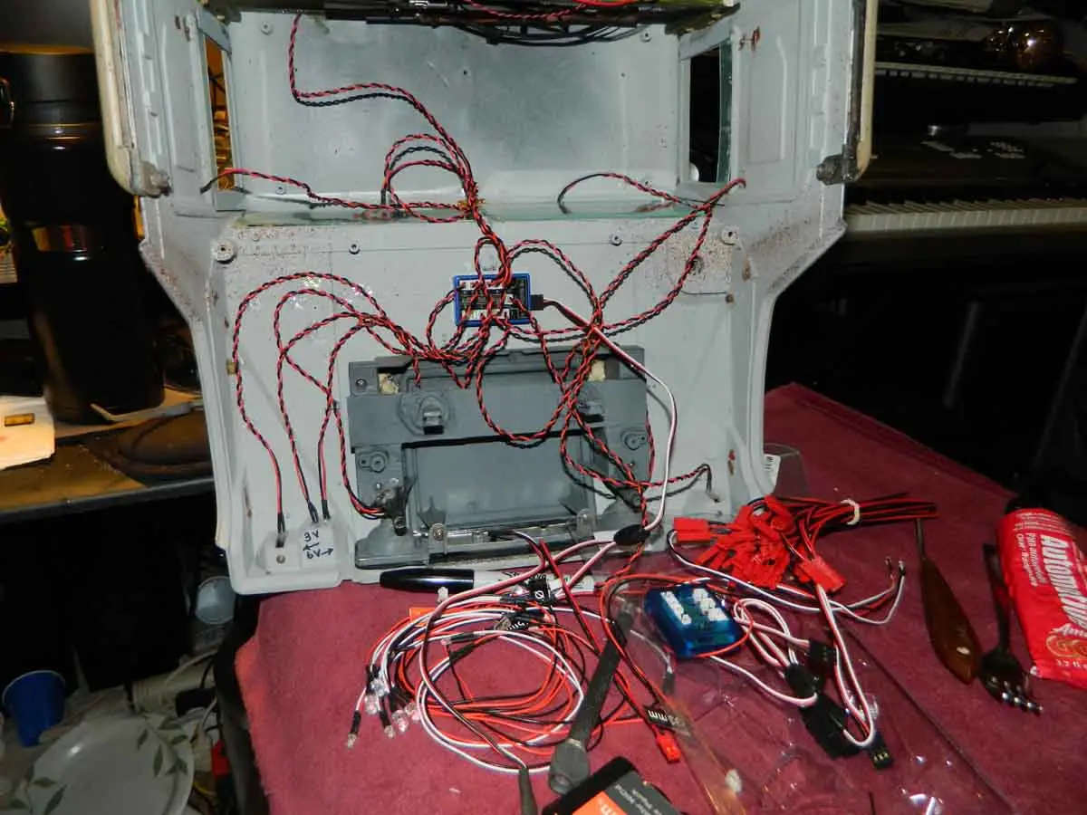

Hi guys,
Some may know that I purchased this toy truck. I want to add some headlights to it. It already has two flashing red and blue lights on top of the air filters, (Real stupid, IMO), and was wondering if their circuit could be used for white lights? Can I 'cut and paste' (Solder) the leads to the board? Does the board have the flashing circuitry on it or is it the lights themselves?
AND, I need two really small LED lights. Anyone got a link to small LED headlights?

Red and blue flashing lights on the air cleaners? Obviously it's a police pursuit truck.
I get LED lights for every project I build through ebay. LOTS of choices in the same place. You can get flashing LEDs, but when you are using the "Toy grade" circuit you have in that truck, the flashing might be the only option. You can get a separate battery and light controller and hide it somewhere in the truck and you'll have many options to power lights and control what they do.
