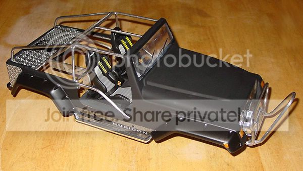

Yes you can paint the outside. I have done several flat paintjobs. Krylon ultra flat paint adheres great to lexan bodies, and does not chip off, plus if it does get scratched, just remask the windows and shoot a fresh coat on it and it will look like new.
This one was done with Krylon Camo Ultra Flat Olive Drab.
And this one with Krylon Ultra Flat Black...
I have done several over the years, a hummer for my Maxx, where the body was destroyed and none of the paint had chipped off. I have done buggies, Jeeps, and a few others, they have all held up great. Plus I really like the look of the flat black, it just looks tough.
