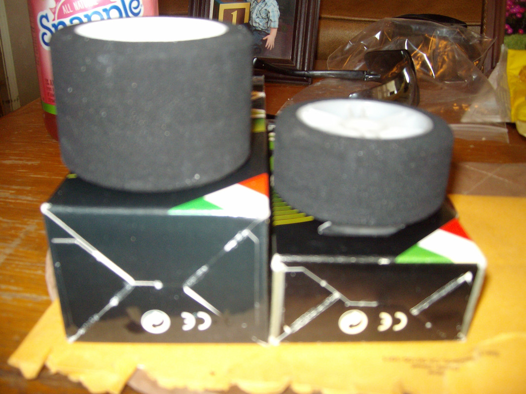

I seen your post ,but I will need to measure them ,I can't remember what the wide ones were ,but they are 1/10
an have the size 12 mm hex!

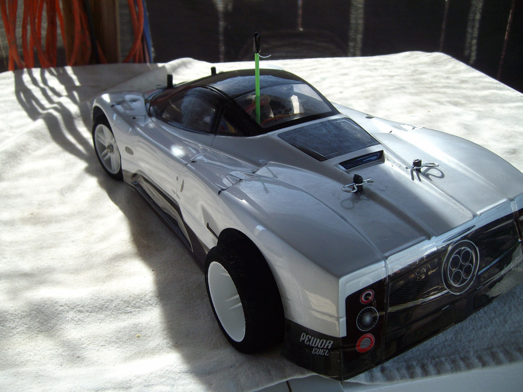

Here is the pic difference from a normal sized fronts which is about 26 mm ,the rears may have been 50mm!
Also ,here you can see how much they stick out from my Zonda body ,it don't look good ,but if they were tucked
in the wells ,they would!
The front ones look perfect. My tires are 4" tall and 1.75" wide. Have you thought about cutting your front body posts shorter and painting silver to blend in?

The wide tires ,I measured at , 2 1/2'' tall an 1 3/4 wide.
If they are not tall enough ,then you might can try the 1/8 scale ,they may give you more height ,but
the wheel hex maybe different size!

Oh ,well the tires I showed are for high end racing ,they are the only ones that I could find for the width as
I was trying to tame the car from going to full donut stage on take offs ,still didnt work ,it has way too much
power ,rendering that car as a shelf peice!
But ,those tires do come in many widths I beleive ,an you might can check them out ,they are a solid foam style!... :cool:
