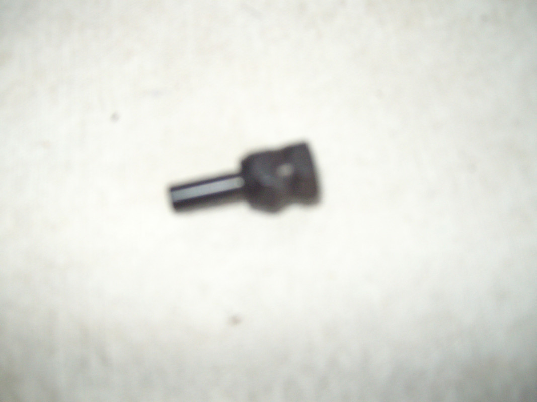

Sometimes crank shafts are cut ,an a clutch nut adapters are installed ,here what they look like!

All you may need for the TRX15 pro would be a clutch adapter nut. If you posted photo's of what you have, that would help us focus in on something for you. Take the engine out, take the clutch bell/flywheel off and post up a photo.
