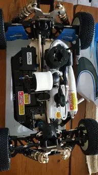

Picked it up after work! Going to start reading the manuals so I can break it in this weekend

When you start running the buggy on the ground ,make sure you keep tabs on the wheel nuts & motor
mount screws ,make sure that they are tight.Also do a check on the cylinder head screws as you break it
in ,they work loose sometimes.
Your first start up ,its easier on the starter if you loosen up the glo plug alittle before you start it ,it will be
much easier ,an once started ,take glo igniter off while running an tighten it back up.
Do that each start up while breaking it in ,it helps relieve some of the compression ,like a compression
relief.
Also find the bottom dead center of the piston ,meaning piston down out of the cylinder ,mark the flywheel,
You should always run the piston down after running it when cooling off.
This will prolong the life of the engines pinch& compression.
Great news, got the car broke in today! Car started within 2 pulls everytime! Thanks for all the help!
Car is built really well and assembled very well, everything metal on metal had loctite, the only thing is the front end alignment one wheel is toed out more than the other and even using trim buttons it either pulls one or the other. Other than that small issue couldn't be happier with an intro level buggy to get me started
