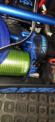

Learned new paint trick from a auto body tech buddy. Can use some
Self Etching primer. Clean with some alcohol. Then prime 2-3 coats. A little sanding 220grt. And above. And then just paint any color you what. Then clear coat. Works wonders..I change the red kra8 motor mount to BLUE of course 😉haha..

Your motor mount looks great.

Seems like you love the colour blue?
It's not just blue. It is a specific shade of blue that everything has to be. Gotta love the commitment! But his Kraton looks absolutely sick!
