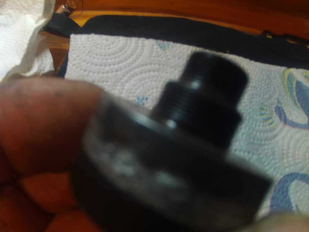

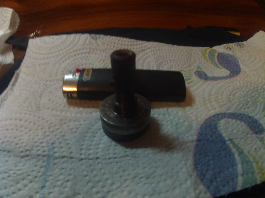

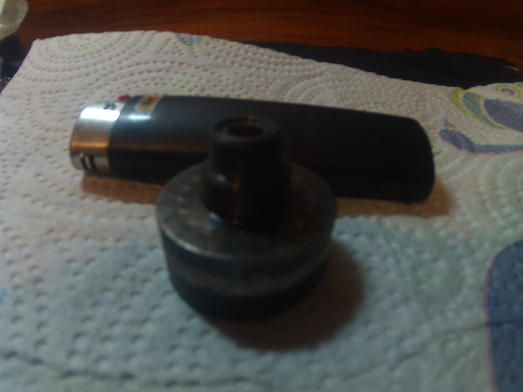

I might can show pics of a threaded bell ,if the coupler will fit inside of the threads with out
a gear screwed on ,the coupler could be pinned in!..🤔
Pics of a threaded clutch bell ,be aware that there is 2 bearings inside in which the
front one is close to the edge!
If these pics help ,one might can make one work ,even having some aluminum
round stock drilled to slide over the threads for your coupler ,I should have took
a pic of the round bar aluminum stock as I got that too ,coupler that I showed wont
work do to the bearing ,one would have to make one out of aluminum to slide over
the threads of the bell!
