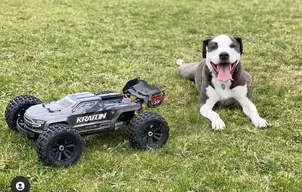

This is my first post here. I haven't had an rc car since the t maxx 3.3 came out(15 years ago ?). So its been a while.
I did some research I thought this set up would put the biggest smile on my face.
Kraton EXB
Castle mamba monster 8s
Castle 1717 1650kv
B-link(this is sweet!)
RR 20t pinion
AGFrc 32KG
Dumbo controller
M2C rear shock tower brace
RPM mud guards
ZEEE 5200 80c battery
SMC battery on the way
I when got my exb I went through all the diffs. They all where pretty much filled with fluid. And it had lsd plates in the rear. I added some shims (LOSA3501) under the outdrive retaining pins, that fixed the small amount of play they had. The ring and pinion was nice and tight with no play side to side at the pumpkin(it had on shim from the factory on the ring side).
Front 30k min lsd setting
Center 200k
Rear 20k min lsd setting
I took it for it's first drive(two battery's). Man is this thing fast for a guy that hasn't touched an RC car in 15 years. Everything went well! I didn't even break anything! My motor temps got around 165. I've got a k8s heatsink with two 30mm fans on the way.
