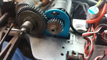

so i got a traxxas 50t 32p and hit all the screw holes with thr dremmel. made a bushing for the middle to fit on the losi shaft and it works perfect. centered and gear mesh good
Hi, I'm also looking for spur gears for my XXXNT. Would you mind posting pics of the modifications you did to the Traxas spur so that I may do the same? Thanks =D
the bushing is a plastic i had in my parts box that fit center hole of the traxxas spur. i had to press fit it in and press fit the diff shaft its super tight and works great.
here is pic
I used the spur from a trx4 and also a associated gt2. I drilled out the center and used a bearing to keep it centered. I also had to turn down the diameter of the slipper plates to work.. but at least now I have a supply of spur gears.
