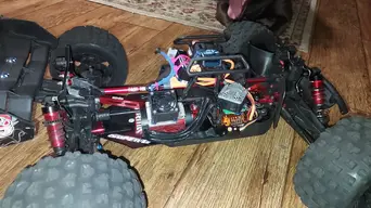

Can't wait to drop this in.

You will love it. Just make sure your diffs are shimmed perfect or it will eat them up. I run the max 6 5687 combo in mine and it is a animal
Man that thing has got some power I got a 18 tooth pinion on it, 18/50.. going to go with,, 20 or 23/50,, I think that'll wake it up enough without overheating definitely worth the $300 for the combo though I really didn't like how I just squeezed the ESC in there but it works
Careful with that esc grill. It looks cool but restricts a lot of air flow. It definitely going be be a blast for you. Looking forward to those running videos
With the size and RPM speed of that fan I dont think airflow is going to be an issue :)
Definitely will be shooting some soon. And u r definitely rt it dose cause everything gets stuck on top of that cover, got another one for it that's open.
The 20 woke this thing up going to try a 23 t see what it does
That's going to be obnoxiously fast lol
Dude it is I put a 20t pinion on it and man it woke that car up now I'm going to try 23 tooth and see what it does and watch my temperatures but with the 20 tooth and 52 Spur I can run the whole battery pack on 6s and it stayed at like 120° the ESC and motor so I think it should be fine with the 23 tooth on it
