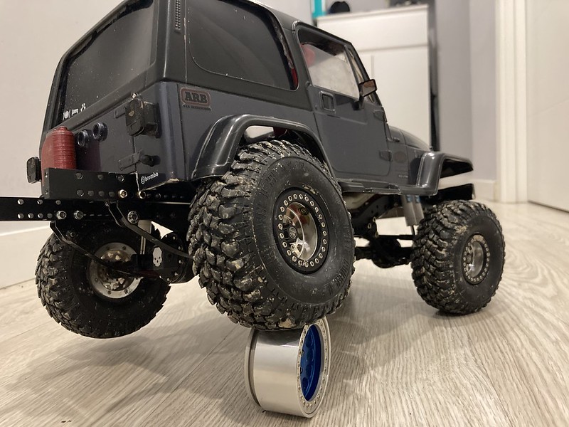

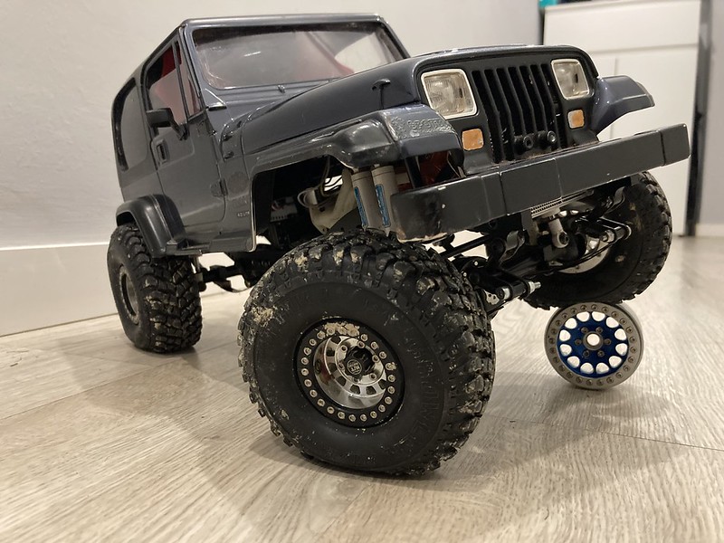

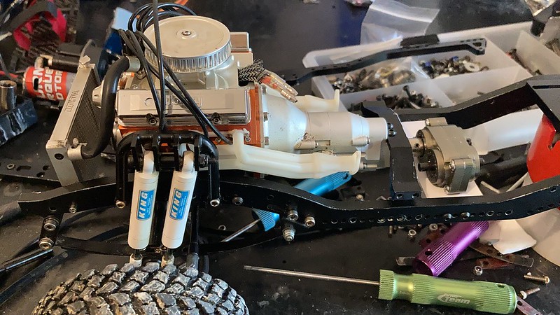

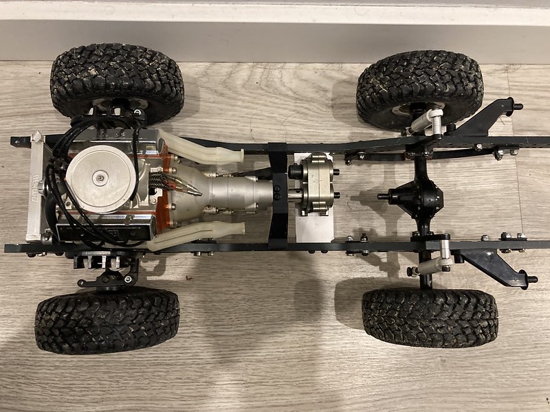

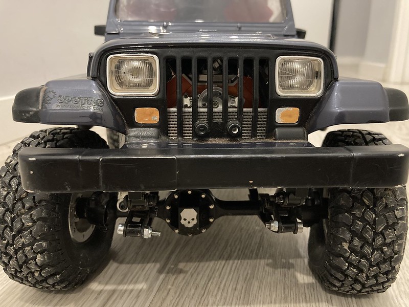

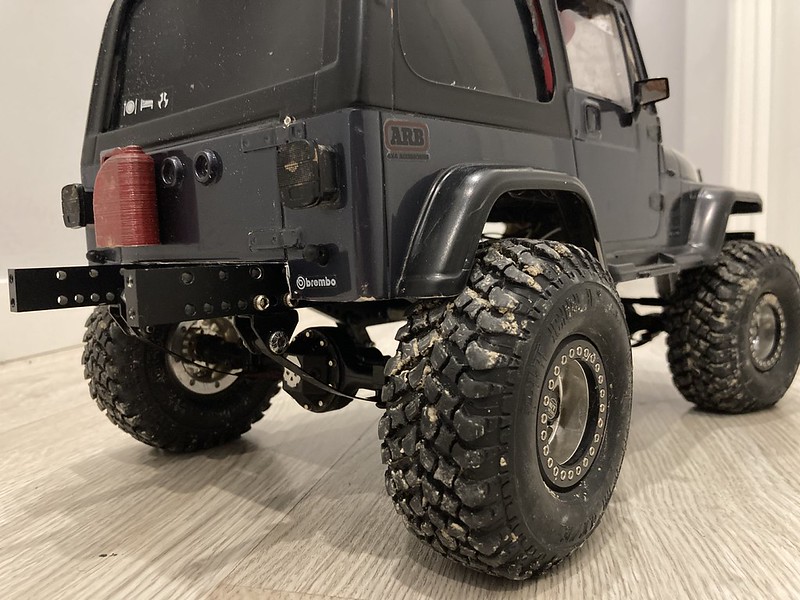

Here the "new" project, nothing is new

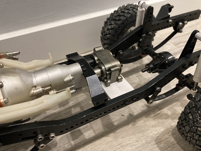

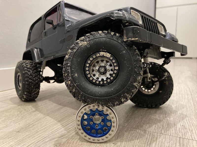

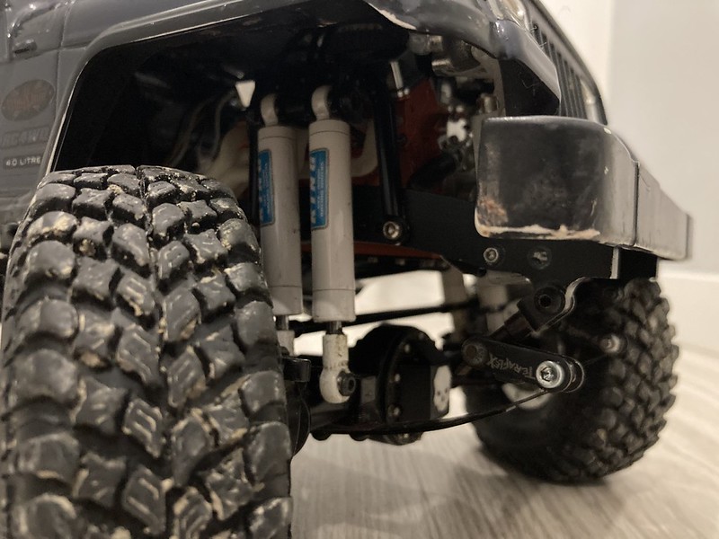

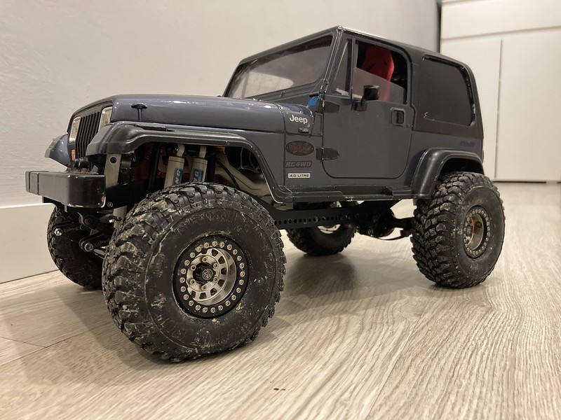

( https://www.rctalk.com/forum/threads/rc4wd-blazer-v8.127297/page-2 ) , but let's see if it fits. At the moment it is all I have done, although I will change the tranny for the original one from trailfinder2. I have changed all the mechanics of the Hilux trailfinder2 with the v8 included to a shorter chassis, which still has to be cut, but which allowed me to put crossbows shortening the battle, since the rc4wd does not work and the swb version does not sell rails separate. I have put the axles over the leaf springs so that it is lower and finally, we will see where I put the servo, but it will go with a forwarding since it does not fit forward now :ror:
At the moment it is all that I have advanced, they touch thousands of adjustments still, that fun !![/URL]
