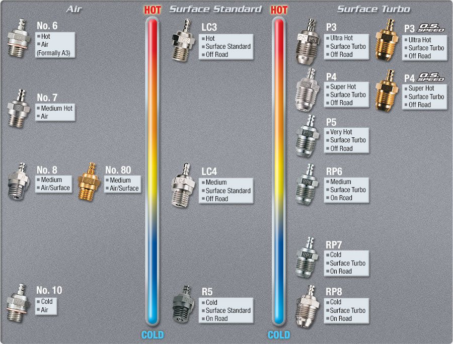

The are 2 types and different heat ranges. Regular and turbo plugs seal differently and aren't interchangeable.
Most of the time a No 8 or equivalent it the right answer. These are OS plugs. Most brands indicate which plug they are equivalent to on this chart.
